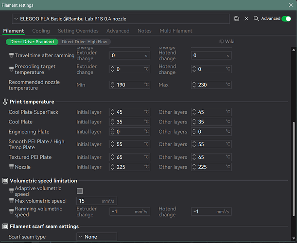

What are your temp settings for the nozzle at?
This is my setting when using elegoo PLA. Got this preset from bambu online models. The reviews is good so tried myself. Sadly no luck.

I would bump that nozzle temp. from 190 to 200. your print bed is fine.
Looks like they have it set to 225 to me.
They do, until you look at the “recommended” range. I’ve consistently found that if I keep that range at or above 200, I have fewer issue. When I get into cheaper filaments, I put it at 210/215. When I run recycled filaments I run it a 220 and am happy if it doesn’t fail due to contamination (bits of metal or desiccant in the filament body that didn’t get caught).
