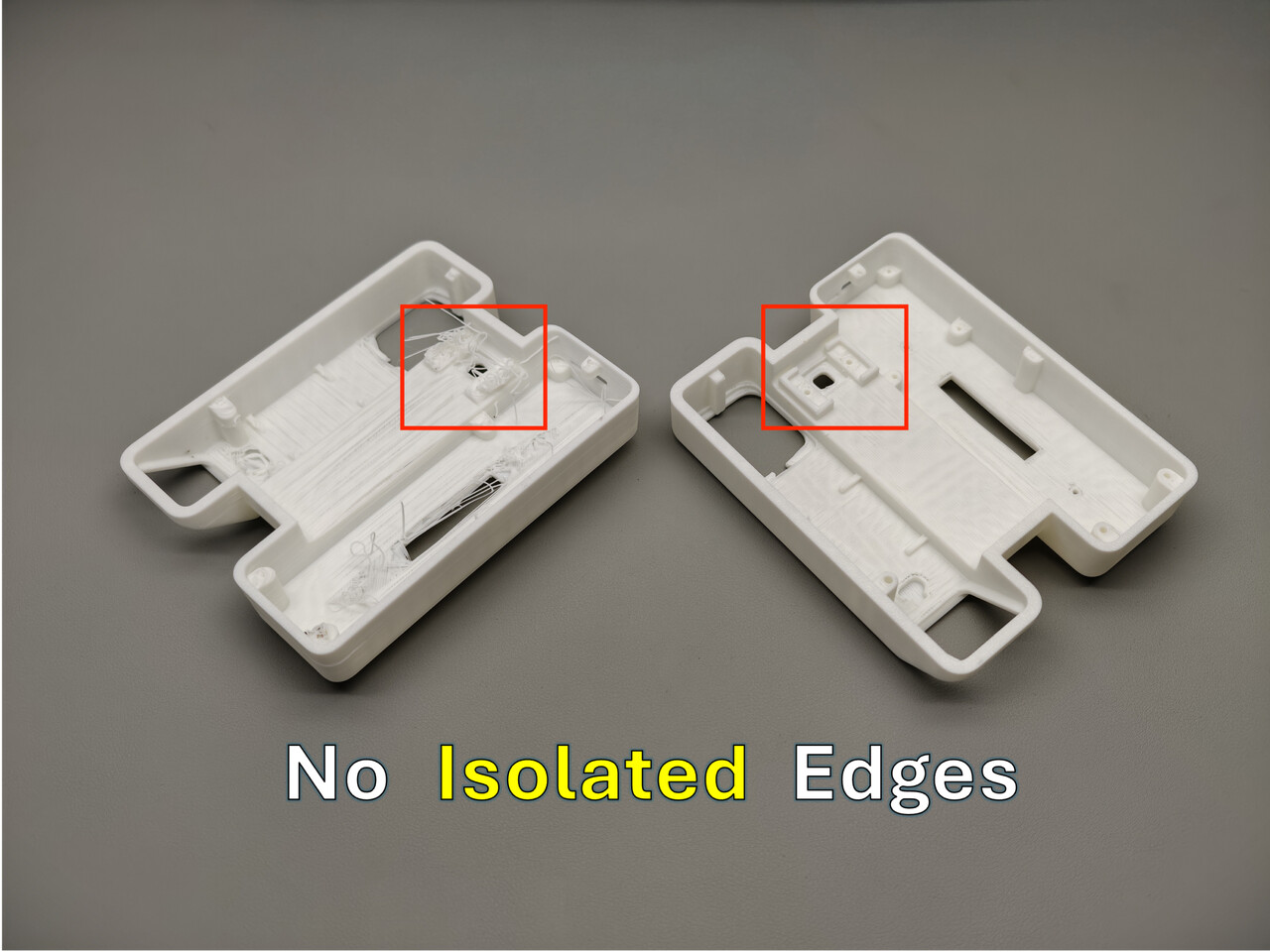

If the supportless hole is large and far from the outer wall, we suggest adding support to the hole’s wall and using bridging for better optimisation. Taking Bambu Lab’s A1 Mini Wireless Charger as an example, it has various supportless holes and long bridges on its base. You need these features to install several components. These include induction coils, lamp panels, mainboards, and buttons. By adding supports around the supportless holes, this technique provides adequate support to the toolpaths at the edges of supportless holes and long bridges. In the example below, the selected areas are face-splitted first. For unprocessed models, you may need to draw with the circle pen tool manually.
7
Compared to automatic support, this method significantly saves materials and print time while ensuring print quality. The image below shows that, compared to automatic support, adding support and using bridging saves 19.96 grams of filament and reduces printing time by 28 minutes.
The left image shows the result of adding supports and using bridging. The right image displays the effect of using automatic support. As shown in the image below, there is no noticeable difference in quality.
