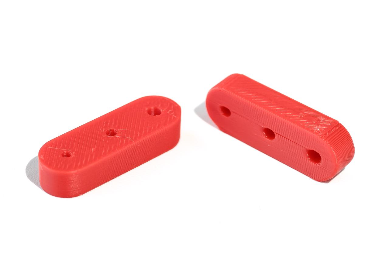

When installing screws into 3D-printed parts, you may have experienced cracked parts, long assembly time, and repeated testing. Now it’s time to say goodbye to these issues.
In 3D printing projects, screws are a common method for connecting parts. However, if the screw holes don’t match the screws, it often causes the following problems.

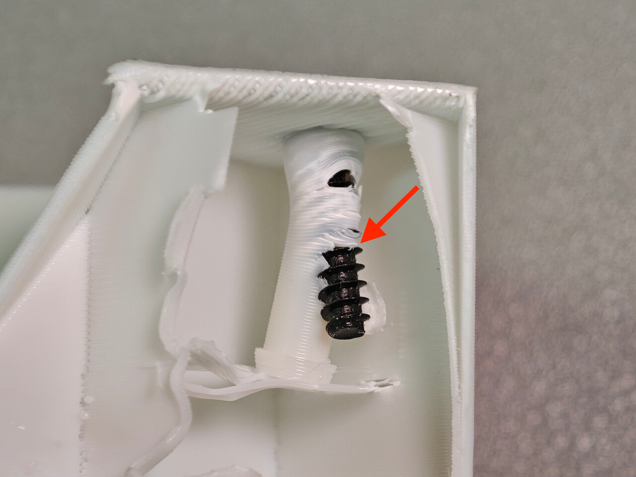

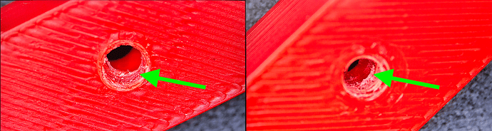

  • When screw holes are too small, it can make it hard to screw in, cause the screwdriver to slip out of the screw head, or crack the parts. This could cause installation failure.
  • When screw holes are too large, the threads formed during screwing are weak and easy to strip.
Left: The screw hole is too small. The screw won’t go in. Right: The screw hole is too large. The formed threads have been damaged and turned white.
Installing many screws or deep screws takes longer and is tiring.
How to solve these problems to make the screw and the screw hole fit perfectly?

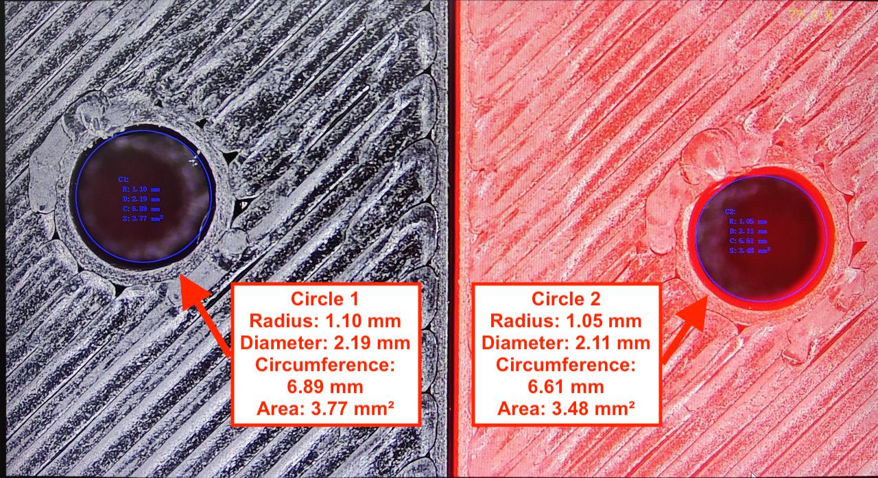

Material shrinkage
Shrinkage causes the final screw hole to be smaller than the design. The type of filament and fillers can change how much material shrinks.
Different types of filaments shrink by different amounts. For example, the shrinkage varies between PLA and PETG. Even filaments of the same kind can shrink differently depending on their color. That is because the fillers used to create the color affect shrinkage. For example, black PLA Basic filament’s shrinkage differs a lot from that of other PLA filaments (the image below).
If the material doesn’t cool completely, the liquid rope coil effect causes the holes to shrink further. With smaller holes, a decrease in diameter is more noticeable.
Left: PLA Basic Black, Circle 1. Right: PLA Red, Circle 2

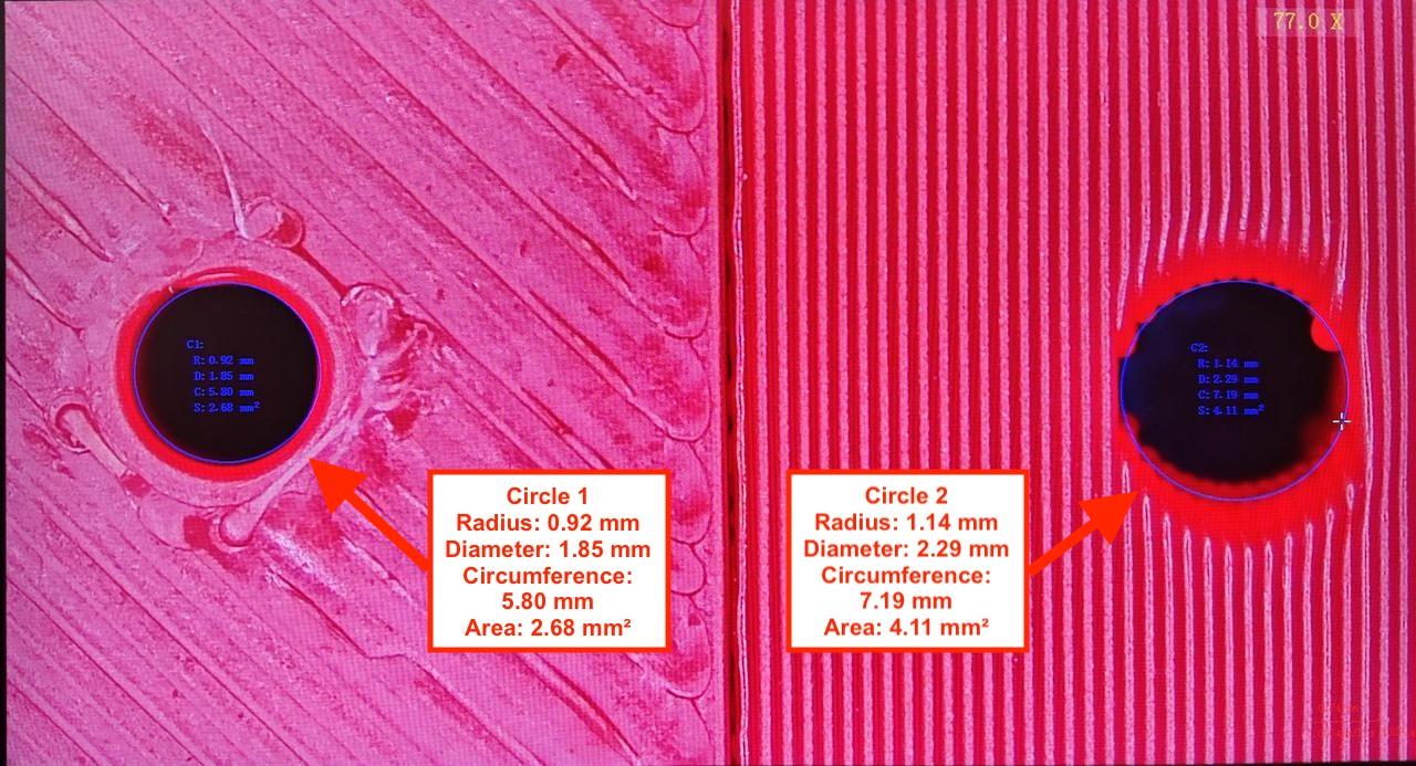

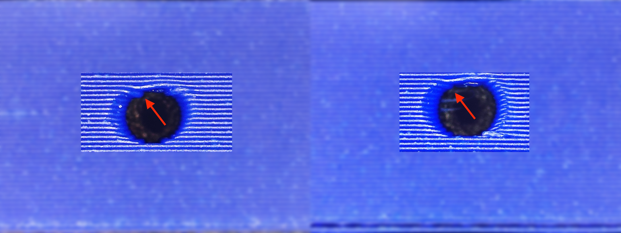

The direction the screw hole faces
Screw holes are sorted by the direction they face, either horizontal (left image) or vertical (right image). When the screw hole opening surface is parallel to the print bed, we call it a horizontal screw hole. When the screw hole opening surface is at a right angle to the print bed, we call it a vertical screw hole.
Material cooling and the seam affect the size of horizontal screw holes. The smaller the horizontal hole, the greater the liquid rope coil effect, and the nozzle drags the unsolidified filament. This leads to more shrinkage.
FDM printing is built layer by layer, so the vertical screw hole walls are not continuous between layers. Thus, horizontally, shrinkage affects the hole diameter less, making it closer to the design than in horizontal holes. Vertically, the screw hole is a bit smaller. This is caused by overhang, layer stepping, or when the printer needs to cross a gap, known as bridging.
Left: Horizontal hole. Right: Vertical hole.

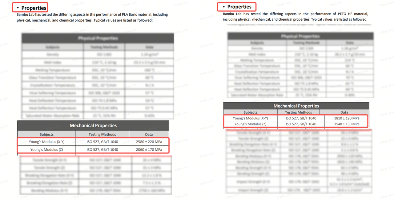

Mechanical properties of the filament
Different filaments have different hardness. PLA is relatively hard. This makes it easier to form threads when installing screws. PETG is softer and can be easily damaged when installing screws. So, when designing screw holes, we need to use different hole diameters for PLA and PETG. Usually, a slightly smaller hole diameter is suitable for soft materials to form threads. When working with hard filaments, be mindful not to overpress and crack the material when you screw it in.
The left image shows PLA Basic’s mechanical properties. The right image shows PETG HF’s. All Bambu filament specs include detailed technical data sheets. You can get the mechanical properties data from technical data sheets. Please take a look at Young’s Modulus values to find out the material’s stiffness. The larger the value, the stiffer the material is.
Source: Bambu Store, PLA Basic technical data sheet; PETG HF technical data sheet. Retrieved on Dec. 02, 2025.

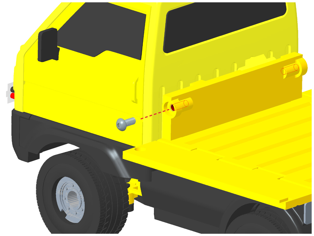

Machine screws are not designed for plastic parts. However, machine screws are widely used in printed parts. Machine screws are widely used and easy to buy.
We suggest using machine screws in the following cases:
  • When you don’t need to take the screw out often, or when you don’t need a high built-in tension to clamp parts together.
  • When you have already used machine screw nuts elsewhere in the part. Using machine screws helps reduce the number of screw types needed.

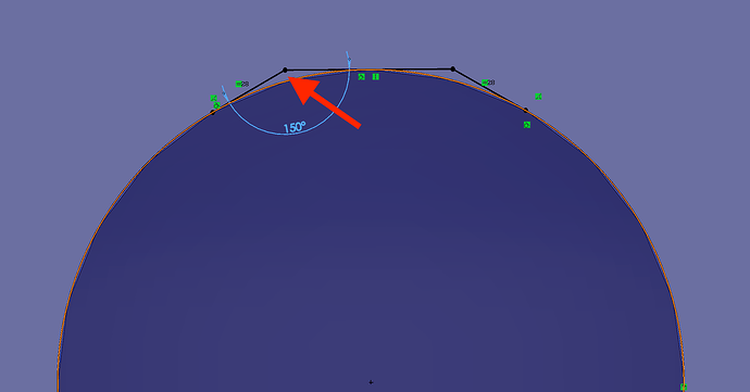

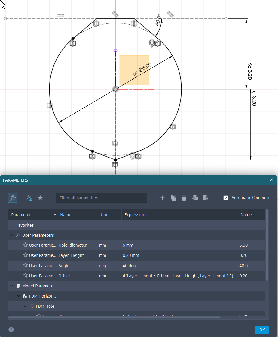

Fix the impact of overhangs on vertical holes
Please be aware that the print nozzle moves very fast. Its inertia can cause slight curves at the edges of the vertical holes. These slight curves look like small protrusions. The overhang at the top of the hole reduces its size. This makes it hard to start screwing a machine screw into vertical holes.
To avoid this issue, at the top edge of the vertical screw hole, design an angle of 20° to 30° (the image below). Trim the sagging part with this angle.
This reduces sagging at the top edge of the hole and lowers the chance of hole diameter shrinkage (the right image below).
Left: The screw hole, before applying an angle of 20°-30°. Right: The screw hole, after applying an angle of 20°-30°.

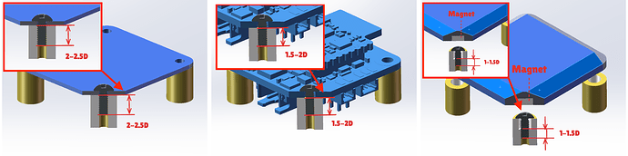

Match thread engagement length for different part designs
We need to design the thread engagement length to fit the following situations.
  • The main structures that need to be tightly connected
  • Connections that do not hold weight
  • Parts that do not need to connect tightly

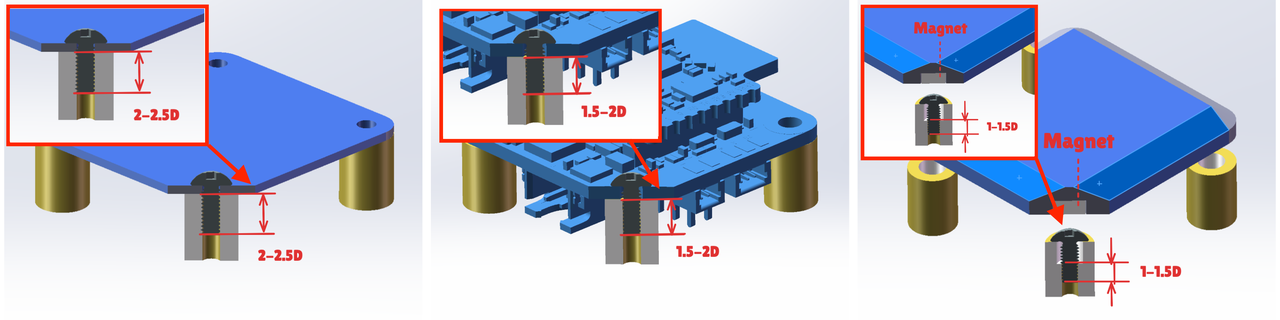

When the main structures need to be tightly connected during assembly, we suggest setting the thread engagement length to 2 to 2.5 times the major diameter (left image). For instance, the thread engagement length for an M3 screw (major diameter 3 mm) shall be set to 7.5 mm. This length strikes a good balance between how strongly the parts connect and the tightening torque.
When installing many screws with an electric screwdriver, we suggest setting the thread engagement length to 2.5 times the major diameter. This keeps threads safe from being damaged.
For connections that do not hold weight, we suggest setting the thread engagement length to 1.5 to 2 times the major diameter (middle image). For instance, decorative or light internal parts that do not need to be gripped or hit. With this length setting, you can tightly fix the CyberBrick functional shields to the model.
For parts that do not need a tight connection, we suggest setting the thread engagement length to 1 to 1.5 times the major diameter (right image). This setting helps fix the parts tightly. For instance, screws are used together with magnets to keep the cover closed.
Please be aware that short thread engagement may cause threads to break easily. For BT2 and M2 screws, we suggest setting the engagement length to at least 4 mm. For BT2.5 and M2.5 screws, set the engagement length to at least 3 mm.
Left: The thread engagement length is 2 to 2.5 times the major diameter. Middle: The thread engagement length is 1.5 to 2 times the major diameter. Right: The thread engagement length is 1 to 1.5 times the major diameter.

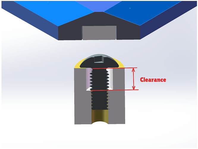

Due to screw length and space limits, the thread engagement lengths for horizontal and vertical holes can sometimes be longer than necessary.
To make installation easier, we can design a clearance at the top part of the screw hole (the image below). Set the clearance larger than the screw diameter. This reduces the number of turns to tighten a screw and the thread engagement length, making the installation process smoother.

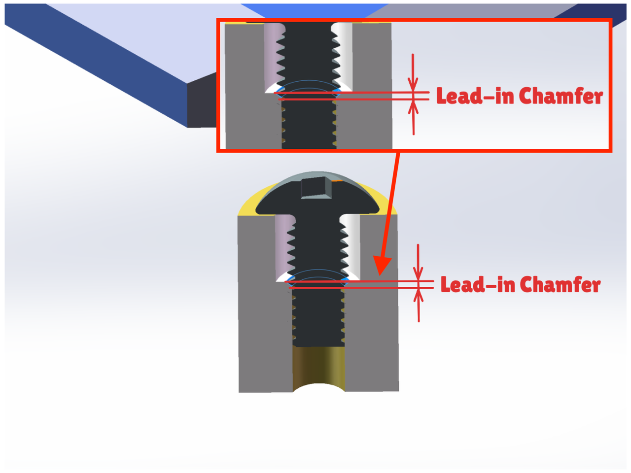

Design lead-in chamfer
When tightening a screw, it may shift from its planned spot. This causes unstable fastening or damage to the part. So, we suggest designing a lead-in chamfer (the image below), a sloped edge to guide the screw in straight. To prevent the screw from tilting, we suggest adding a 45° chamfer at the top of the screw hole. Set the chamfer depth a bit more than half the difference between the screw’s major diameter and the actual hole diameter. For instance, when designing a screw hole for an M2.5 machine screw (diameter 2.2 mm), set the chamfer depth to 0.4 mm.
Please be aware that the overlap between the lead-in chamfer and the threads is minimal. Therefore, the chamfered depth shall not be counted toward the thread engagement length. During design, we need to reserve enough depth.

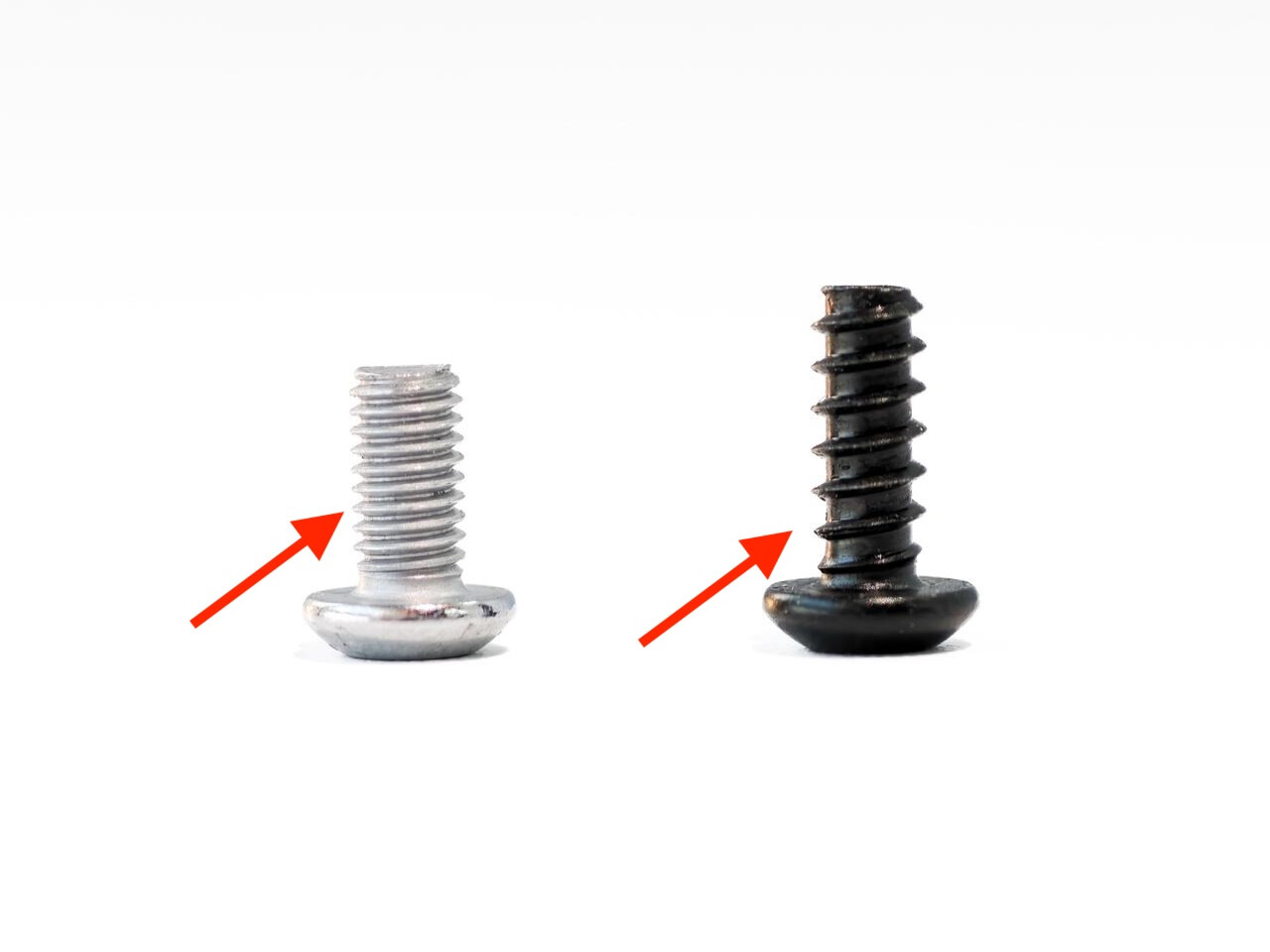

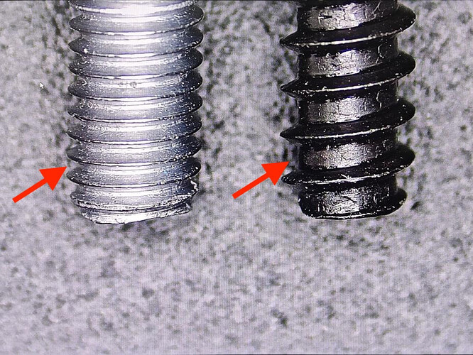

Features of self-tapping screws
Compared to machine screws, self-tapping screws have a larger thread pitch and deeper thread roots. In the image below, the left is a machine screw, and the right is a self-tapping screw. These features help them cut into materials more easily. They also reduce the needed tightening torque and make installation easier. It also makes them more compatible with screw holes of different sizes.
Left: Machine screw. Right: Self-tapping screw.

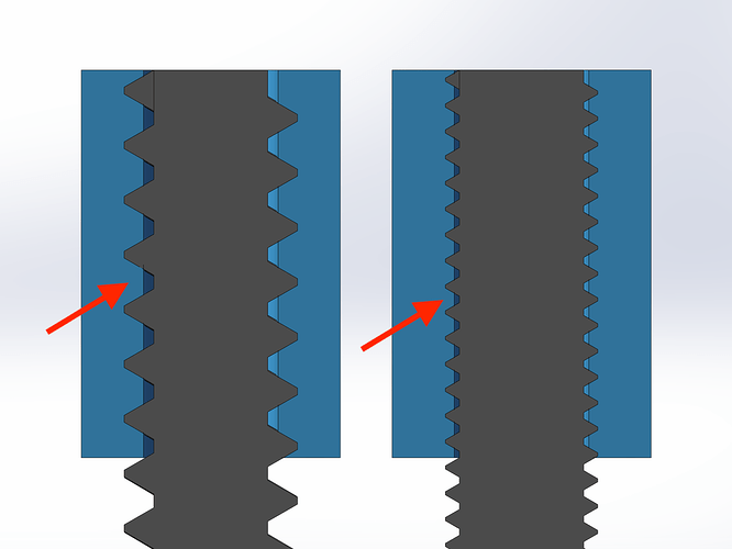

Machine screws have shallow threads. Therefore, we need more threads to ensure a strong connection. Machine screws and self-tapping screws share the same thread engagement length. But machine screws usually have about half the thread and thread pitch of self-tapping screws. Thus, it requires more turns to tighten machine screws. This makes them slower to install. (Left: a self-tapping screw; right: a machine screw.)
Left: Self-tapping screw. Right: Machine screw.
Self-tapping screws are less likely to cause cracking in materials. This helps them stay securely fastened, even after being removed or reinstalled on the original threads. Thus, compared to machine screws, self-tapping screws are a good choice when you need to take the screw out and reinstall it once in a while.
In short, when directly screwed into printed parts, self-tapping screws offer these benefits:

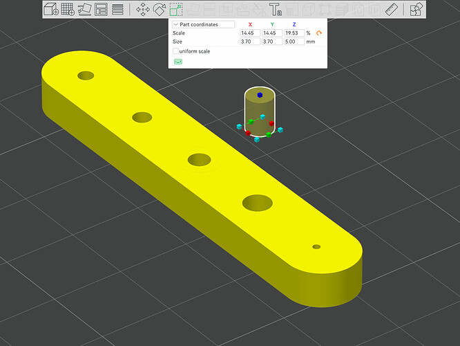

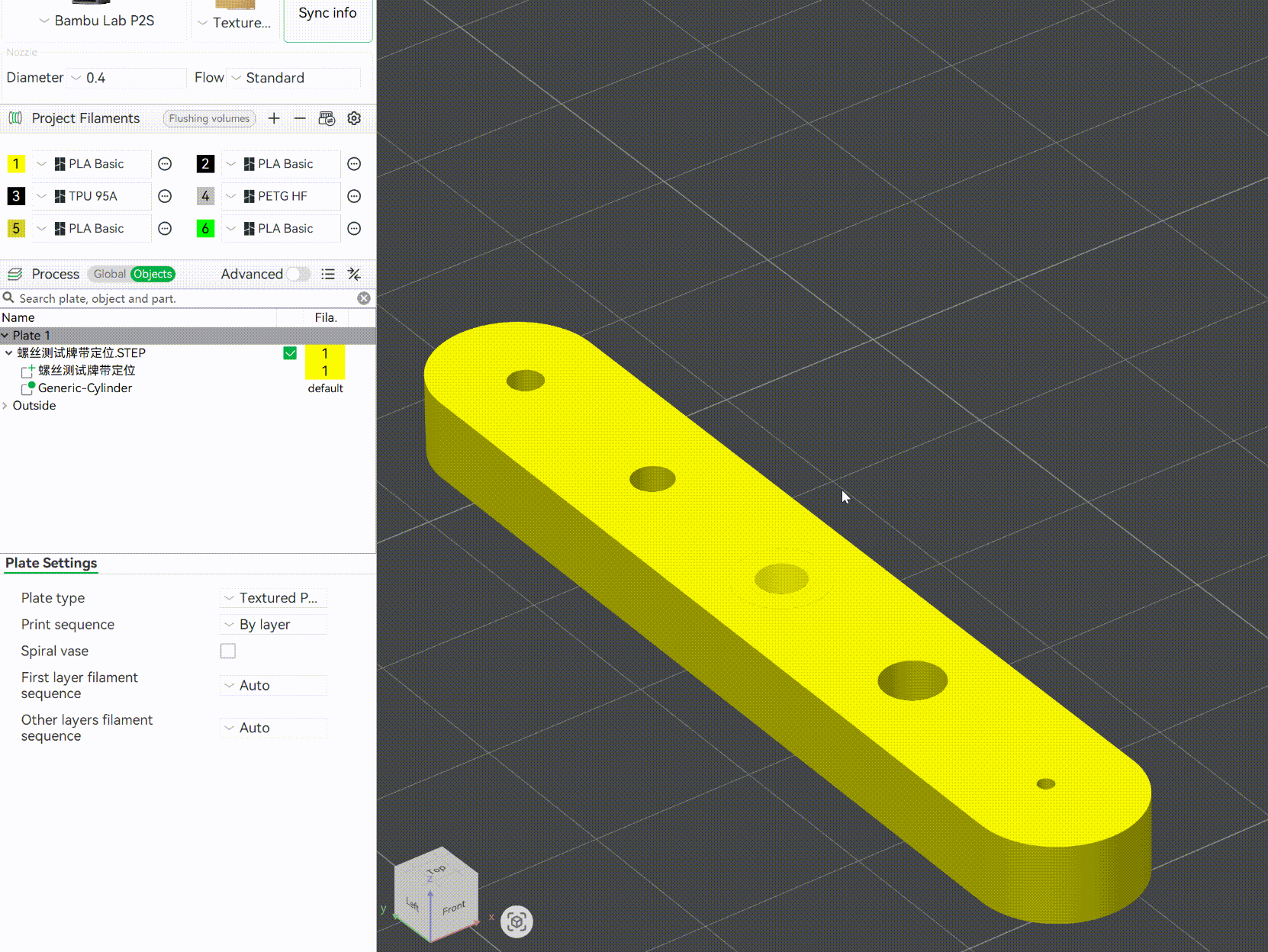

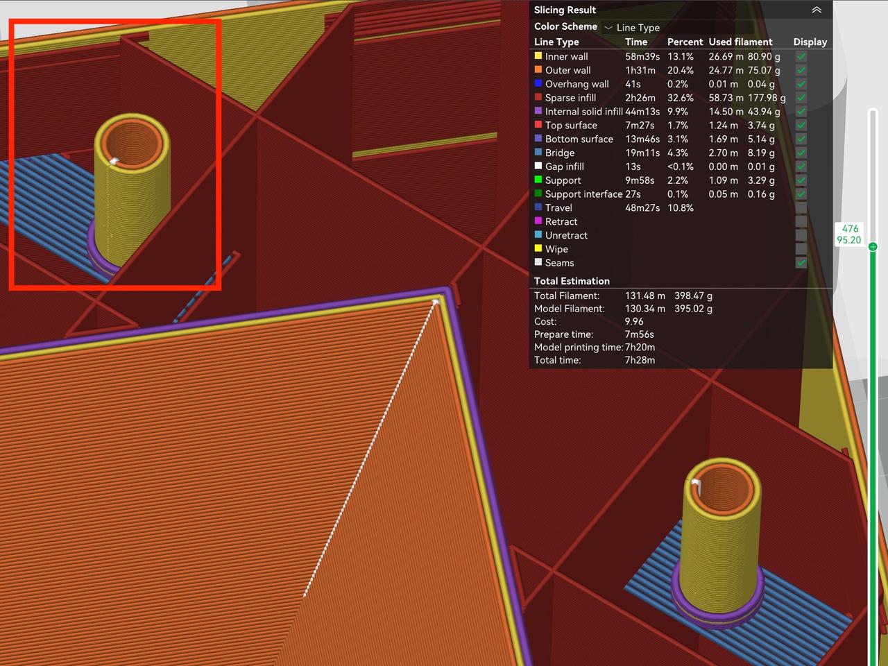

Adding more wall layers increases print time and filament usage. To save material, we can use the Modifier feature in the slicer software. This allows you to modify the number of wall layers only at the bottom of the screw hole. Let’s have a look at how to adjust the number of wall layers together.
When designing your CAD model, draw a circle on the surface around the screw hole and extrude it by 0.01mm. This creates a raised circular area that helps position the modifier.
Import your model into Bambu Studio, select the part, and right-click to open the dropdown menu. Then click Add Modifier > Cylinder, then click OK in the Add Modifier pop-up.
Set the modifier diameter to 0.8 mm larger than the screw hole diameter. The increased portion, i.e., 0.8 mm, equals the filament diameter x additional wall layers + 1. And make the modifier depth equal to the screw hole depth.
Select the part, then click the Assemble feature in the menu bar. Select the top surface of the raised circular area at the top of the screw hole. Then choose the top surface of the cylinder modifier. Click Center Coincidence, then uncheck Flip by Face 2 to embed the modifier into the screw hole.
Select the modifier, then set the Wall Loops to 3.
Go to Preview. You will see that the wall layer number is now 3 (the image below). All other settings stay the same.

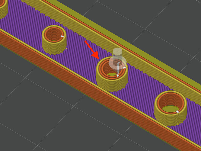

When the infill density is low, screw hole walls may not connect to the infills (the image below), and the interlayer connection area remains small. This makes some parts locally fragile.

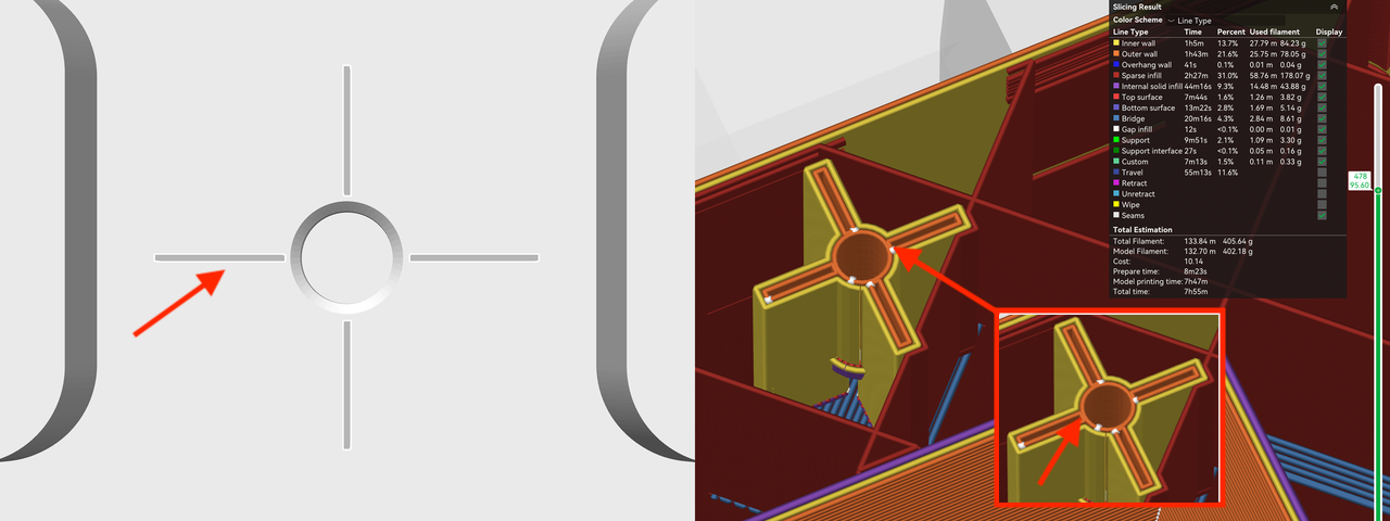

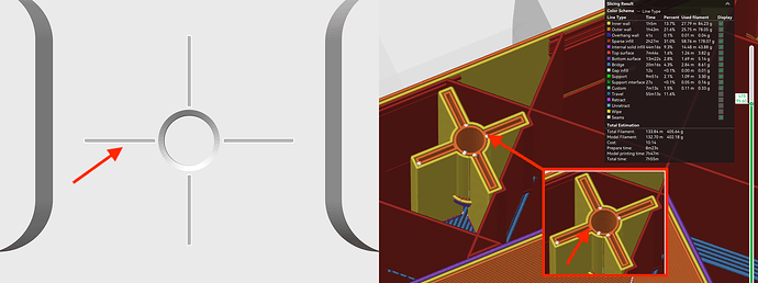

To make screw hole walls stronger, in addition to adding wall layers, we suggest designing radial slots that bridge to the hole.
In the space between the internal walls, draw thin radial slots around standalone screw holes (left image). To form a continuous hole wall, set the spacing between the radial slots and the hole wall to 1.5 to 2 times the filament width. Set the slot width to 0.2 mm, its length equal to the screw hole diameter, and its depth matching the screw hole depth. In the slicer software, this generates thin connecting walls (right image), boosting the hole’s strength.
Left: The design of the radial slots. Right: The thin connecting walls, bridging to the hole.

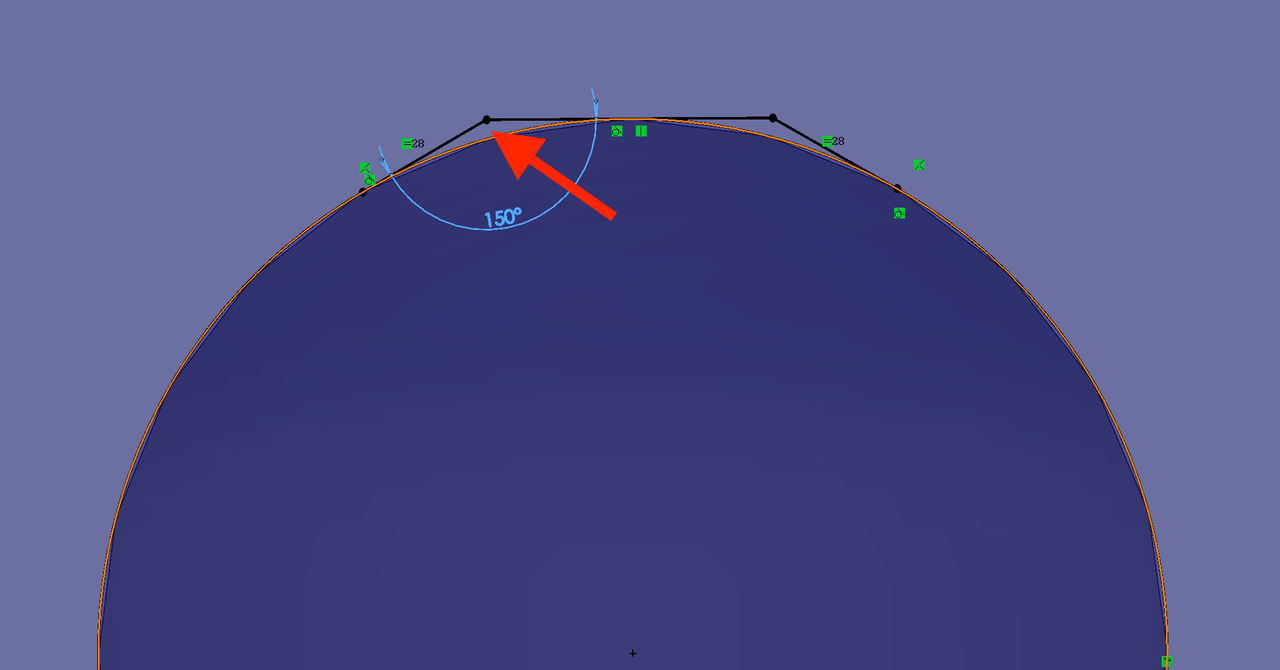

Only thing I’m doing different is using a 45° overhang value in this situation which basically translates to 90° + 45° = 135° in your drawing.
150° (like you selected) works well with PLA but for most other filaments - depending on the layer height - this is too much of an overhang as to my experience.
