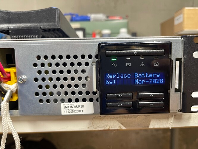

I’m opening a discussion to share my findings with a UPS (battery backup). I’m an IT professional with 25 years experience in networks 🖧. I have a UPS on my home network and another for my TV. When the power goes out my WiFi lasts for 3 hours and 1 hour of TV via the UPS’s :battery::low_battery:. They are APC Smart UPS 1000va which is actually 600W despite the misleading 1000 in the model #. (Please see my recommended list at the bottom if that’s all your looking for, but I’d recommend reading all of this.) :down_arrow:
Because the P2S has a huge power draw :high_voltage: when warming up (about 15-30 seconds), the UPS light flashes red and an error on its screen says “power overload” :police_car_light:. Once that phase passes however it then shows “RunTime 1.5hrs and as much as 2.5 hrs” which means if the power goes out it will continue to print for 1.5hrs - 2.5hrs :white_check_mark:.
:light_bulb: So the theory and conclusion: Even though I get the power overload error at the beginning, it doesn’t matter because nothing is printing at that time anyway. What matters is while it is printing if the power goes out, the power won’t simply go off and stop printing or much worse cause a clumping disaster :volcano:. It will give time to gracefully :butterfly: stop the print or allow it to finish if it’s close to being completed ██████ 100%.
For now, I removed my UPS from my TV to the P2S printer and will replace the TV UPS soon. I’m lucky because I get these for free from work :wrapped_gift:. Clients replace theirs when the battery dies and I then buy a replacement battery for $30-50 on Amazon and good as new and very easy to swap the battery. Not ideal for production networks, but fine for my house :house:.

To get the screen to stay on, long click the “menu” button until it beeps once. Then click menu button again (quick clicks) to cycle the menus until you find the display that says “minutes during power failure” and it should then remain on this screen so you can see live how much time it will last and more importantly during an actual power failure how much time you have left before it powers off.

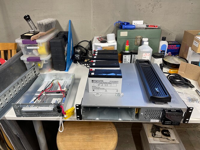

Say, one more note: UPS batteries wear out but not the rest of them. This means you can often buy perfectly good high end ones cheaply, replace the batteries and be back in business. That’s how I scored a high end APC for my network

As noted above, the sealed lead acid batteries wear out fairly quickly in most UPSs. I have been using a new one at work. These have a Lithium Iron Phosphate battery in them. This is the safe, long lasting lithium type that doesn’t catch fire and lasts decades over thousands of cycles. This brand also has more Wh of battery storage on board than most lead acid types. (Especially when you start to factor in high C rates from the lead acid batteries that decimate their actual capacity.) However, I don’t have any of the larger ones to try at home. But this should be worth considering, if you are buying new.

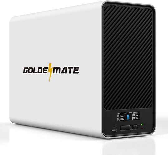

This is great NoH. If you can now buy lithium for virtually the same price, this is a good way to go for users. Haven’t heard of that brand, but seems they are ahead of APC and CyberPower and will likely take some of their market share before the big brands start using lithium ion. Everything else uses lithium now so why not UPS. Thanks for sharing :ok_hand: and good find. I like it! :100:
Hmm, reports of reversed polarity and open grounds, no actual certification listings, non-replaceable batteries (AFAICT), heavier than lead-acid… yea I dunno. Call me conservative. The (relatively) inexpensive lead-acid batteries typically last me many years already (how often do you replace your car battery which has a much more stressful life?), and actually are better at handling loads than anything lithium based (“C” rating). :person_shrugging:
-M
Per the reviews and markings, I did read the reviews on the bigger models and see those do have problems in their review. I can’t say much about that, as I haven’t experienced them. I only have about a dozen of the 800 watt models. And looking at APC and Cyberpower, their 1 star ratings are a similar percentage, so it doesn’t stand out the same way. Guess just make sure to test it within the return window. As for markings, the units I have do have regulatory markings. However, one would have to do research as to if they are self certified or lab certified. The last marking is hard to read. It is “IEC 62040”.

It won’t. Works fine for a P1S but will not hold up to the H series. Cannot comment on P2S but I would imagine for fast bed heat it wouldn’t, or at least complain about it.
The rest of the Goldenmate line is as dependable but like you mention, more butt to back it up.
There are many of us that just want to get past the hurdle of the bed warmup at startup. Backup is nice but dropping a breaker when starting up get’s old. I have no care for a backup battery protector as our printers have resume and they do it very well. I just want to keep my little bench up and running without damaging anything in the meantime.

I’ve been running the large goldenmate unit on my H2D since May of last year and have had no problems to date. The maximum power output is right at the absolute limit of the printer though. During startup of a print job it will cause the ups to alarm for a few seconds using full power mode. I have not had a chance to try the new firmware with the low power startup setting
