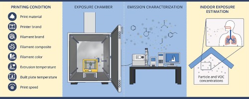

3D Printing toxicity report
Exposure hazards of particles and volatile organic compounds emitted from material extrusion 3D printing
Thanks for the info. I was aware of a few, but I didn’t imagine that there were so many VOCs released from FFDm, and I was also surprised by specific filament results, especially PETG.
Besides avoiding inhalation (not always possible) and setting up forced flow extraction with an active carbon filter, I am unaware of other simple and effective measures.

ā€œThis work has shown experimentally that VOC emissions from plastics increase with temperature, owing to the migration of chemical compounds from the bulk polymer to the surface which then diffuse into the surrounding air.ā€
I think its always worse at higher temps. We went from pla at 190c to 220c. Silk pla went from 190c to 230c.
https://www.sciencedirect.com/science/article/pii/S0048969723021162#:~:text=This%20work%20has%20shown%20experimentally,diffuse%20into%20the%20surrounding%20air.
