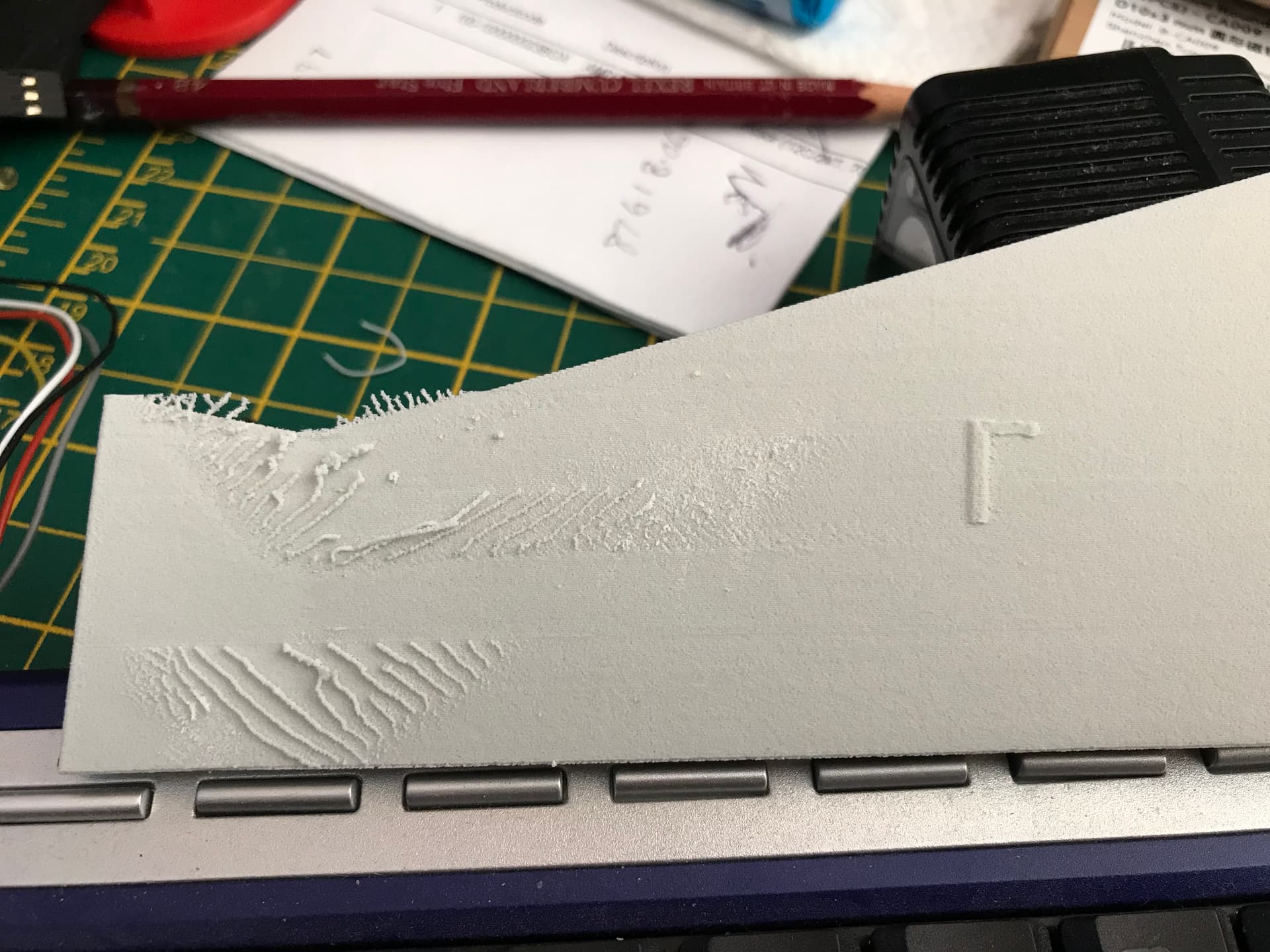

I followed Bambu’s recommendation to dry the filament, I dried it for 8Hr at 55 degrees, I also manually calibrated it, it came out at k-0.05, Flow 0.6, Default print settings other than those required for 2 Top and Bottom layers with an Infill of 3%.
This print is a practice run before printing in ASA-Aero…wish me luck… :thinking:

Bambu Lab’s very own, the secrets ingredient is to dry it as recommended followed by a full “calibration I did mine manually”. I’ve converted a sealed tapware to include rollers at the bottom so the reel rolls as smooth as possible, seems to work, printed at 220C… :wink:

As this is my first print of a plane, I’ve been very conservative with temperature but now I have files to play with I’ll be experimenting.
I believe that it might be the case of having to calibrate the filament for whichever temperature you chose to print at every time.
My observation; printing Bambu’s Aero PLA is that the print settings are spot on, I’ve had 2 failures of the thinnest area lifting off the build plate.
The lifting off the plate was my fault, oily flinger, I’ve determined a need to wash the build plate every third print with dish soap and very hot water, I have 2 plates on the go.

This is a mixture of sanded and not sanded the darker is not sanded.
The below pictures are after light sanding with 400 grit.
I’ll post pictures of the artifacts which are to be expected but none of which has any significant effect or affect of the final model in your hands and as seen in the pictures above.

“just an experiment”, I printed at uncalibrated 260C and shaved off 2gm off this part, the result is such that there’s no pinholes although at 220C there’re some very tiny ones where the wall are very thin.
The higher temperature has produced a more consistent skin with more artifacts, cleaning is very easy and sanded easily. The down side is the ooze tends to blob in thin slots such as for hinges.

Quick update, I haven’t flown it yet as I just took delivery of batteries couple of days ago, weather has been bad. While I wait I’ve decided to start on the Dark Star 40mm BBL PLA-Aero, this time round I’ve opted to test the highest nozzle temp for this filament @ 260C and dried for 10Hr @ approximately 60C
The initial print has printed awesome so far, the black band is off the nozzle’s residue of black ASA which I’ been printing before.
Latest update on the BBL PLA-LW, having finished the fuselage of the Dark Star and on the last part I noticed the filament wasn’t behaving as it did out of the oven many hours later.
I started the Dark Star from around half way of the roll and after 10Hr of drying, I’ve just put it back into the oven as I suspect the heat hadn’t degassed the filament as it’s quit tight in the roll.
The hydrometer crept up to 19% which was up from 17% during printing and that’s the reason for putting it back in the oven for the last leg of printing the wings.
I think due to the complex shape of the model and the expanded filament at 260C, if I print this again I’d reduce the print speed from the default setting by ~5 - 10% to negotiate the curved areas. I say this as it appears to me the outer most part of the filament is slightly overhanging the curvatures and creating these slight tear drops in the direction of travel.
In summary, I think I’ll try Speed reduction or reducing the filament Wall overlap to say 10% from the default 15%.
