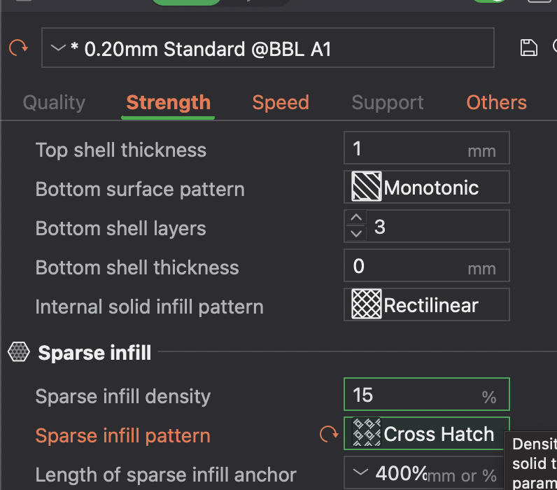

The key to addressing this issue (dragging on infill) with Bambu Studio and Orca Slicer is to change these settings:
In Process Profile:
  • Strength / Sparse Infill Pattern: Choose a pattern where the lines don’t cross, such as Gyroid or Cross Hatch.
  • Other / G-code Output: Disable the “Reduce Infill Retractions” option.
Additional changes you can make to improve this issue are:
In Printer Profile:
  • Extruder / Z-hop When Retract: Set to 0.8 mm.
  • Extruder / Z-hop Type: Choose either Spiral or Normal (Normal is more optimal, but it worsens the finish of the top surfaces).

Changing those settings will fix the ‘dragging on infill’ problem.
I now use the rectilinear sparse infill.
I also checked the ‘Precise wall’ setting under the ‘Quality/Precision’ section.
Now printing perfectly even with crappy old cheap filaments.
