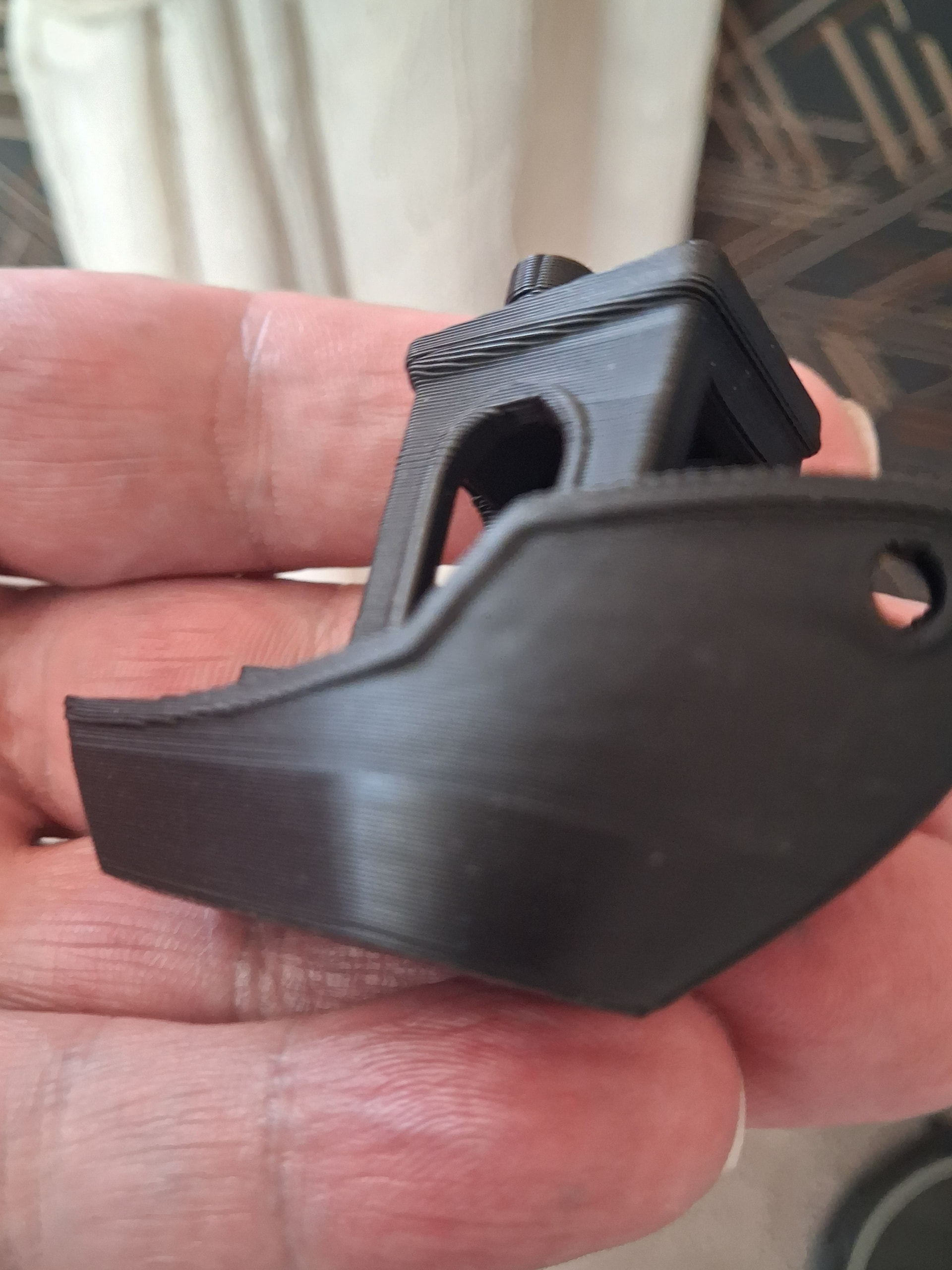

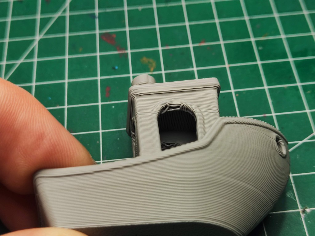

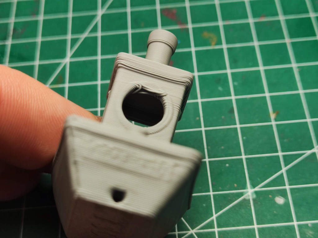

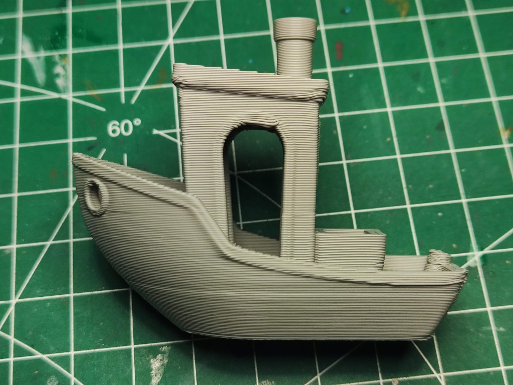

As another example, I have attached photos of a recent Benchy. This is not a miniature and does not rely on complex support structures, yet there are still noticeable issues around the cabin roof, roof edges, door opening and overhang-related features.
What concerns me further is that reducing layer height does not improve the results. Quite the opposite. When moving from standard settings to 0.08 mm layers, and especially when using the 0.2 mm nozzle, the same issues become dramatically more pronounced. If this were simply a difficult model or support profile, I would normally expect higher-detail settings to improve quality, not amplify the problem.

I did that and i provided the pics in this thread…

To me it looks like you are either running too hot or without sufficient cooling.

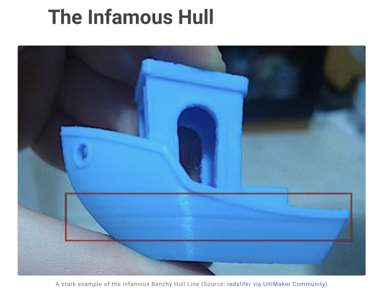

It appears the benchy above is missing a hull line or speed change associated with benchys

It looks like it’s there to me. I even checked to make sure it’s what’s in the photos above.

You might want to post good photos of any calibration models you print. It can help others troubleshoot.
I started troubleshooting, because the print quality of downward facing areas were really bad AND I couldnt finish a single print including supports with normal settings. I could finish supports, but then I wasnt able to remove them, because the melted to the hull of the print.

Nah this what a hull line is
Ok, I will try to muster enough energy to go through all of it again. The printer is not even 30 days old :frowning:
No. Not “nah”. They are both what hull lines are.
