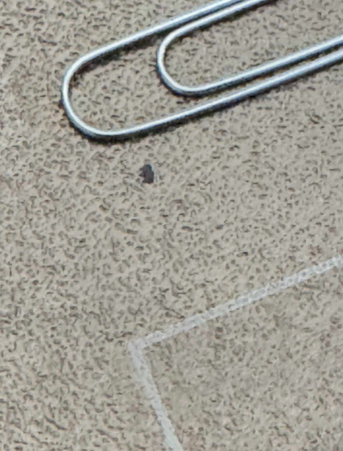

I’m using a bambu A1 mini, and every time the bed levels, it throws a “printing halted becuase automatic bed leveling failed”. When i go to see the solution, it throws error code HMS [0300-1800-0001-0006] [270741]. I can’t find this error anywhere on the error code list, does anyone know what is causing this error or how to fix it?
I fully cleaned all the rails, extruders, etc, but the error nonetheless persists.
Scanning the QR code only leads to the error code list which, in this case, is unhelpful.
Check to see if your nozzle assembly is loose, if so read this.
Tried this, popped open the assembly and tightened screws
Unfortunately, no luck; the bed leveling cycle threw the same error.
I was having this same issue. I popped off the plate and saw there was a small bit of melted PLA squished underneath it. I flicked it off, replaced the plate, and it fixed the issue.
Sure enough! Checked and there was a tiny speck of plastic (paper clip for scale). Thank you so much!
