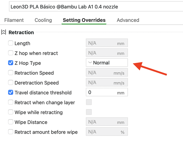

About the problem with the nozzle scratching the printed infill as mentioned earlier in the thread, I found a possibe solution.
Unchecking the “reduce infill retraction” checkmark in the “others” tab makes the nozzle hop over the printed infill (presumed “hop when retracting” is on) when it’s for example traveling across disjoint areas of solid infill.

Could you please try unchecking the option for ‘Reduce infill retractions’ under Process settings/Others?

Thank you verry much for your idea\solution!!
i had the same issue, the nozzle scratching over the print, causing numerous failed Prints.
This seems to be the Soulution, to dissable the Feature:Reduce infill retractions.
right now i am printing the second part without any issue!
I cant be sure, this works for every possible constellation/print, but it helps me a lot!!

I have two small changes that would help reduce dragging even more:

Thank you, i will try this too. i was looking for the settings to get the last few % of “clearance” while nozzle movement, because there are still a few contacts with the printed filament so i get some shiny edges… maybe this will increase the quality back to the “pre FW Uptate” Level :+1:
