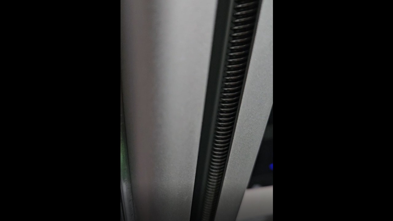

After about 15 to 20 prints, I started noticing a “something loose/rattling” noise (not friction or scraping) coming from the toolhead area. The noise occurs exclusively during fast vertical Z-axis movements (Z-hops) and does not occur during horizontal (X/Y) movements. I can visually notice the Z-axis lead screws moving perceptibly during these hops. You can hear the noise and see the axis movement here:
https://youtube.com/shorts/1Cq1Vjv0MKs.
Is this axis movement normal?
Along with the noise, I started experiencing bed detachment on specific prints, not tall prints, but short prints with multiple islands on the same layer, which generate many repeated Z-hops during printing. This pattern didn’t happen in the printer’s first prints. What could this be?
Mechanical checks already performed, without resolving the issue:
  • Re-tightened all hotend screws, including the internal ones (removed the 4 front screws for access)
  • Checked and re-tightened the screws joining the X-axis to the Z-axis sliders (3 on each side)
  • Tensioned the X and Z belts
  • Ran auto-calibration
  • Properly lubricated per the manual (grease on the Z-axis lead screws, oil on the X/Y linear rails)
  • Removed the AMS Lite tubes and powered it off

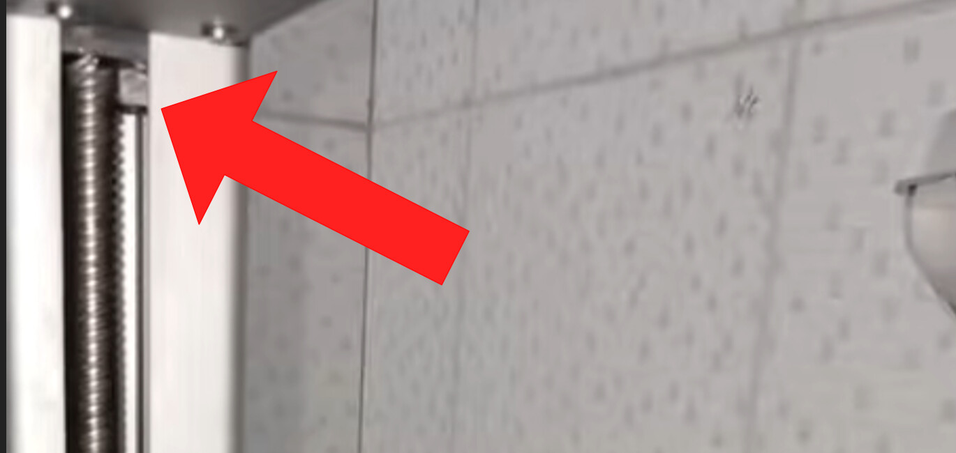

Do you mean the clicking sound? I’m not completely certain yet whether it’s coming from the toolhead/extruder or from one of your axes. Are you sure the noise isn’t actually coming from the axis instead?
If it’s coming from the axis, could it be that you’re actually looking for this solution here?

Even though the noise seems to come from the toolhead area, it appears to be radiating from the Z-axis — it follows the same pattern as the vertical movement, going up and down each time it hops to a different island within the same layer.
I’ve also tested with different filaments, including some that were already calibrated beforehand, and the issue remains the same.
It seems like during that up-and-down movement, the axis is hitting something. I’ll try disassembling it like in the video you shared.
