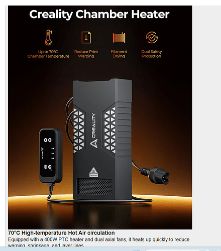

Creality offers a standalone chamber heater with enough power that it might be interesting:
It would maybe give a lift to my X1C.
