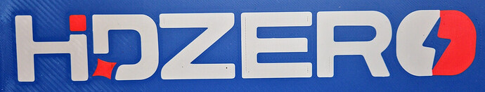

Here’s some bottom layer text I made. Layer height was 0.2mm and the text was 3 layers deep, 0.6mm.
Somehow I have used a 0.01 mm layer successfully in the past, so sometimes it works and sometimes it doesn’t. I will try using a 0.2 mm text layer height. With your example (thank you for the photo), hwo do you get it to be flush with the surrounding if your layer height is 0.2 mm? Wouldn’t that require support material for the surrounding areas? How did you otherwise get the entire region to be flush and flat if the text height was 0.2 mm extended or proud of the surrounding area?
Thanks!
I do my text in my CAD program. I make the text and “loft” it to the thickness of the layer depth I intend to use. Then I position the text where I want it to be on the model, flush with the surface, and use CSG to do a “subtract”, which leaves a text-shaped pocket in the surface of the model. Then, I export the model and the text, preserving their relative positions to each other, and import them in to Studio choosing “as a single object” when loaded. This puts the text in the pocket, flush with the top surface. But it’s a separate object. Print it right side up or upside down, doesn’t matter. Since the text is a distinct object from the body of the model, the slicer has no confusion trying to understand what I’m asking it to do.
