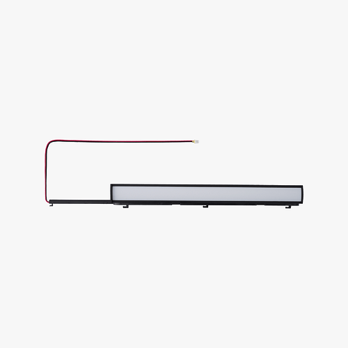

If you didn’t want to cut the cable from the existing BL LED board, you could just purchase the replacement LED for the X1:
And use that wire/connector to drive you mechanical or solid state relay.
I am 99% sure both the P1 and X1 use the same connector.
EDIT - The above replacement is only for the X1. The P1 connector is slightly different.
Different connectors. FWIW P1S use a JST-GH 1.25 connector, X1C is different, mini JST may be. JST GH 1.25 is available on amazon (large expensive set) or aliexpress (cheap and smaller set of connectors).
Uggg. I only have a P1P and the connector I have looks just like the one listed on the replacement X1 - LED listing.
Good catch! That’s why I said “99% sure”
I can’t beleive they actually used different connectors.
So silly BL!
Well, you can buy that spare board for the X1 and cut the connector. They only sell the LED board bundled with the camera for the P1 for 3 times the cost. Doesn’t seem worth it unless you need the camera anyways.
