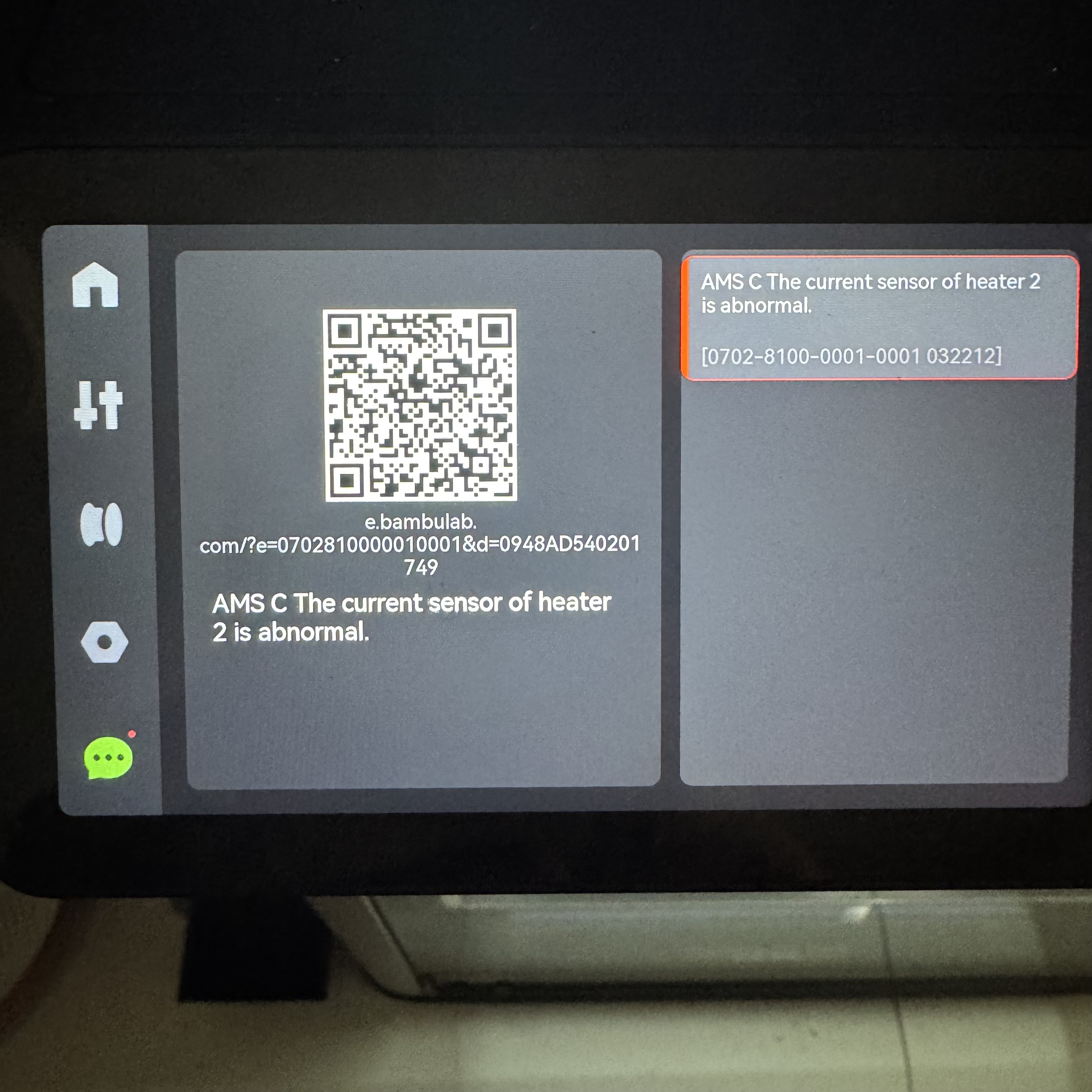

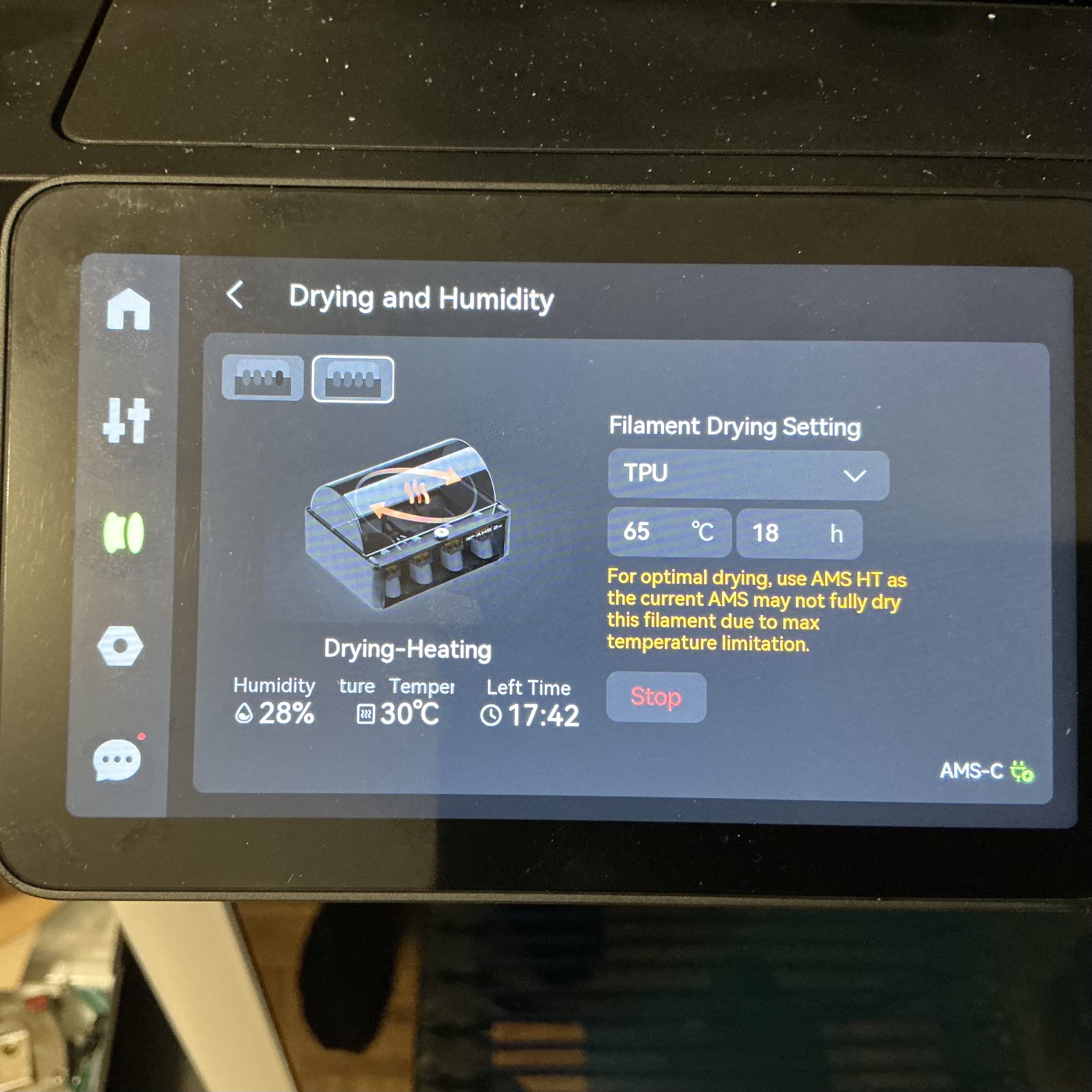

When I try to start my AMS 2 Pro for drying, it gives me this message:
The AMS 2 heater’s current sensor is malfunctioning.
Can anyone help me with this? I don’t know what to do

I have the same problem using AMS2 pro with H2D. After the initial setup (first try) heating was functional. Now I’m getting the described error.
Opened a ticket last week, problem is still not resolved, reaction of technical support is quite slow.
I’m on FW (AMS) 02.00.19.47. Which FW does your unit have?
Additional information: HMS 0700-8000-0001-0001

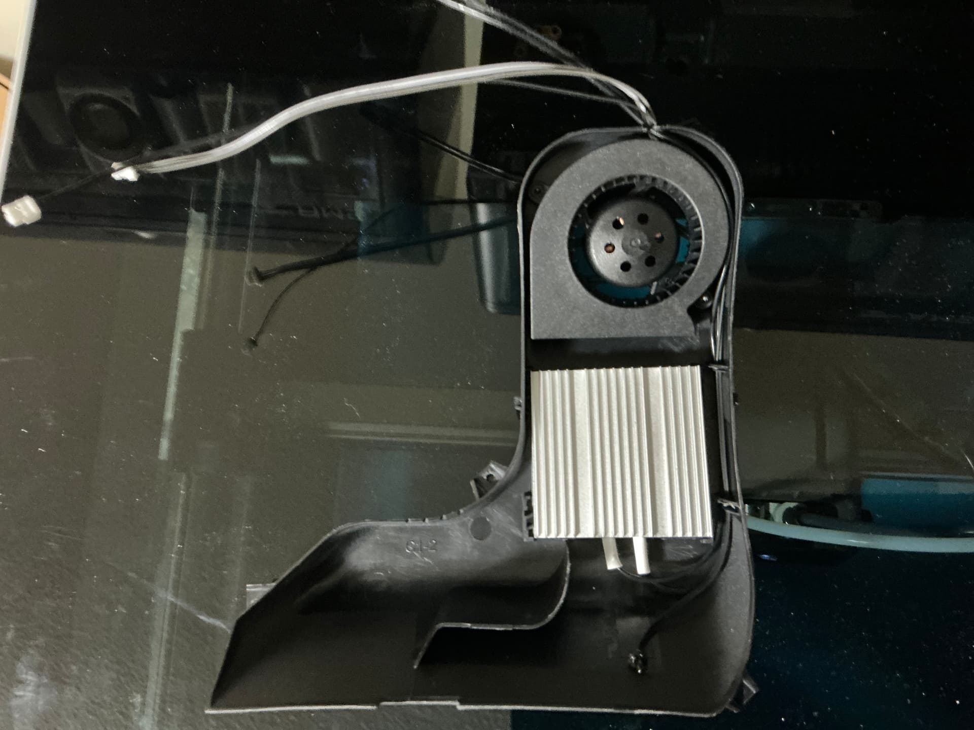

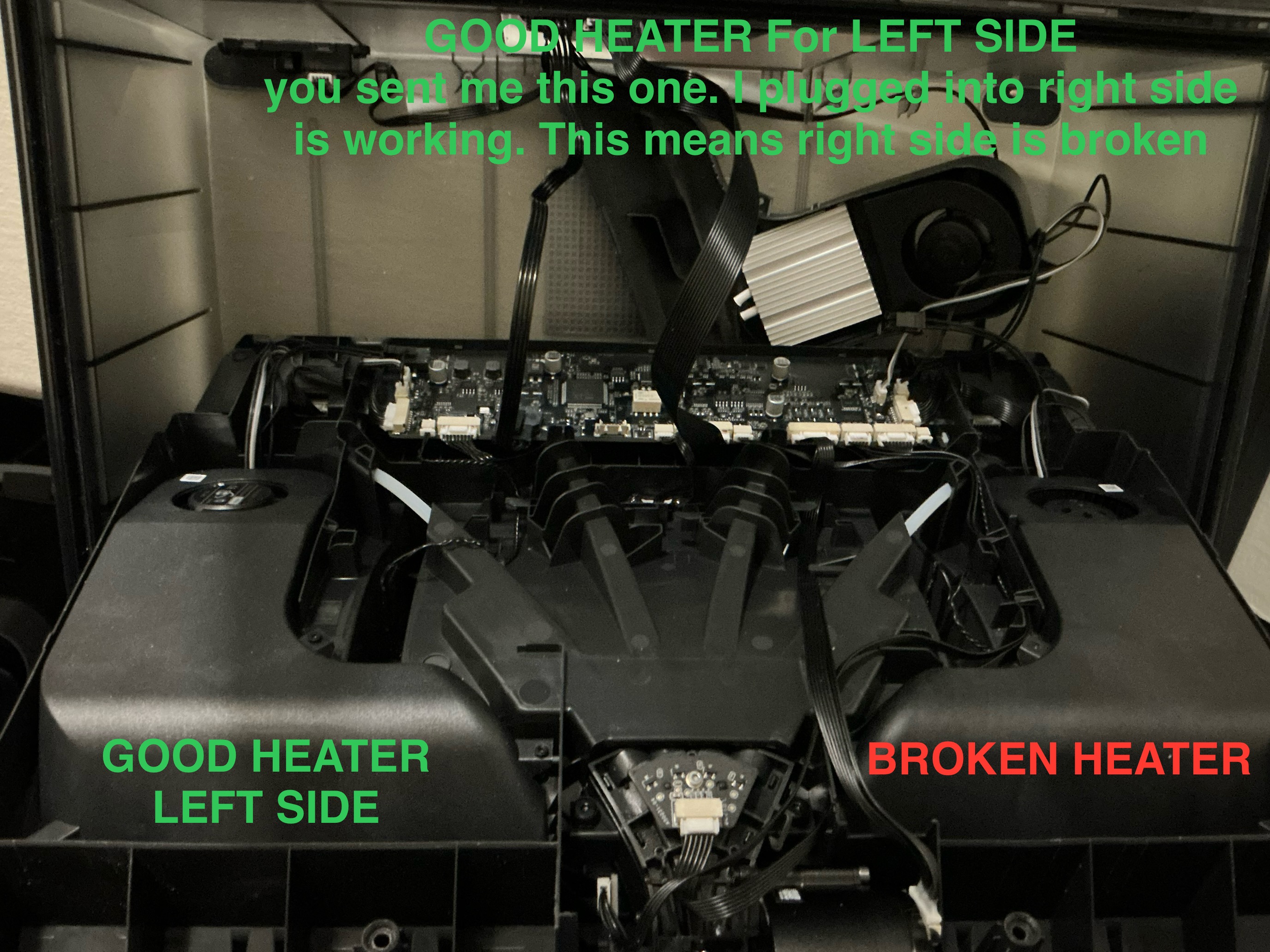

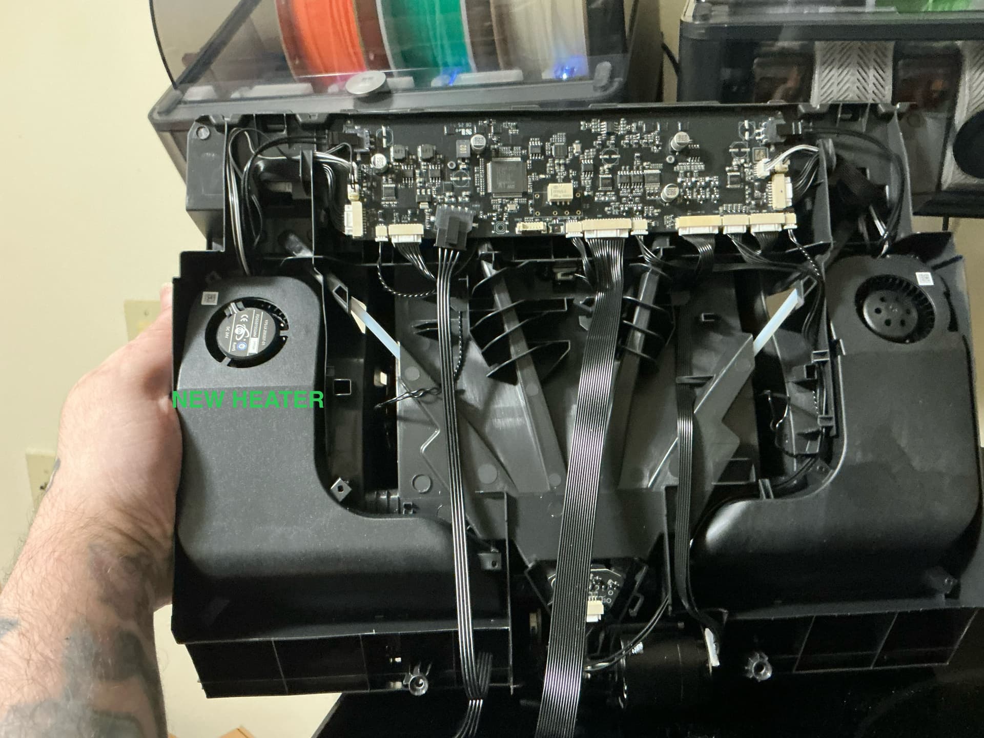

Support sent me a new heater which I easily installed and it made no difference. I reported back to support with install photos and they haven’t resounded in at least 6 days. I don’t know what else it could be.
I FOUND THE PROBLEM! I updated in your thread. It’s the other heater that is broken. I figured it out by plugging in the good heater that they sent me into the other side and when I did this and plugged everything in, the heat came on with no errors! Of course I cannot fit the left side #1 heater they sent into the right side because it does not fit. So I requested a new #2 right side heater. I don’t know why they even sent me a #1 heater when the sensor mentioned #2.
Actually I just figured something out! Both sides are exactly the same except I believe the fan is mounted upside down! And of course the plastic only fits one side. I am going to try uninstalling the fan and heater from the plastic.
