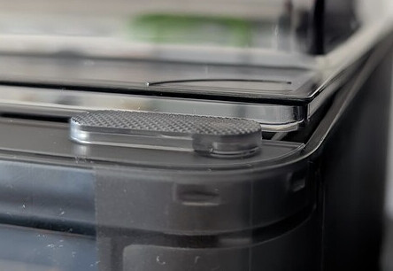

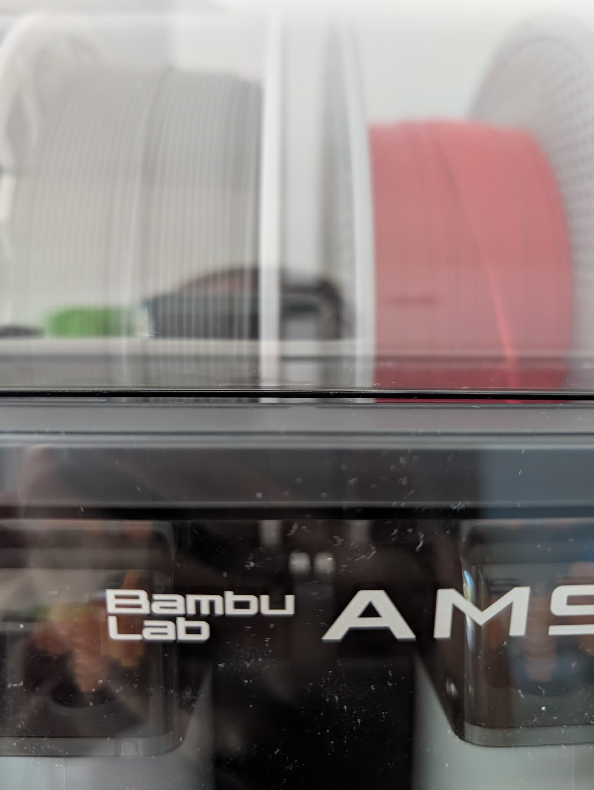

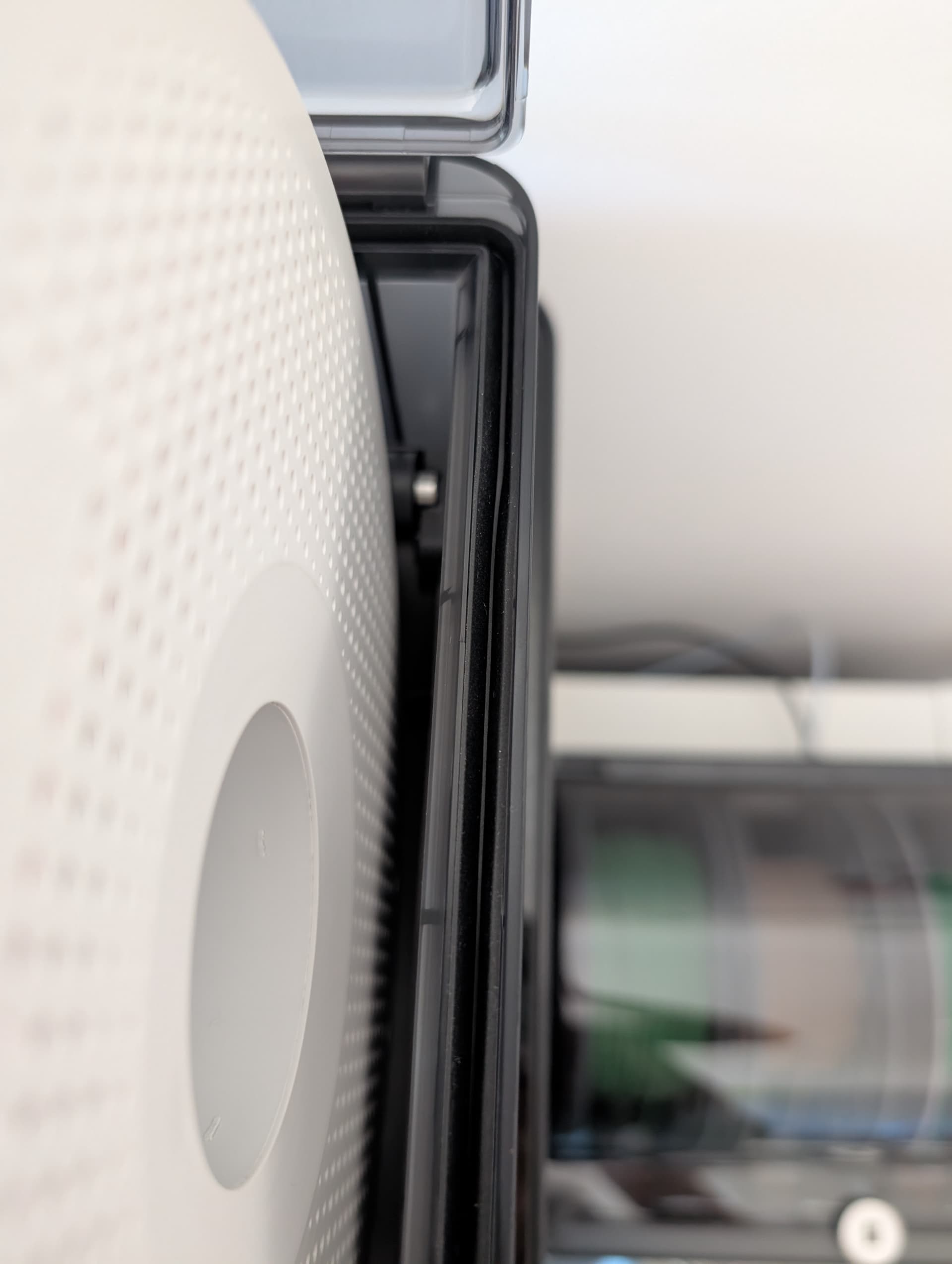

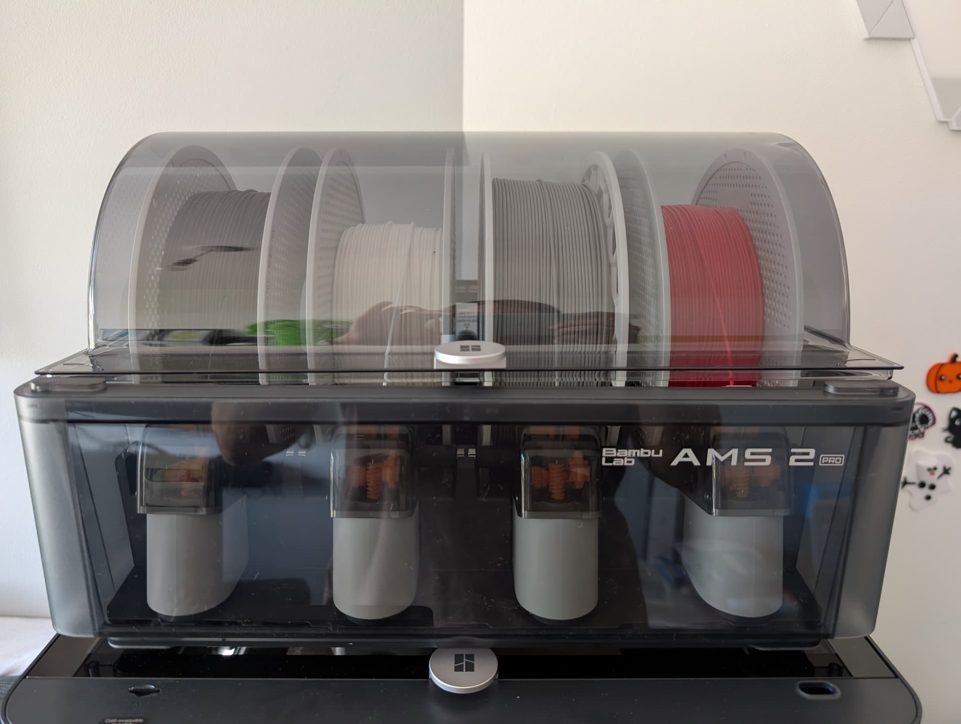

My new AMS 2 wont close fully, looks like an issue with the seal, has anyone else got this. I think there a kink in the rubber seal as its not closing without me push down hard on it, It’s not air tight as its causing a gap.

Theres still a gap, it just doesn’t want to sit flush unless i push it down, but then it bulges, stopping it from being air tight.
Even if i twist them its like its trying to force it up and there a gap. No matter what i try it wont sit flush. The unit is advertised as air tight, this isn’t currently for me
I have 2 AMS 2;s and the other unit is fine, sits flush so i can compare them and this one jsut seems misaligned, or the seals warped
It’s held in place by an adhesive strip but if you trust it to stick again you could pull it out and re-seat it from scratch. Using something dull to tuck in in to place.
I replaced about 6 of these on the original ams, now I use a synthetic grease on the lip so it slides in without bunching the rubber.
I have a brand new ams2 with the same problem. Submitted a ticket but Bambu wants more pictures, did you get this solved?
Mine just popped back in after a lot of opening and closing. They did send me some instructions to help but I didn’t need them in the end.
