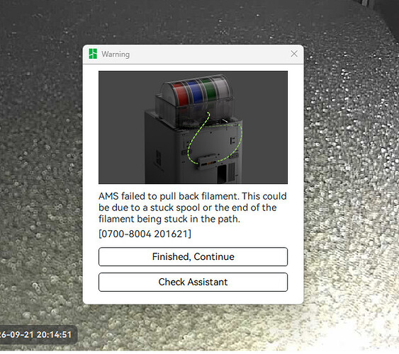

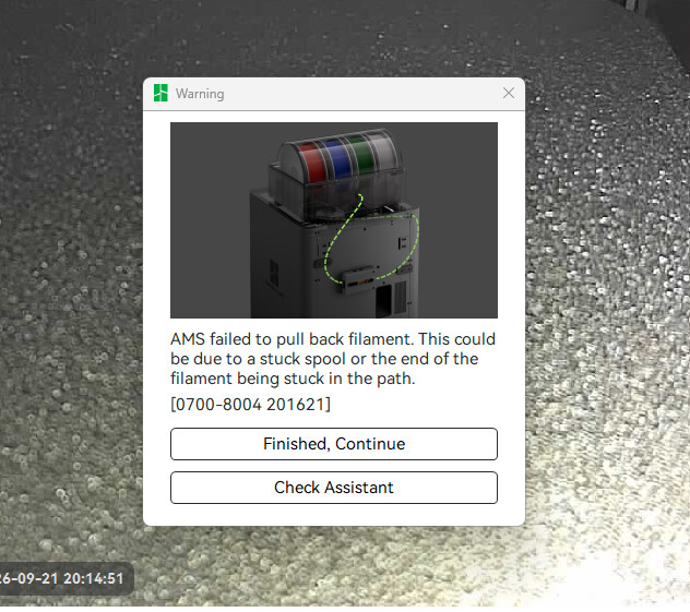

Symptom: slot 3 showed as loaded even though it was empty. It wouldn’t accept new filament, and after a while it started throwing 0700-8004 (failed to pull back filament).

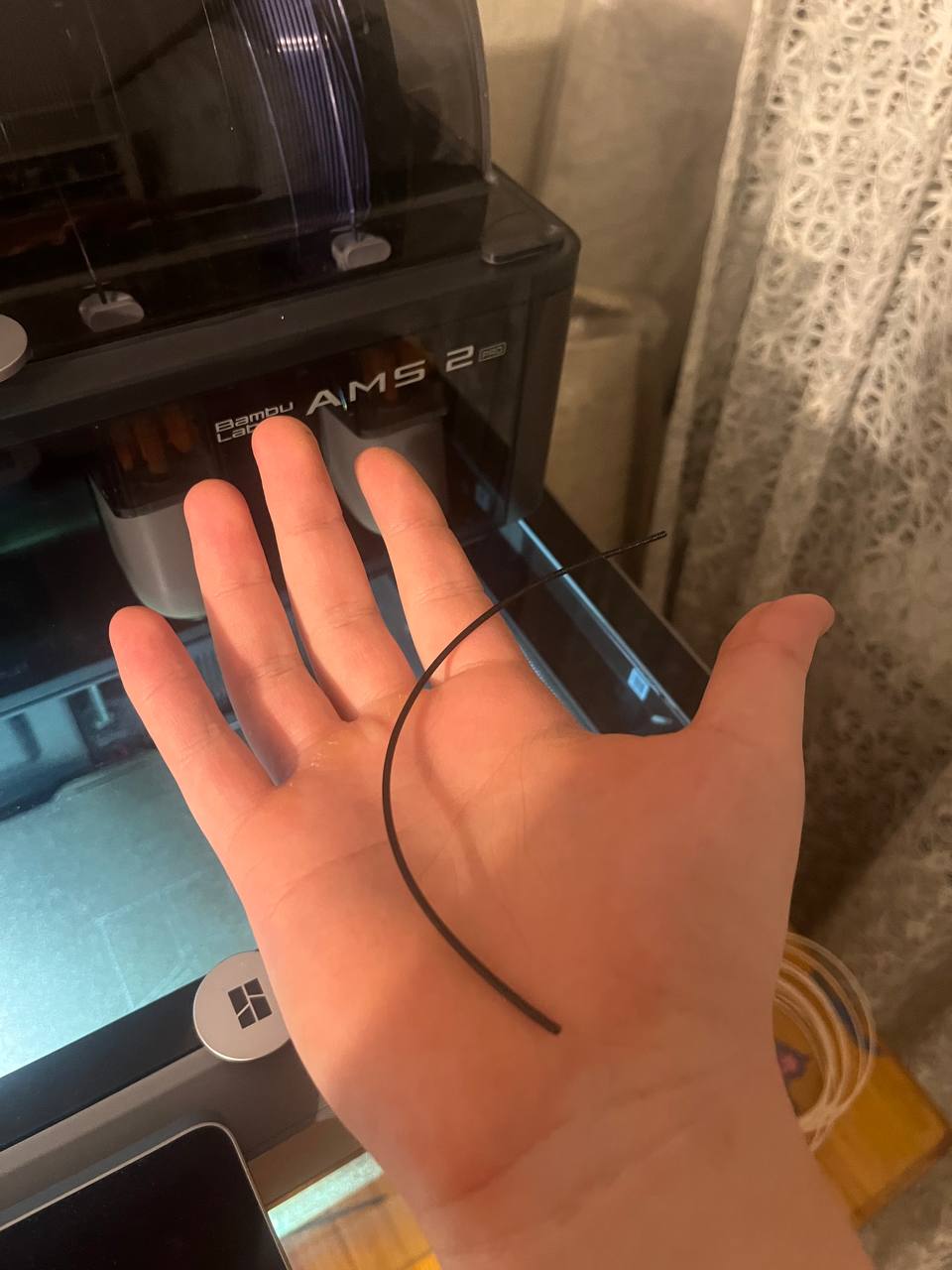

Cause: a small piece of filament stuck in the tube. The sensor kept detecting it, so the slot never registered as empty.
Fix: followed the official guide for this error and got the piece out:
Slot works normally again, no hub disassembly needed.
So if a slot is convinced it’s loaded, check the tubes for a broken off piece before opening the hub. Most of what I found online points straight at opening or replacing the hub, which is worth avoiding if the cause is just debris.
