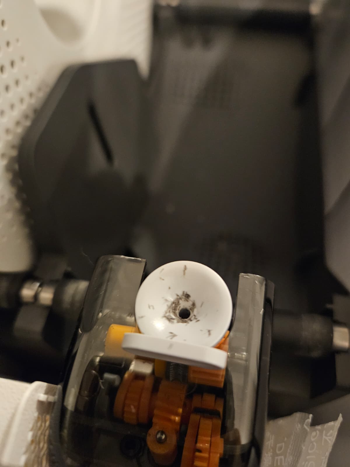

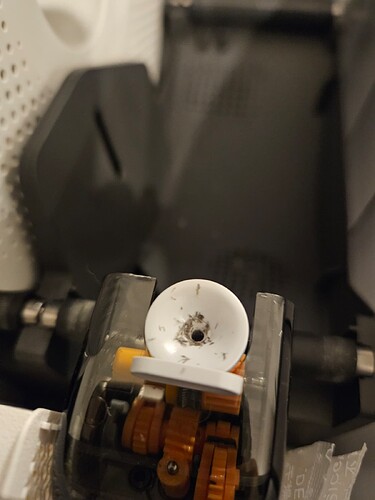

Hi, I’m having the same problem with slot 4 on an AMS 2 Pro:
while I am loading the filament, the feeder pulls it in but the Active Support Shaft remains stuck, causing various problems such as the spool hitting the top cover, the filament being scraped by the ring nut, and strain on the various feeder gears that continue to pull.

Before sending it, I checked that everything was clean, and in the end I found this situation:

Weight generally helps, if it is always broken then the gear in the feeder by have striped the shaft splines. Someone has repaired striped splines with super glue.

I found the cause of this spool lockup. I have two AMSs, 18 and two months old. During loading, the Active Support Shaft freewheels, and the spool is rotated forward by the filament being pulled into the Feeder. During unloading, the orange gear in the Feeder engages the Shaft to actively rotate and rewind the spool. When unloading stops, the gear is supposed to fall away by gravity.
That is the failure point. That plastic gear is so lightweight that its teeth can remain barely engaged with the shaft gear. On the next load, the spool turns the shaft, the gears wedge together, and the spool locks. Turning the spool slightly backward frees the gear teeth and helps the gear fall away and disengage.
Spool weights only mask the issue, if they even work. I blow out the Feeders with compressed air and so far they’ve been fine. That’s really all you can do - you can’t lubricate them or anything. The real fix would be to redesign that orange gear mechanism with a positive, controlled disengagement mechanism—maybe motorized or spring-loaded—instead of relying on gravity. Bambu engineers—are you listening?
Maybe add weight to the orange gear, or a light spring.
