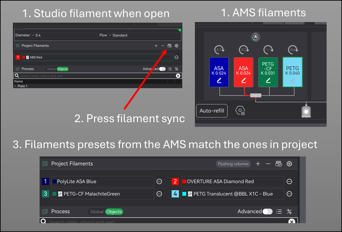

Hi
Not sure if I got it.
If you load filament into the AMS and attribute the preset to a slot, this should be in memory and can be used for any model.
Now, you may be setting the filaments’ presets at the model level, i.e., in the Prepare Tab, and those settings respect the model.
If this doesn’t answer your doubts, please clarify when you open Bambu Studio (without loading a model) and sync the AMSs in the Prepare Tab, does it show the filaments you set in the AMS?
E.g.
Thank you so much for the great info. The mistake I was making was loading the AMS slot info while I had a model loaded. I did it as soon as I turned on the printer, and it retained the info. It’s great not having to reload all the AMS slots info every time I want to use the printer.
Thank you again…
I found that loaded projects also store the AMS information from its last time used. I got into the habit of syncing after loading the project and that seems to correct the loads. Mine is H2D and it will blank out the AMS until I sync.
