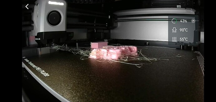

I think I’ve spent more time drying the PVA than printing with it (so I’m hoping it is dry enough). I’ve had it running in slot 1 on the AMS (no reason other than I’d just put a different spool in slot 4) and (with the PLA printed spool holder) I’ve not had any more problems with the filament feeding. It does cause a lot of stringing though. So bad in fact that it triggered a spaghetti warning during a print, and then clogged up the waste chute.
Fortunately the print was ultimately OK, but the stringing is a bit of a problem.

The print did complete in the end, and has worked well - so the main outstanding issue is the huge amount of stringing of the PVA filament.
EDIT: A bit of searching indicates moisture is the likely reason for the stringing, so I guess it’s back into the oven with it. I have a proper dryer on the way so that’ll be a better tool for ensuring the PVA is “just right” before every print.
