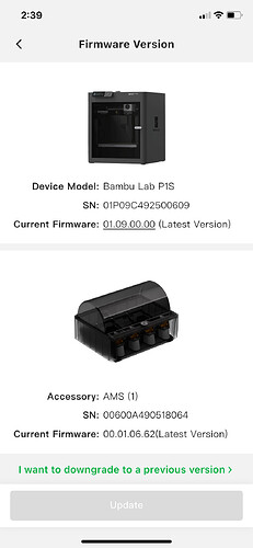

My suspicion is that the “Update Remaining Capacity” setting, when paired with the ~20 g roll, may be triggering this behavior. I will test with that setting disabled to see if the issue persists. However, this appears to be a bug.

You might want to update your report with the firmware version (please don’t say “the latest version”, that isn’t a choice on a bug report form). It’s easier to collect the firmware and AMS version numbers from Bambu Studio instead of the device screen.
Also to clarify for their report, by eject do you mean it totally unloads the filament so it is no longer in the AMS feeder nozzle at all and the filament end is dangling loose around the spool? If so that sounds like a serious bug.
