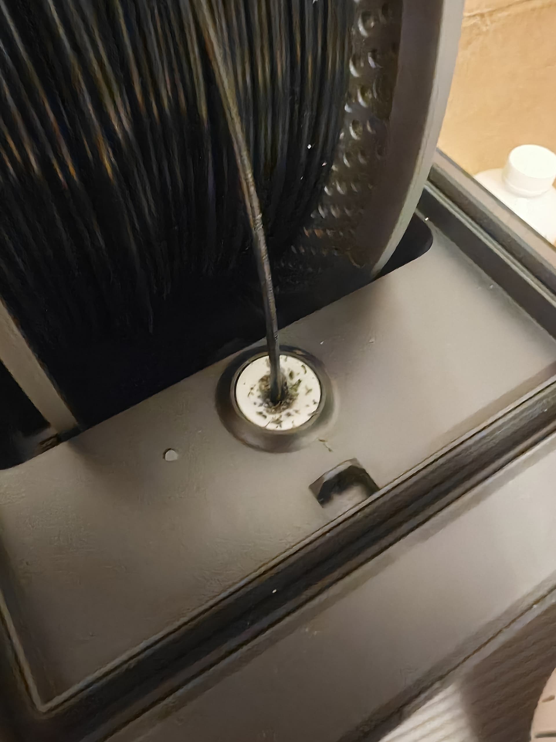

the heavy grinding of filament probably is due to the 5 attempts it makes to feed the filament into the extruder gears and failing for whatever reason we all suffer from.
This is how my inlet looked after a few attempts to get ASA fed to the X1. I even cut off the grind section after failed attempts. This did not help.
Support then suggested to use PLA or sth more stiff instead. I gave the AMS HT a good vacuum to get rid of as much debris as possible without disassembly and after that it actually worked for a few times now to feed PETG and ASA. I could complete some prints.
My best guess so far is that the drive gear in the AMS HT has too little friction and slips too much, failing to feed.
My plain, old original 1st Gen AMS just works…it imo is an issue with the new AMS HT itself.

If grip was to strong, how could it fail to enter the hotend? Once the AMS HT pushes against the hotenend extruder, at least on my side, the extruder starts spinning so it should just grab the filament. Mechanically there is nothing actively blocking on hotend side.
If friction inside the AMS HT was too low instead, it then might push against the hotend extruder, slips before managing to get it inside and then reports blockage due to slippage. The 4x tries after first fail then just worsen the situation as it grinds down the filament in the exact same spot.

If the filament can’t enter the extruder, I would check the PTFE path for broken filament or any other debris. I once had an issue with a tiny fragment that broke off near the extruder, completely hidden from view. It caused my AMS HT to cycle the filament back and forth until it was thoroughly chewed up, and I eventually had to cut off the damaged section.
