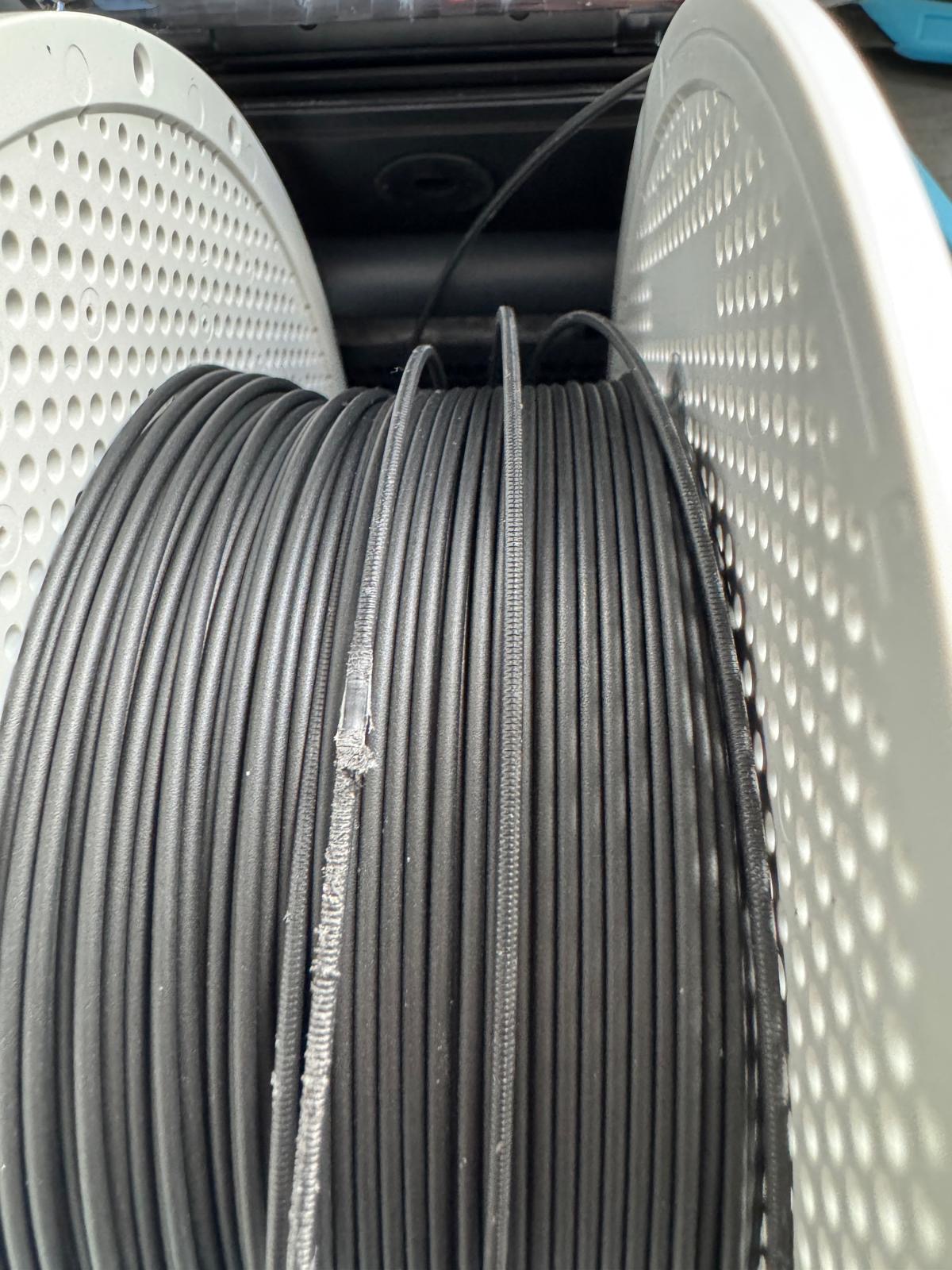

I am having similar issues. I don’t typically use the AMS HT for printing, but the reason I got it, besides high temp drying, was to print abrasives like PLA Glow due to its upgraded inlet. I just had a 4 out of 6 hour multicolor print fail on me because the first color switch failed and continued to fail. I tried just about everything, but it just kept loading so close to the extruder, and then the motor in the AMS would seem to give out and even give out a squeal maybe a centimeter from the extruder gear. I tried bypassing the hub, I tried shortening the tube, I tried cutting off the filament it was using (because the gear in the AMS was actually chewing away at the filament where it would get stuck), and I tried switching hub ports. Nothing. I reluctantly had to stop the print. I moved the spool to my normal AMS, and it loaded and is now reprinting without a problem, as expected.
This has to be some sort of issue with either the AMS HT or the AMS Hub or a mix of the two. Hopefully Bambu finds that it is a software bug and this can all be repaired digitally but as of right now I almost feel like my AMS HT is not what I ordered nor what I expected from Bambu.
