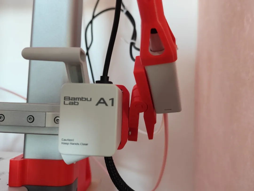

Hello everyone, let me share my experience with this ams (ams 2 pro, but it is the same for ams ht).
Printer: A1
Using the original tube length, when the head is fully to the left (filament loading position), the tube bends, often causing the “filament stuck/AMS motor overload” message.
I solved the problem by keeping the standard tubes, but adding free rotation to the hub. You can find the model of the hub support here:
