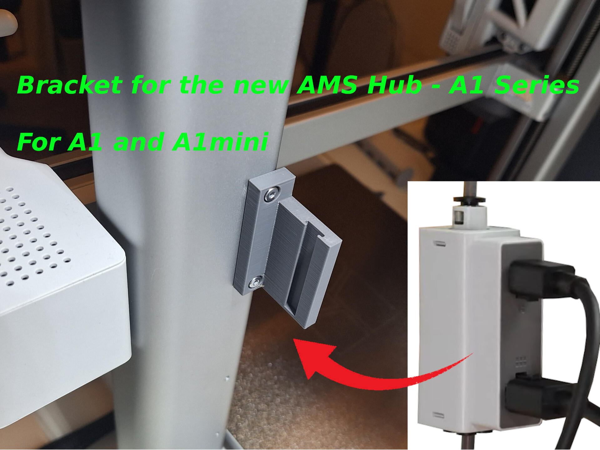

There is a mount for the buffer on Maker World. It mounts to the top bar, so it won’t move with the Z-Axis. I have not tried it yet, but as soon as my current print finishes, it’s next. I’ve had five or six jams at the single outlet on the hub in only the 5 days I’ve had it, so I hope that fixes it.
I’ll have to look at that mount
Don’t know if you are referring to mine, but I made a series of brackets to mount the hub on A1 and A1mini frame:
I did run across yours. I like it. My printer did not have the holes for the screws. Bummer!
Oh, wait! I rechecked and I do have the screw holes! Got it downloaded and will print tomorrow. See if I have those screws in the stuff I have packed away and save a trip to the hardware store. :smiley:
Not even the lower ones for the A1 “stiffener” ? I updated it to support those too.

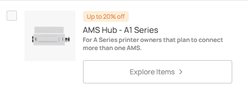

Would it be correct / possible if I buy the “Bambu Lab AMS 2 Pro Upgrade Kit” for the AMS? The hub contained therein allows the use of up to 4 AMS (I currently do not need it) and would be immediately available, contrary to the “AMS Hub - A1 Series”.

So if you wanted an A1 and an AMS 2 pro or even an AMS 1, you’d have to order the printer alone, and order the AMS 2, and order the A1 hub.
The A1 hub is not linked to from the A1 pages or the AMS 2 pro page yet.
But if you type “A1 hub” in the Bambu store search box you find it.
Usually the AMS 2 and 1 have a significant discount when purchased as a bundle with a printer so I expect that will appear in due course once they have enough stock of the hubs and the printer firmware is out of beta.
Right now the AMS’s are on sale for a very extended Black Friday so it’s got a decent discount until early December
This is the problem:
When buying an AMS the hub states on the store page it is only needed when connecting more than one AMS but that statement is inaccurate. The AMS Hub for the A1 is required to convert the 6pin cable connection to a 4pin connection through the hub.
