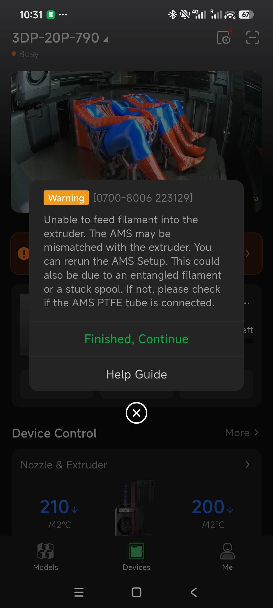

Hi, does anyone have had similar feeding problem with None-Bambu PLA rolls?
The issue goes in cycles:

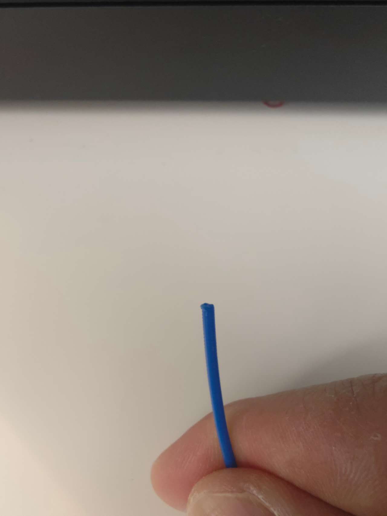

Prints would stuck during printing, had to pull out the fillament from the AMS; The tip of the fillament wire would have a small mushroom shape that stops the feeding.
I used sissors to cut the tip clean, feed it into AMS manually, hit resume to continue printing for a while.
20 layers, or could be 50 layers later, same issue again and repeat.

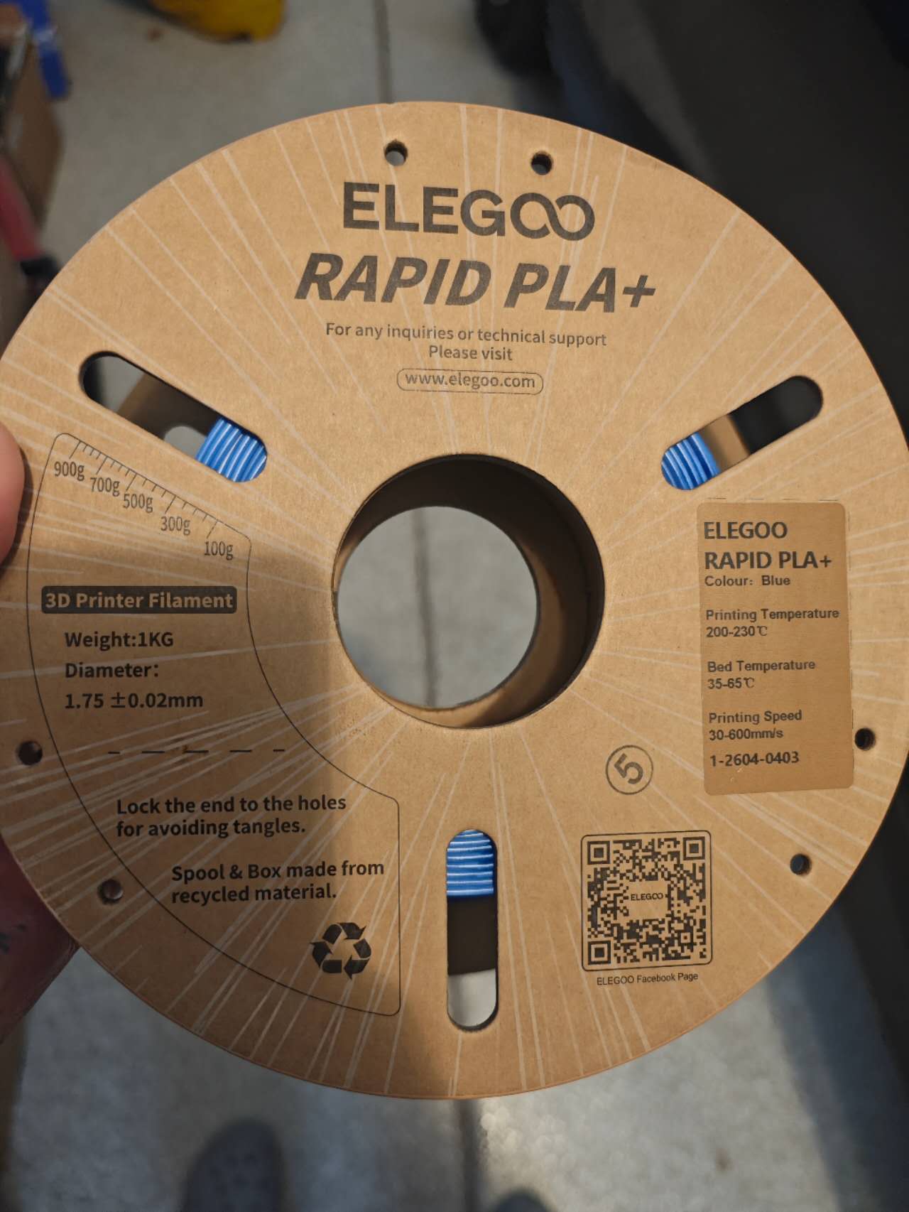

  1. I was using Elegoo PLA, and Overture. Because they delivers over night(Amazon) and I needed that speed.

I would check the filament unwinds from the roll smoothly. Sometimes the winding is too tight and the AMS can’t pull it out. Also for non-Bambu spools, check it spins freely on the AMS rollers, sometimes the spool shape is weird. For cardboard spools also check the cardboard rims are not damaged.

I’ve never had good luck with cardboard spools except on the AMS Lite where the spool doesn’t matter as much.
I have more Sunlu filament (spools) than I do Bambu now. I have also printed a few spools that are available on Makerworld. They are all plastic. No issues with feed.
There are plastic rings available on Makerworld for all the cardboard spools. These keep the cardboard from wearing against the AMS rollers and producing debris.
