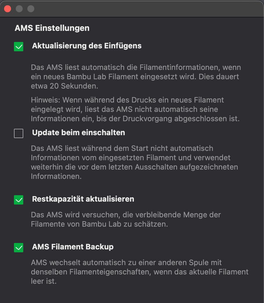

Hi everyone,
I’m running 3× AMS units on 3× P1S (one AMS per printer). A while ago, all of them suddenly stopped auto-detecting filament information, and I haven’t been able to fix it since. They all run with the same software version because I updated them together.
Here’s what happens:
The AMS does recognize that a filament spool is inserted and pulls it in slightly to adjust. But then it stops — it no longer rotates the spool or tries to read the RFID chip. This happens with different Bambu Lab spools (with RFID chips), on different AMS units, and in different slots. There is not a single case or combination in which in behaves as intended.
What I’ve already tried:
Checked Bambu Studio settings (detection for newly inserted filament is enabled). Reset everything, reinstalled Bambu Studio, unplugged AMS units.
Opened a support ticket, but no solution so far.
I also noticed that I can manually force detection via the circular button in the app or in Bambu Studio — that works. But as far as I know, the AMS should automatically rotate the spool and attempt to read the RFID whenever a new filament is inserted. Am I misunderstanding how it’s supposed to work, or is something wrong with my units?
Any help or tips would be greatly appreciated!
Thanks in advance :pray:

I know this isn’t going to help, but I am having the same exact issue with my one and only AMS (version 1). I am on the latest firmware and software. I have rebooted it, cleaned it, checked all the connections, etc. Also I have confirmed the auto detect filament check boxes are enabled as the OP shows above.
I have the same symptoms. After insertion the spool, it only spins about 3/4 turn, none of the slots recognize any of my Bambu rolls. Also I noticed with the non-Bambu rolls, the AMS no longer pulls the filament all the way in and out.
I am almost certain this started with one of the last two firmware updates. Otherwise the printer works perfectly with the exception of me having to manually add the type of filament used. As a side note, syncing filaments in babmu labs now takes 2-3 more clicks, so what’s up with that?
If anyone has any fix or suggestions please let us know. I have opened a ticket with BL, but no response name two days in. Thanks!
