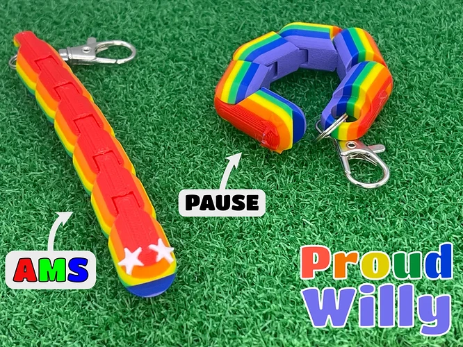

Now, hit print, wait for the first PAUSE and get ready to swap.
When this issue (before going nuts on additional AMS units), I would get the filaments ready in piles near the AMS so I could grab the correct one for the next PAUSE.
A simpler example of the solution above for 5 colours using a 4 colour AMS can be found in an earlier solution I provided to others (more than once).
A profile I made for this designer:
I also made many for my own models:
