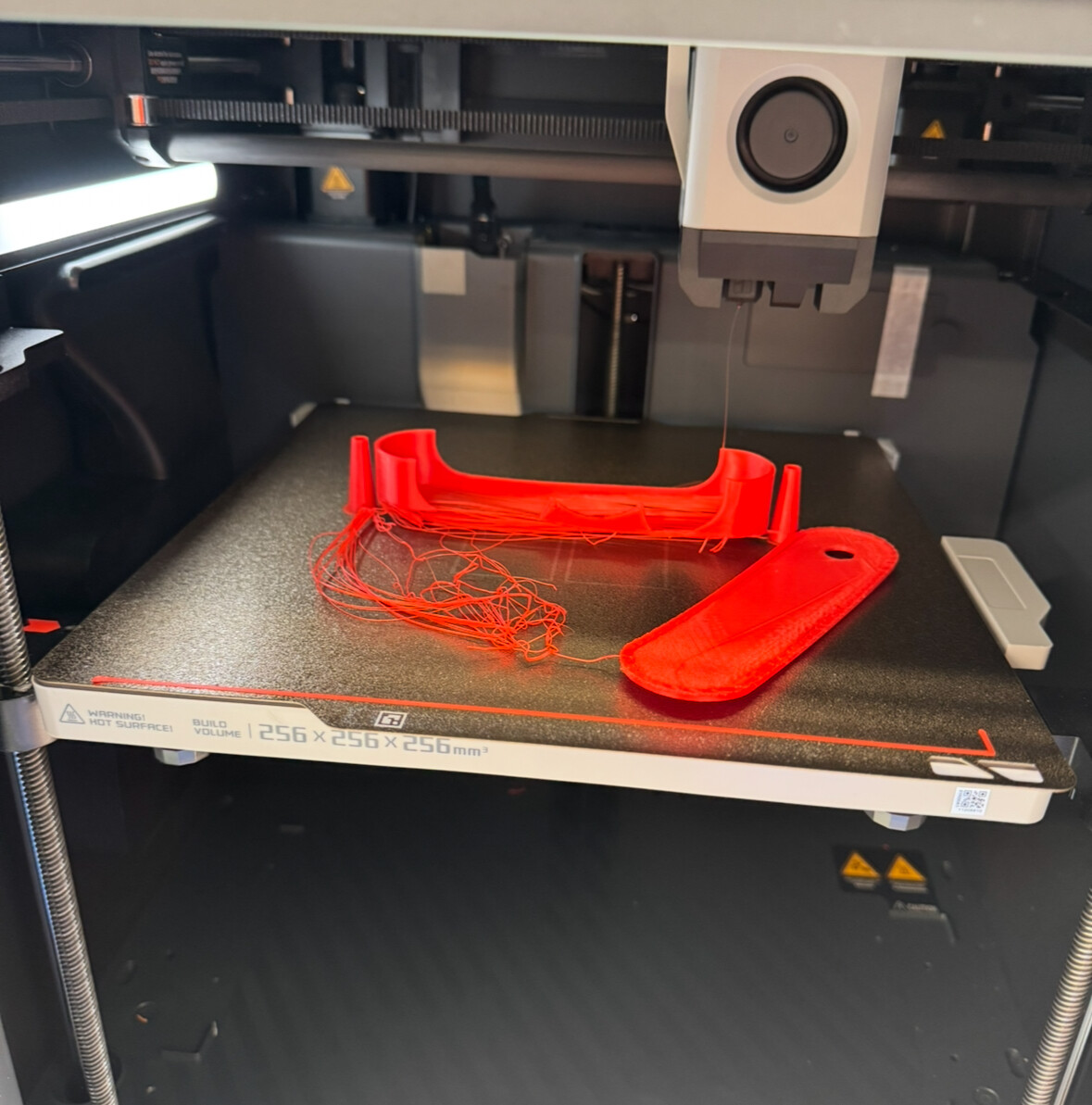

New to printing, after 300hrs of successful PLA and PETG prints with no issues, I tried my first ASA print and ran into trouble.
Freshly opened ASA filament pack
Dried at 65° for 5hrs (highest temp my dryer goes)
Loaded into AMS on P1S, stock 0.4mm SS nozzle.
Bambu studio recognized it as ASA
Chose it for the object, chose 0.2mm standard and pressed go.
I did not alter any of the stock settings.
As you can see it failed.
Bottom few layers seemed ok, then it unraveled and somehow continued printing.
Curiously the support tree stayed put.
Not expecting problems, I did not monitor the print to see what temperature things got to.
I have no idea what to change before I try this again and would appreciate any guidance.
Thanks
You should always add a Brim with ASA…6-10 lines at least…or it will warp.
Also, turning off the cooling fan helps. If BS saw it as ASA, then the fan was probably already set to off or a very low speed.

If you’re print with Bambu filament, the stock profile shouldn’t need tweaking if you have a clean enough bed. Dish soap and hot water. Really scrub at it with a clean brush and pat dry with a paper towel. I add a brim with zero “object-brim gap” for long parts or ones with a high wall count.
You won’t be able to heat the bed past 100c with a P1S.
If the print comes off are you added a Brim, you will have to use Glue.
Filaments that require an enclosure (ASA, ABS, PA, PC, etc) generally also require pre-heating the closed chamber.
Manually set the bed temperature to at least 100°C, and run the auxiliary fan to circulate the air. Wait for chamber temperature of at least 45°C and then wait at least ten minutes more before starting the print.

Personally I had terrible adhesion when using IPA to clean with and trying to print ASA/ABS but others it seems to work okay.

I made the following changes and had a successful print.
Anything else that was recommended and I didn’t implement was because I could not find where to make the edit.
Not sure which was the important change, but i’m not concerned as long as it worked.
Washed plate with soap and hot water
Preheat machine using LCD on the P1S to bed at 100 with aux fan on
Added a brim to the part
Global>Others> Brim type Outer
Brim width 10mm
Brim-object gap 0
Set Global>Speed>Initial Layer set to 20mm/s
Set Global>Strength> Sparse Infill> 15% density (from 25 with failed print) Gyroid
Set Global>Quality> Layer Height> Initial layer height 0.1 (from 0.2)
I will carry on with these settings for ASA from now on
