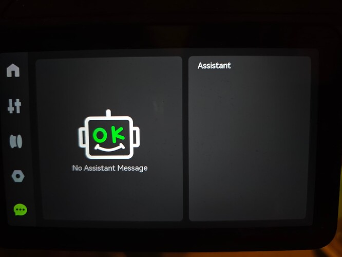

its kind of useless to have an “troubleshooting assistant” that you take you to an empty page
it would be appreciate if the assistant could assist

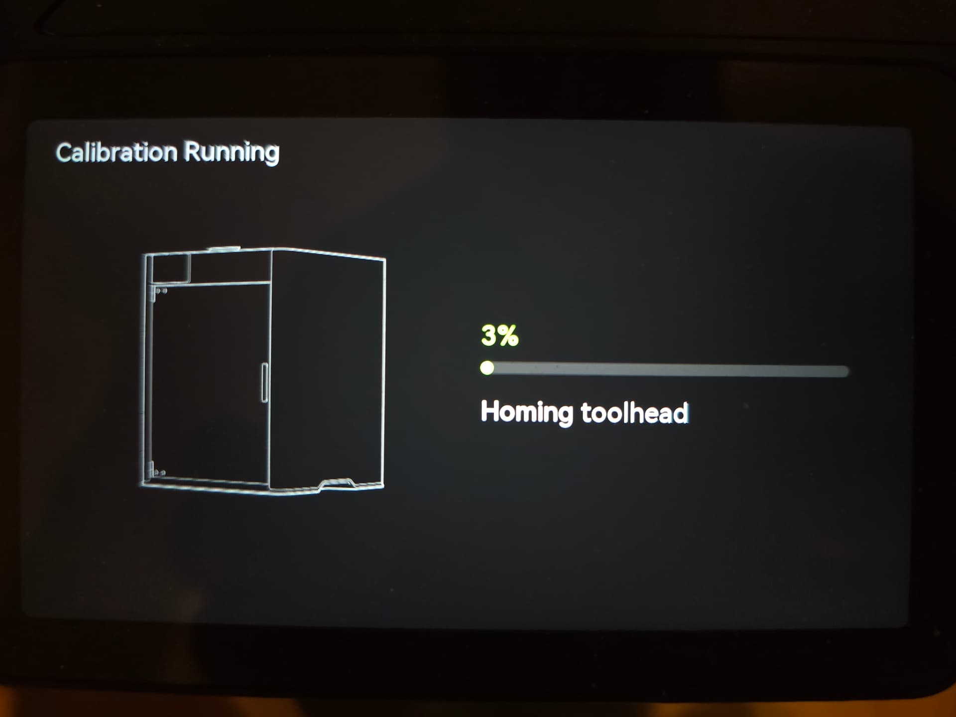

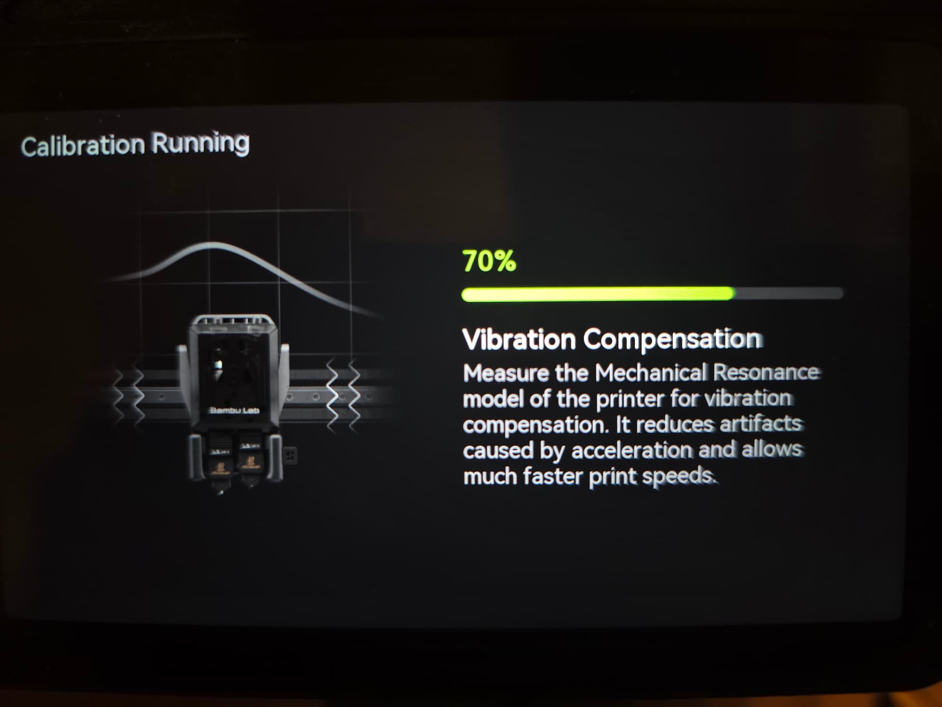

never mind found it, getting back to factory setting

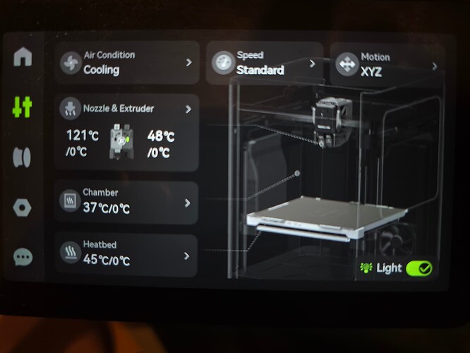

fun fact about this is this message,
telling you that you need to have the chamber at 35 degree…right now its winter but how do you do this when its the summer and its 36 ?
doing full defaut calibration i hope it work this time

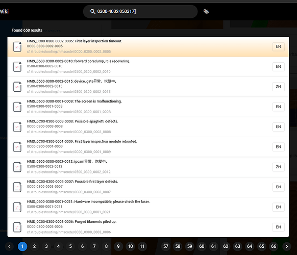

i can’t believe this is the go to method on a 2000+ euros printer, why…just why out of curiosity ? what is the purpose to have a assistant within the program to resolve issue…if it just CAN’T ??
also why give an error code that doesn’t give you a page on the wiki, well my bad, it does get thousands of pages…but none that are useful to resolve an issue
658 result and i am not even sure the code is in them
