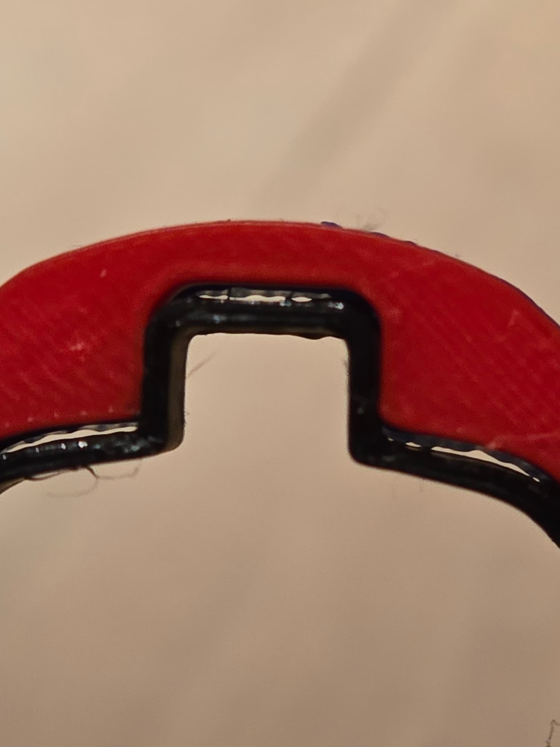

For some reason, my prints seem to be slightly out of sync, leaving small gaps (a few millimeters wide) where there shouldn’t be any.
there shouldn’t be any gap between the RED and the BLACK, and this issue only happen on the same spot, redid the print 3 time, get the same issue in the same spot
The file itself is fine, there’s no issue in the preview, and I couldn’t understand why.

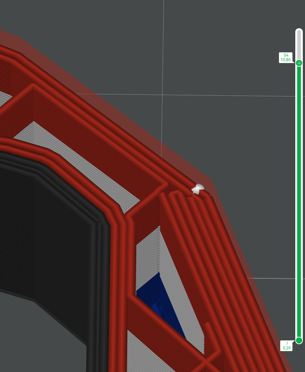

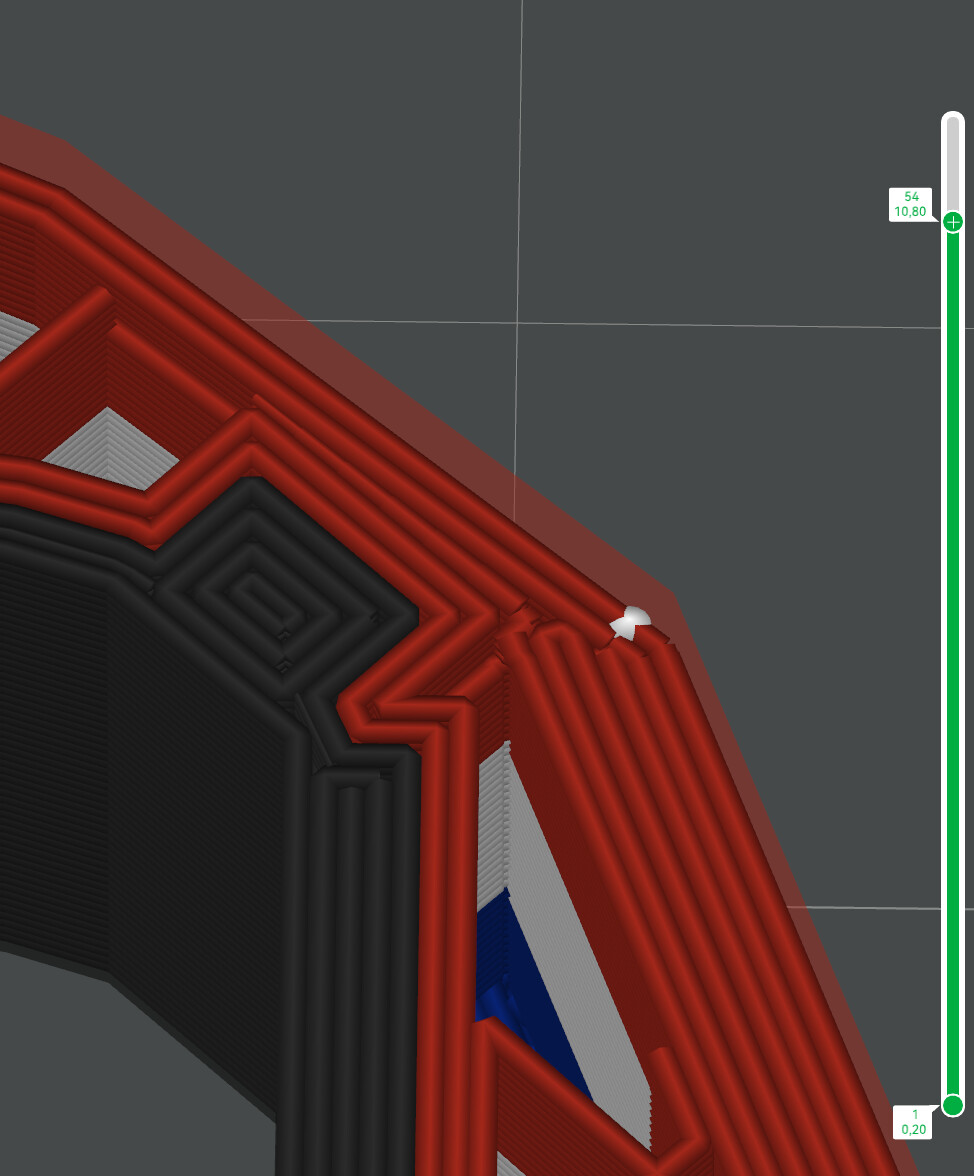

because of issue number 2, i though something might be wrong with the file so i decided to remake it, i imported all of the STL and guess what…this time all of the bits where thereonce i sliced the file …what in the world is going on …it didn’t do anything with issue 2 but the file was complete for once…so know detective work…why ?
since working and non working file where made with v02.03.00.70 , i thought 70 is the culprit so this is when i dowgraded back to 56, i open the working file made with 70 and it still was ok, remade the file again…and this time not working, missing bits…i was really losing my hair at this point.
but has i open working saved and non working save with 2 instance of studio to so if i was missing something i realised…the placement of the part in the list is not the same !!!
if i place the STL that has issue on the bottom…it slice fine, if i place it 1 part up…its not, and there is no logical reason to this, i don’t move them around on the virtual plate, i just change the position in the list…that doesn’t make any sense !!!
here are screenshot
part with issue NOT at the botom of the list
part with issue AT the bottom of the list
