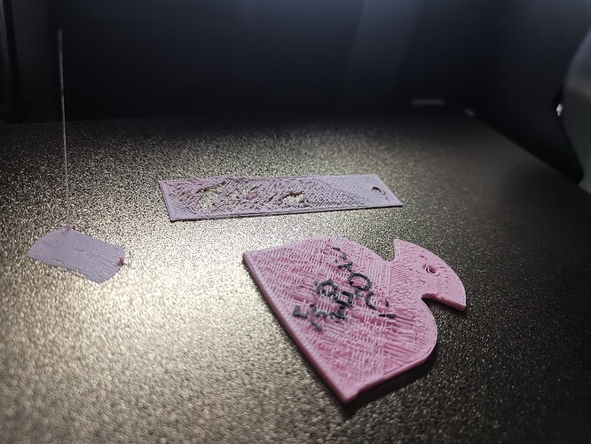

Hello all :wave:
During the printing of a simple keychain, the extrusion deteriorated significantly in the middle of the print.
I cleaned the hotend (nozzle at 220°C, removed trimmed filament from the hotend using the needle pin, and manually pushed filament through).
The test print after cleaning exhibited the same errors.
The filament being used is the Matte PLA from Bambu lab.
Does anyone have any further suggestions for me to resolve this issue?
Thanks to all :slight_smile:

Thank you for the information.
The printer has been in use for a few months.
The issue happened suddenly; before the error, I printed other models without any problems, including a model that took over 30 hours.
Based on the extruder’s sound while feeding the filament, I initially suspected a clogged nozzle and cleaned it as described in the initial post.
There are no apparent issues when manually feeding the filament directly at the extruder.
However, when the printer loads the filament, it sounds like the gears near the extruder are having trouble gripping the filament… it rattles as if the gears are skipping.
Using the needle, it may very well be that the original contaminant is still in there. That makes life difficult for the extruder.
I usually go straight for the cold pull using an Allen key. A bit fiddly, but more reliable than the needle.
Try drying the filament and then clean your nozzle and try again.
I cleaned the nozzle again using the pin needle and did a few cold pulls.
So far, the printer is working wonderfully again :slight_smile:
Thank you to everyone who helped me! :smiley:
