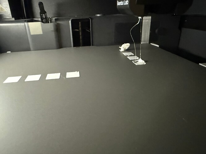

I have just installed the my new nozzle and I am having serious issues with it. I am guessing I am one of the few since I can’t see any similar issues that have been posted on the forum.
  1. During the preparation stage e.g. levellings, nozzle wipe etc. the nozzle is oozing a hell of a lot of filament, then what happens is during the bed levelling it is sticking to the nozzle and doesn’t get wiped off prior to the print stage.
  2. As with #1 during the print stage as the nozzle is trying to print and the filament being collected prior to the print stage is now landing on the print bed and messing up the print.
  3. I am using Bambu Lab’s print configuration setting taken directly from the website.
  4. Currently using Bambu branded PLA matte but also having issues with PLA Basic. Not tried PETG yet.
What I’ve tried so far:
  1. Turning the temperature down to 200, no joy.
  2. Amended the override settings for retraction based on other reseach. This reduced the nozzle oozing a little but not much.
  3. Filament humidity is sitting around 35% which I understand is acceptable for PLA.
Attached photo of the latest failed print when trying to print gridfinity boxes.
Any suggestions?

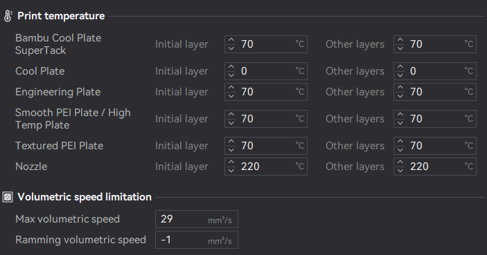

Your nozzle issue notwithstanding, you may want to rethink your choice of filament for Gridfinity.
Two questions. First, how did you determine that the filament humidity is 35%? At that level, it would be a slurry. Second, be aware that both Bambu Matte and Silk filaments are notoriously sensitive to moisture and, even when factory sealed, should be dried despite what the website claims.
If you’re using autocalibration or the original filament profiles, keep in mind those profiles are over two years old and were never properly updated. That’s a recipe for bad results. Manually calibrate the filament instead. To rule out moisture as a factor, weigh your filament, dry it, and weigh it again.
Here’s an example of Bambu factory-sealed Silk PLA from a year ago when it was still offered. This is why you should never assume “factory-sealed” means safe from moisture:
Guess which one was dried and which one was wet? I’ve seen similar issues with Matte, which is why I rarely use either.
One more note: if you’re making a Gridfinity grid, you need stronger, more durable filament such as PETG, ASA, or ABS. Silk and Matte are appearance filaments; they don’t wear well. For Gridfinity, you want a base grid that holds up under use. Even regular PLA would be a better choice.

In my experience, OEM filament profiles are unreliable. Just last week I downloaded a profile for a new TINMORRY filament and the flow rate was way off - it showed immediately in the calibration. This is common across the industry. Bambu is no different. They changed their filament contract manufacturer last summer, and soon after, reports of bad filament surfaced in this community. Eventually people realized the profiles needed updating. In many cases, manual calibration still outperforms factory profiles.
This is a common pitfall: trying everything at once and losing track of what actually made a difference. One of my earliest mentors drilled this into me: “Rule #1 of troubleshooting: change one variable at a time.”
In your case, revert the printer to the last known good state, then move forward step by step. I had to do this recently when I bought my first 0.2 and 0.8 nozzles. None of my profiles - including Bambu’s factory ones - worked well until I tweaked them. It was a good reminder not to assume that what worked last week will work this week. :wink:

Alas, I may have found a solution that solves the issue of filament clinging to the nozzle… need to do some more testing to make sure it’s not a lucky print or two but I will report back later this evening with an update either way.
Now I’m curious what you have found :grin:

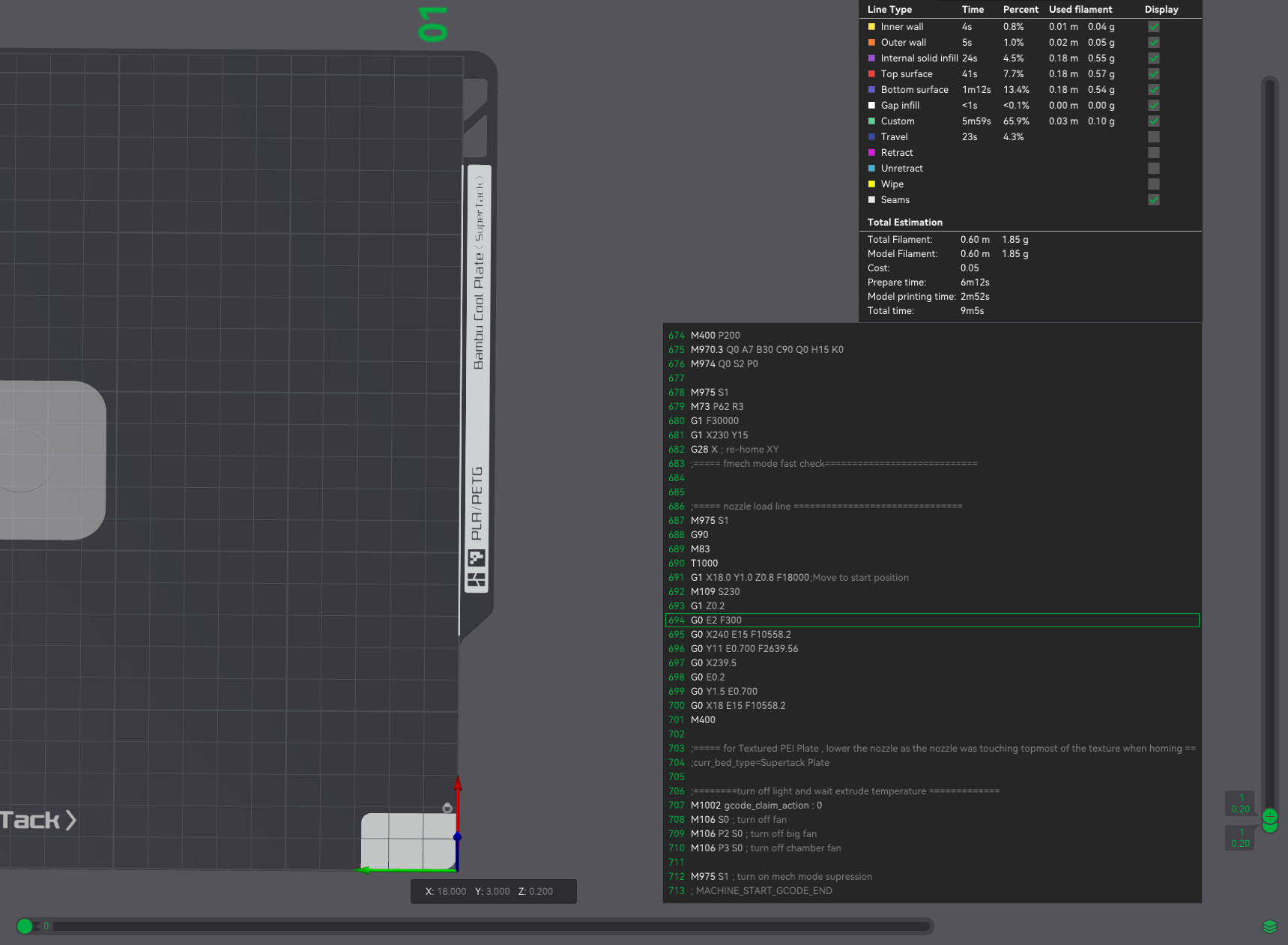

So over the last 24 hours I have tried numerous settings and options in Bambu Studio including nozzle temp but to no avail. It turns out that any real changes need to be made in the Machine G code printer settings.
Apologies if you know how to access the G code but just in case others read this, it can be done by clicking the edit preset button > Machine gcode.
Screenshot 2025-07-29 235632
I’m still an utter newbie at 3d printing and have only learned from what I have researched, so anyone wishing to modify the gcode does so at their own risk! I suggest you save a separate test preset and keep the original settings in case you need to revert back to them
@Alex_vG If you are going to modify anything, I think the following settings are the ones you probably want to fiddle around with:

This section of the code relates to the two purge lines before the printing begins.
My overall findings so far is that the I have largely been able to reduce any blobs or stringy filament stuck to the nozzle although not always, but having much larger success than before and I am not sure if there are the perfect settings but I will keep trying although I might have to settle for just ok.
If it helps, here are some of the things I have done so far:
  1. In the Nozzle Wipe section, the “M109 S140 ; wait nozzle temp down to heatbed acceptable” reduced to 100 degrees I feel is too low. Somewhere around 120 degrees seems appropriate to reduce any excess oozing.
  2. To help minimise excess oozing, you should also consider retracting the filament so that as the nozzle starts to heat up and get into position for the purge lines there is minimal oozing. To do this, before (or after) the line mentioned in #1 insert:
G1 E-X F300
Where “E” refers to the extruder, “X” refers to the mm you wish to retract and “F300” being the speed of retraction in milliseconds. I can’t remember what setting I had as Ive messed around too much but somehwere between 5mm-10mm reduces oozing by the time the nozzle hits the purge lines. You can also retract in decimal such as 1.5, 0.5 etc. Be careful not to retract too far back it ends up out of the nozzle itself.
  1. In the nozzle load line section I have discovered that “G0 E2 F300” is the culprit for creating the blob at the start of the purge lines. You could set that instruction to ignore by using the semi-colon “;” and it should start extruding the purge line as usual. Be careful because if you set this to ignore, the printer may run at the last known speed and have unexpected results so to counter that you coud add the F300 to the next line.
A little tip is that if you slice the model you are using in Bambu Studio and set both green bars to 0 (sorry I don’t know what these are called , you can use the bottom bar to cycle through each line of code of the purge lines that is being applied. This is helpful if you want to add more purge lines or space them out (see my next point).
  1. To help reduction of blobs or filament sticking to the nozzle after the purge lines, I have set the initial extrude blob to ignore (G0 E3 F300), widened the purge lines, added 1 purge line more and set the speed to 300ms for the first purge line using the code below. This along with/without retraction settings has helped me with good testing success as the slow speed eventually cuts off any sticking filament prior to printing. You may want to increase or decrease the speeds for one or more lines depending on your successes. The bold section is the modified part for and additional purge line.

;===== PRIME THE NOZZLE WITH TWO LINES BEFORE PRINTING MODEL =====
M975 S1
G90
M83
T1000
G1 X18.0 Y1.0 Z0.8 F18000;Move to start position
M109 S{nozzle_temperature_initial_layer[initial_extruder]}
G1 Z0.2
G0 E2 F300
G0 X240 E15 F{outer_wall_volumetric_speed/(0.3*0.5)     * 60}
G0 Y11 E0.700 F{outer_wall_volumetric_speed/(0.3*0.5)/ 4 * 60}
G0 X239.5
G0 E0.2
G0 Y1.5 E0.700
G0 X18 E15 F{outer_wall_volumetric_speed/(0.3*0.5)     * 60}
M400
;===== for Textured PEI Plate , lower the nozzle as the nozzle was touching topmost of the texture when homing ==

Temp settings below. Mainly tested at 220 degrees for PETG but have tried 230 degrees and appear to be no issues either after several attempts. For PLA Matte I also tested at 220 degrees with no issue.
wow, those are very good findings. When i asked for these settings, everyone said that this is buried in the firmware. And instead it all sits neatly in the machine gcode.
Thank you very much for taking the effort. I have aleady bookmarked your post!
And even greater that you managed to reduce those problems. :grin:
Nice contribution to the community. Thank you. I’ve also bookmarked this.
Cheers both, I was ready to throw in the towel and already raised a support ticket prepared to send the thing back. It so happened that my last few attempts focused on finding a temperature to stop the initial oozing once the fan kicks in at various points and working out from there.
Now I can finally start the calibration process and hopefully my testing is not just a one-off so I don’t have to watch the printer like a hawk :rofl:
If I discover any more useful findings I will edit and update my post.
