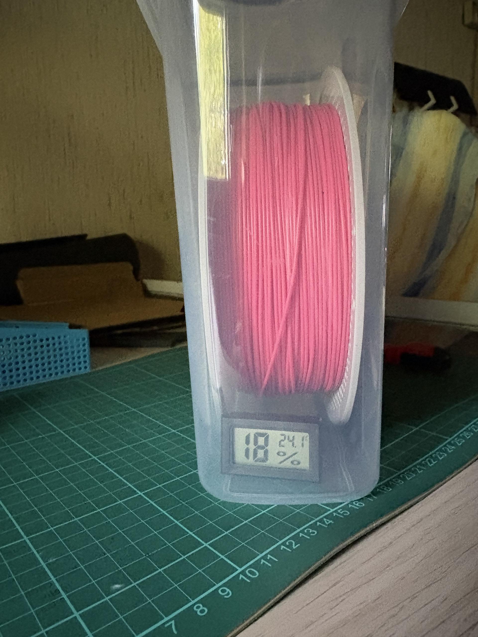

I did not want to waste any more efford in a faulty filament, but ok, I just added a hygrometer to the box (silica was already there) and report back with the number in one or two hours.
But even when it is dry, it spend 8 hours at 50°C in the dryer. How long it should be dried then?

And any desiccant in there ruins the measurement. Take the desiccant out and restart the clock. What your hygrometer will read is the humidity value of the desiccant and that swamps the humidity value of the filament.
Desiccant is much stronger at controlling humidity than filament. But between filament and air, filament is stronger and its humidity will assert over whatever ambient air is in the bag.
Oh, I did not feel like you called me an idiot. It is more a german saying to say: Of course I did that. So, no offense taken here. Sorry, if that was not clearly.
Indeed I have silica gel in the box. I have taken it out and wait for the results. So far: With silica in the box it shows 26%. Lets wait for the numbers without the silica.

Will be curious. For my system that’s high for PLA and my prints would show some level of water issues. That silica gel should be regenerated before using it with filament again.
The reason is silica gel holding water is reversible. It gives up water in a more dry environment and picks it up in more humid ones. Pack that silica with a spool and if it was dry before, the silica gel will increase the filament’s moisture content.

So, for the results, the hygrometer shows 18% rH inside the box. Without any silica inside. For simple PLA this is more than fine. So whatever the problem on that filament is, it is not moisture.
Just came here to see the result. 18% should be good. 25% is my absolute cutoff for PLA but it may be different for others and some water effects can also just be tuned out.
But I don’t see any real problems with that number and you have another bullet point to use with Bambu if you talk to CS again.
Added - I’ve had problems with pink PLA before but it was before I sorted testing so I don’t know why. It could also be pink is just a tough formulation to get to behave. But I can’t say for sure. 18% should at least print and the other filaments printing properly still point to the spool of pink having some kind of issue, at least to my thinking.
