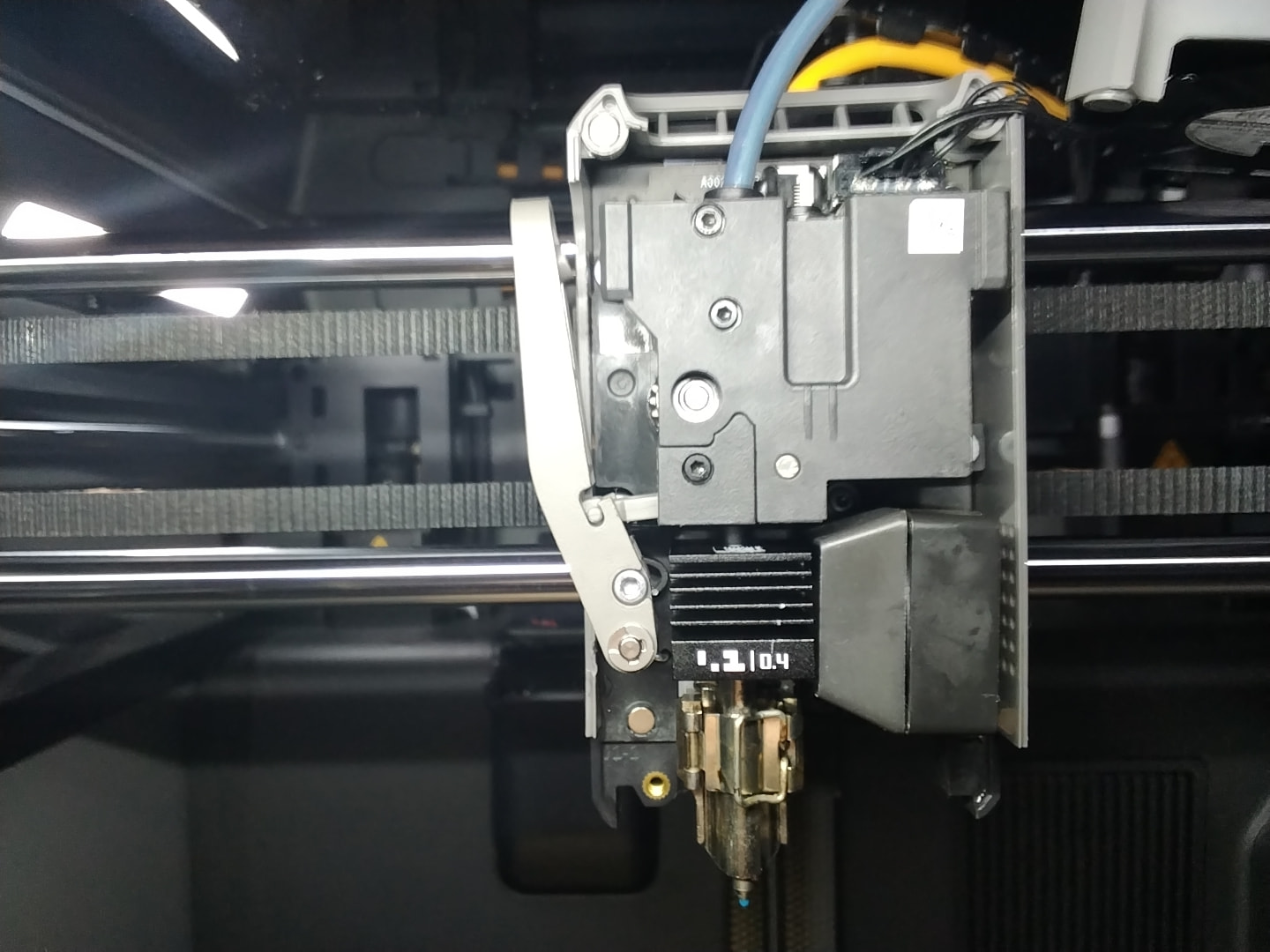

Hi, I’ve been having some trouble lately with my relatively new P2S. It all started with a simple case of wet filament, then an extruder clog that I fixed and now it simply will not extrude at all. I have taken the toolhead cover off to see if the indicator gear is turning normally and I found that when extrude is pressed, it twitches like it is trying to push but can’t, I have already taken the extruder apart and found nothing at all and the gears are running smoothly, and im using a brand new official 0.4 bambu lab nozzle. Im also using standard filament that I have used many times before. Also, the extruder gear will turn normally when filament in not loaded
If anyone has any ideas on how to fix this thing it would be greatly appreciated as this is my last resort before taking it to a repair shop and spending a bunch of money on it.
That little splat of grey filament at the inlet to the hotend is concerning - filament should never be melted above the heatsink.
If you take off your hotend, is that entire inlet all clogged up? If so, you need to remove that, I’d use a 1.5 mm allen key, heat it up with a lighter, then push it into the inlet, let it cool, then pull it out, repeat until you’ve cleared all the blockage, then reinstall and test.

Greasey / wet filament wont extrude because the gear will slip, your image looks to have blue filament loaded and extruding / oozing from the nozzle , go through the wiki to make sure everthing is correct
