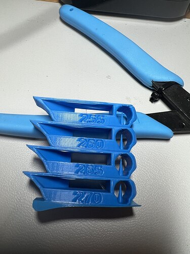

Anything between 260-270 looks to be good for the temperature. 255 had globs on the top side. I may bump up to 265 to try to help with layer adhesion.

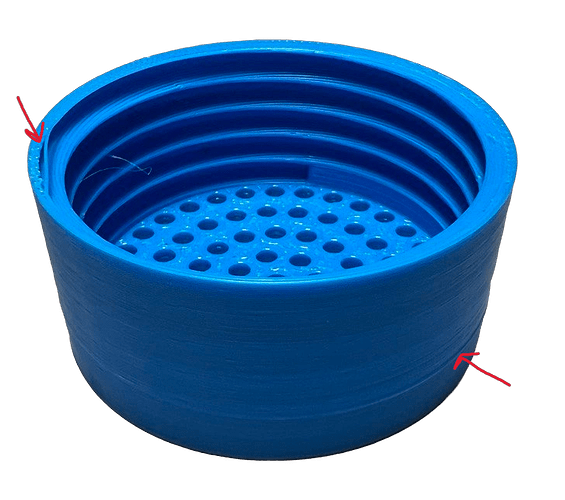

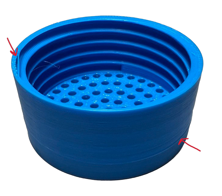

Much better results at 265C using Orca. I also slowed down inner and outer walls to 100 mm/s based on azCubs76 and I set the cooling overhang threshold to 5% like just4memike suggested.
There is one string at the top left of the image and also an imperfection along the outer perimeter. Overall I can live with this. Good to know about blue PLA being a pain. Maybe the pigment causes issues.

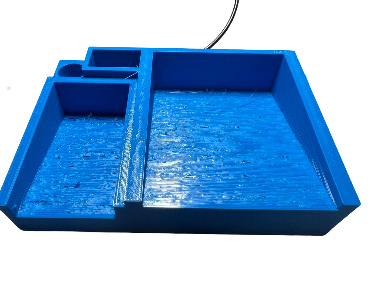

I attempted to print a little desk organizer with some large flat surfaces and got a lot of clumping. I was using 15% gyroid infill which does results it large gaps. When I attempted to use rectilinear I had a lot of clumps at the interfaces of all the infill point. I may have to give up on this filament.

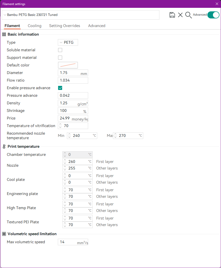

The Bambu PETG is a disaster IMHO. I tried printing some cardboard spool adapters for my AMS, and they were massively under-extruded and pretty much fell apart. I ran the Orca calibrations on it and got the following results:
(Note that the 260º first layer is an experiment based on this thread. I have not tried that yet - my old value was 255.)
With these settings, it prints decently. The Orca max volumetric speed test topped out at 14 which works as long as you don’t have any overhands or bridging. With the latter, you need to drop down the speed (plus the usual overhand settings). This is temperamental filament. I’m currently looking for non-critical projects to burn through my 2 rolls, then never again. Much less hassle to use eSun or Polymaker.

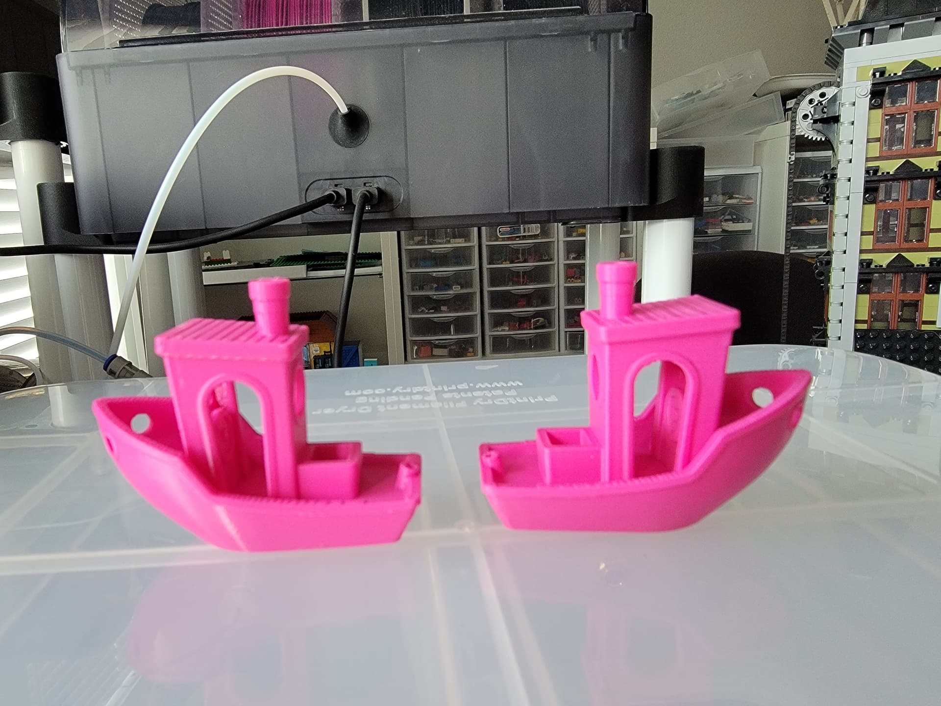

I had purchased eight colors of PETG when Bambu first released it but I had not used it until last night. I was getting worried, after reading this thread, that I had wasted my money.
So last night I took the so-called purple, and dried it for 3 hours and in my print dry Pro 3 and printed out two Benchy’s. Aside from changing the speed on the second print so that it would have a uniform look on the outside, I did not change any BL PETG settings.
Worked great for me.
