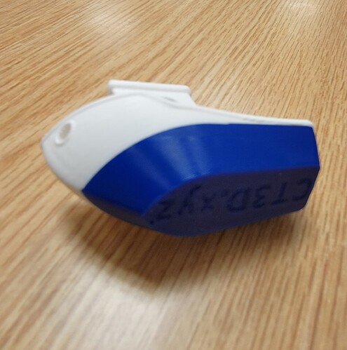

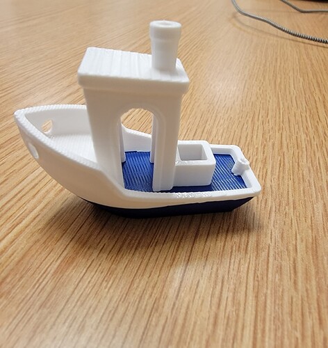

By using some of the signatures made previously on this thread, I believe I have successfully printed with the blue. The changes that I did not alter the performance of the white either.
Thank you to all of those who figured this all out before so that I had less trouble.

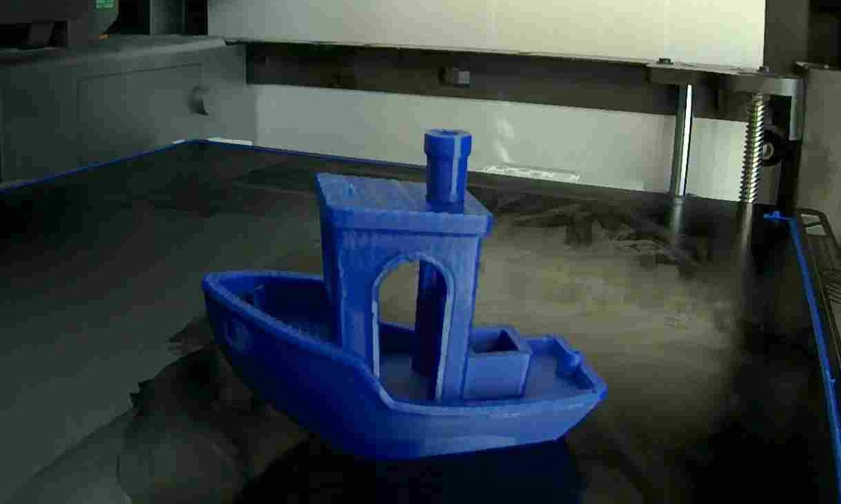

I just wanted to share my experience with Bambu Lab PETG filament and the P1P.
Just like the OP, I had the same horrible stringing (or is it layers separating?) when printing a threaded mason jar lid.
As it was suggested in this thread, I changed the default BL PETG settings to the following and got pratically perfect results:
  • printing temp to 265c
  • max volumetric speed to 10mm3
  • cooling min 40%
  • cooling max 90%
  • aux fan speed to 30%
I didn’t have any problems printing a 3D Benchy using the stock BL profile but for some reason I guess the stock profile is just not good enough for more complex shapes.
Big thanks to everyone who contributed! :smiley:

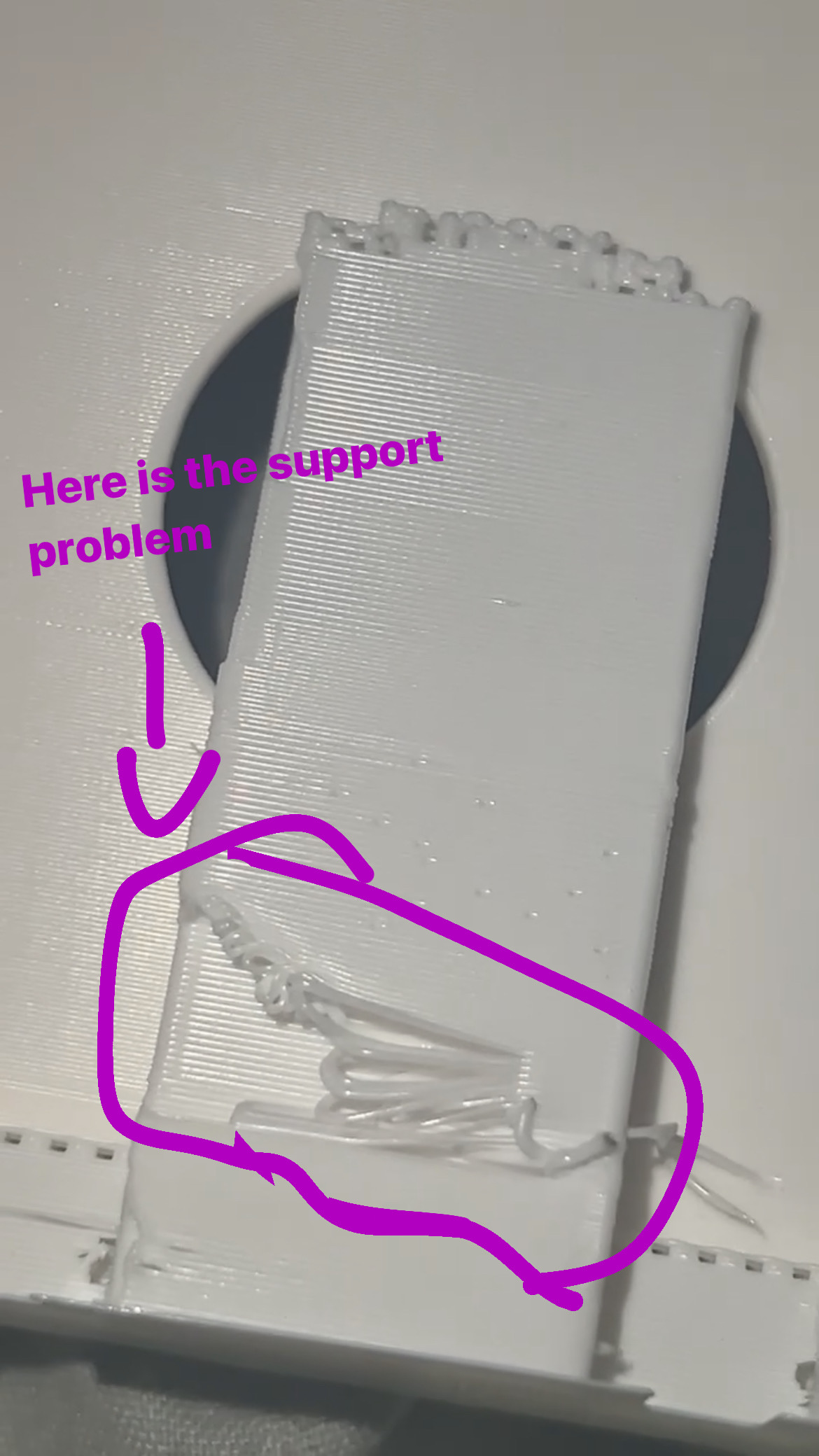

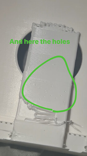

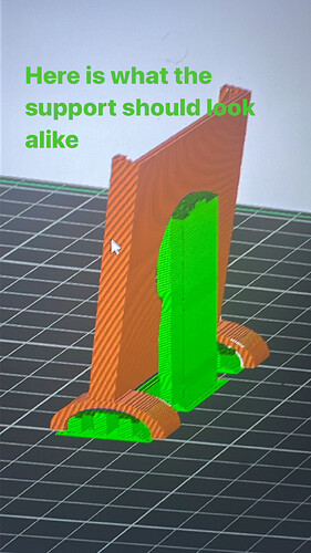

I use all the setting you just said and here is the result I don’t understand why there is a plenty of little hole and a part of the support is not looking really well
And yes I have dry my filament btw this is basic petg from Bambu lab
I really don’t khow what to do i read like everything in the forum you guys really look like you know what you are doing
@Gab44k If you tilt that model a few degrees to the left so the vertical part is straight up or even slightly tilted the opposite way, it would likely only need supports for the base. But you should slow it down as the piece might wiggle when the nozzle is near the top. Or tip it on its side and use tree supports for just the overhangs. Also, sometimes for aesthetics it’s better to split up models so you don’t need any supports and join them together after printing.
