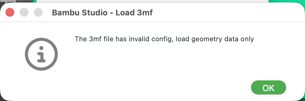

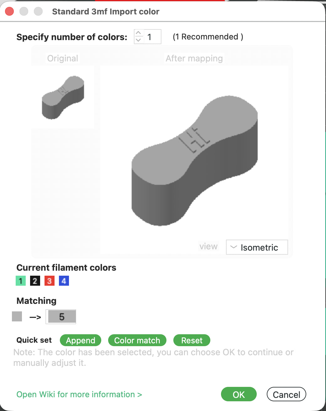

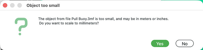

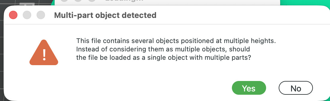

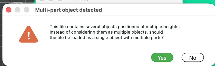

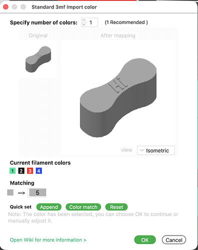

Why do we have to have endless dialogues, why can’t this be fixed? I’ve reported this on GitHub too, and numerous people agree, but there is just more and more dialogues on a 3MF imports. It used to just import with a single button from Fusion 360. Now it takes 5 DIALOGUE INTERACTIONS TO IMPORT A SINGLE 3MF! Literally, see the sequence below. NONE of which I can use the return/enter key, because there are zero key commands. So, when I’m doing multiple prints, I literally have to mouse click 5 TIMES for every single one!
It’s so stupid and solvable with a few lines of code. I NEVER, EVER use the color mapping feature, despite printing hundreds of hours on my multiple Bambu printers, yet I have to push cancel hundreds of times. So stupid and unnecessary! Please, please, please make defaults, or something to improve this process. I mean, this is just so unnecessary and it only gets worse with every release–just more and more dialogues. PLEASE FIX THIS!!!
