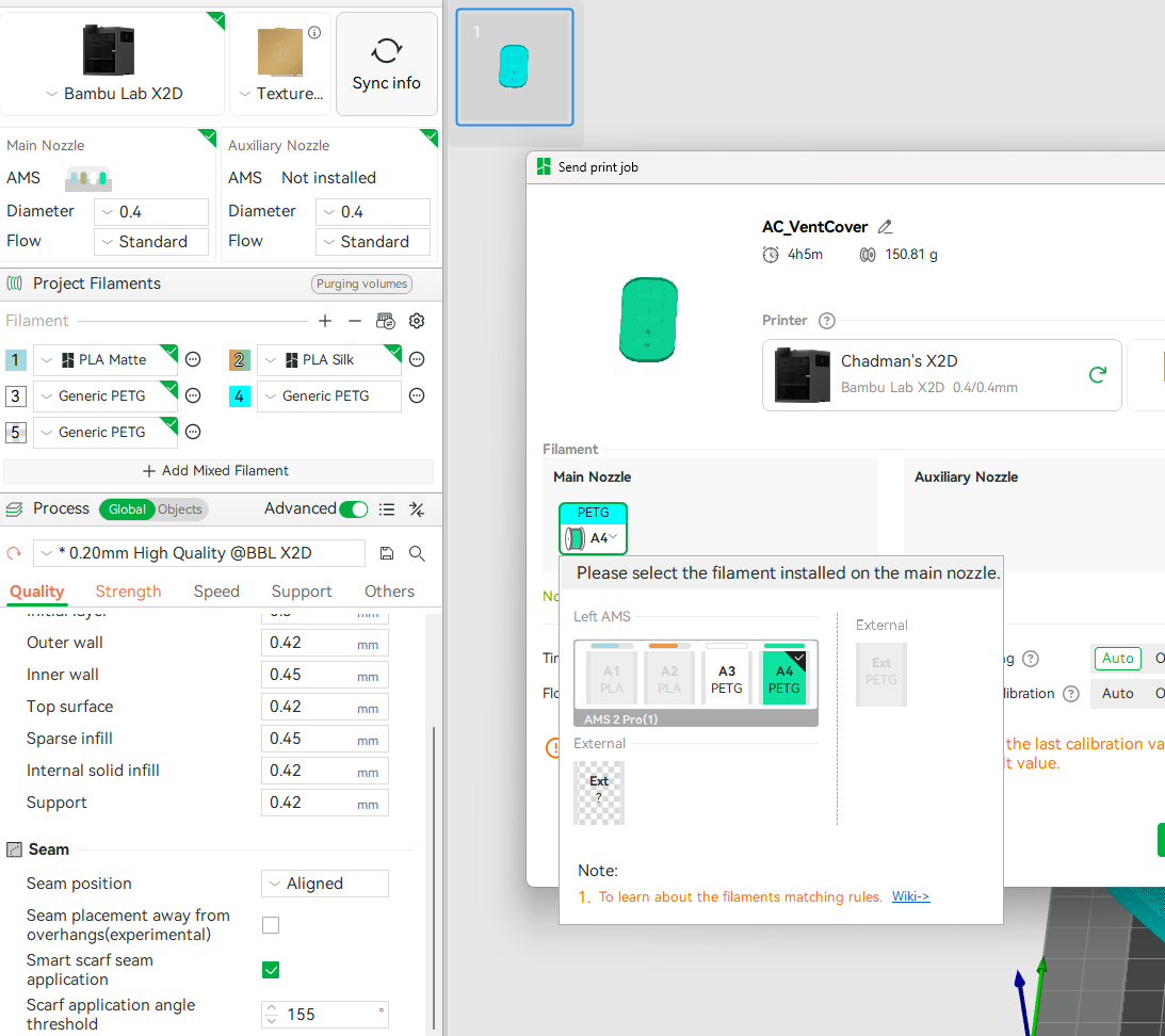

At ver 2.7.1.62 I noticed a minor bug were chosen custom filament color does not update on “Print plate” pop up.
