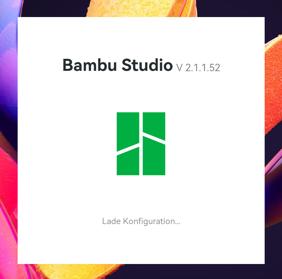

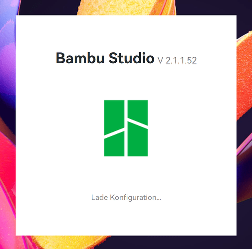

Bambu Studio crashes while it opens
Hi there

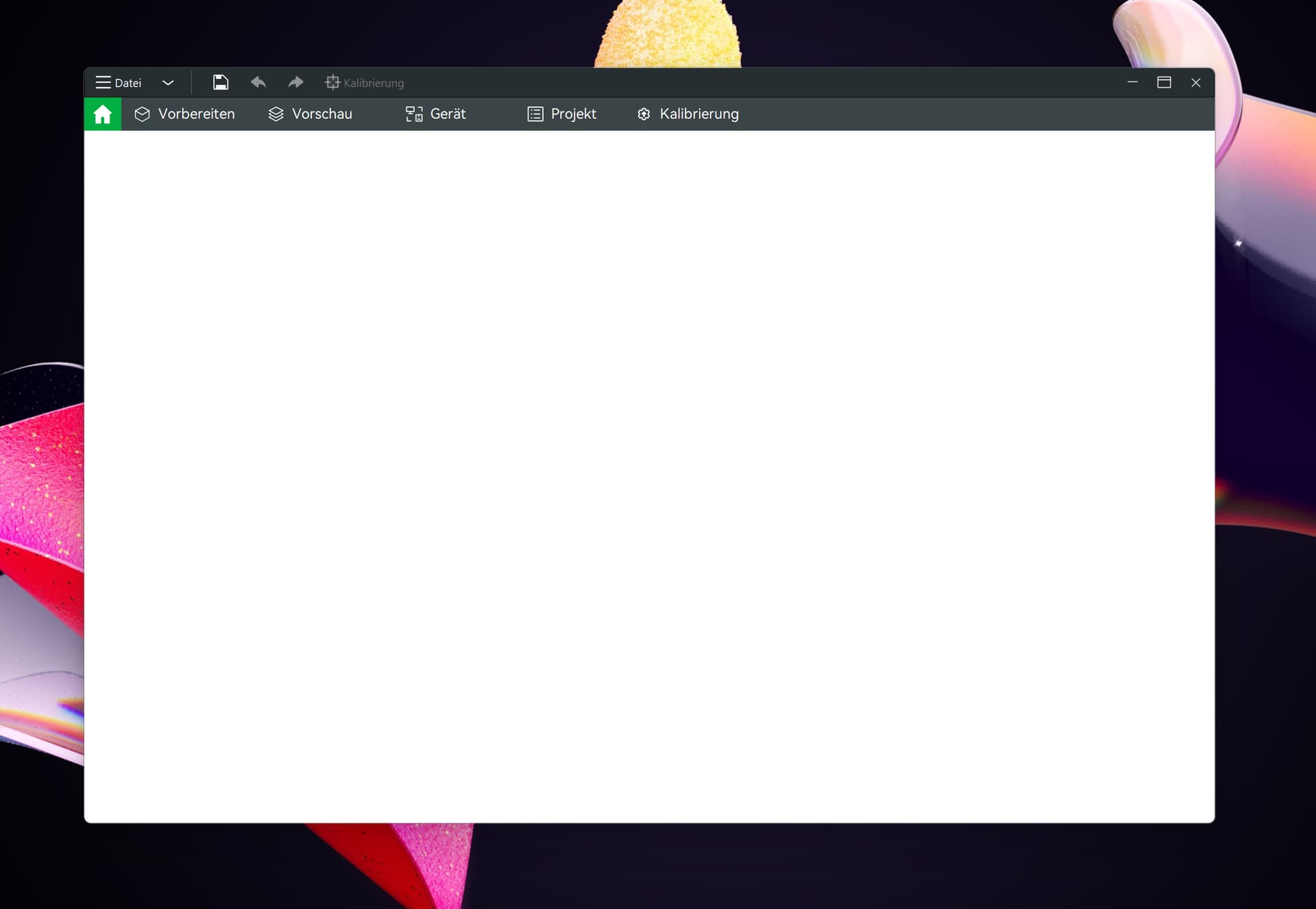

I have a severe problem with the Bambu Studio Software. When i try to open it seems to load up properly.
Then it opens the normal software window.
After 3 seconds it closes itself without any crash massage. The current software version is 2.1.1.52, but i tried other versions like 2.00.03.54 and 2.00.01.50 . There was another thread here with a similar problem but the sulution they came up with doesnt work for me (Bambu Studio (various versions) crash on start).

Similar issue but mine takes about 45 seconds to open, then the home page is blank. The other tabs in the app work and I can interact with my printer, but I can no longer search for models or do anything on the home page. I tried to update to version 2.2 and I still have this issue. It was working fine yesterday Aug. 12 but is now broken.
