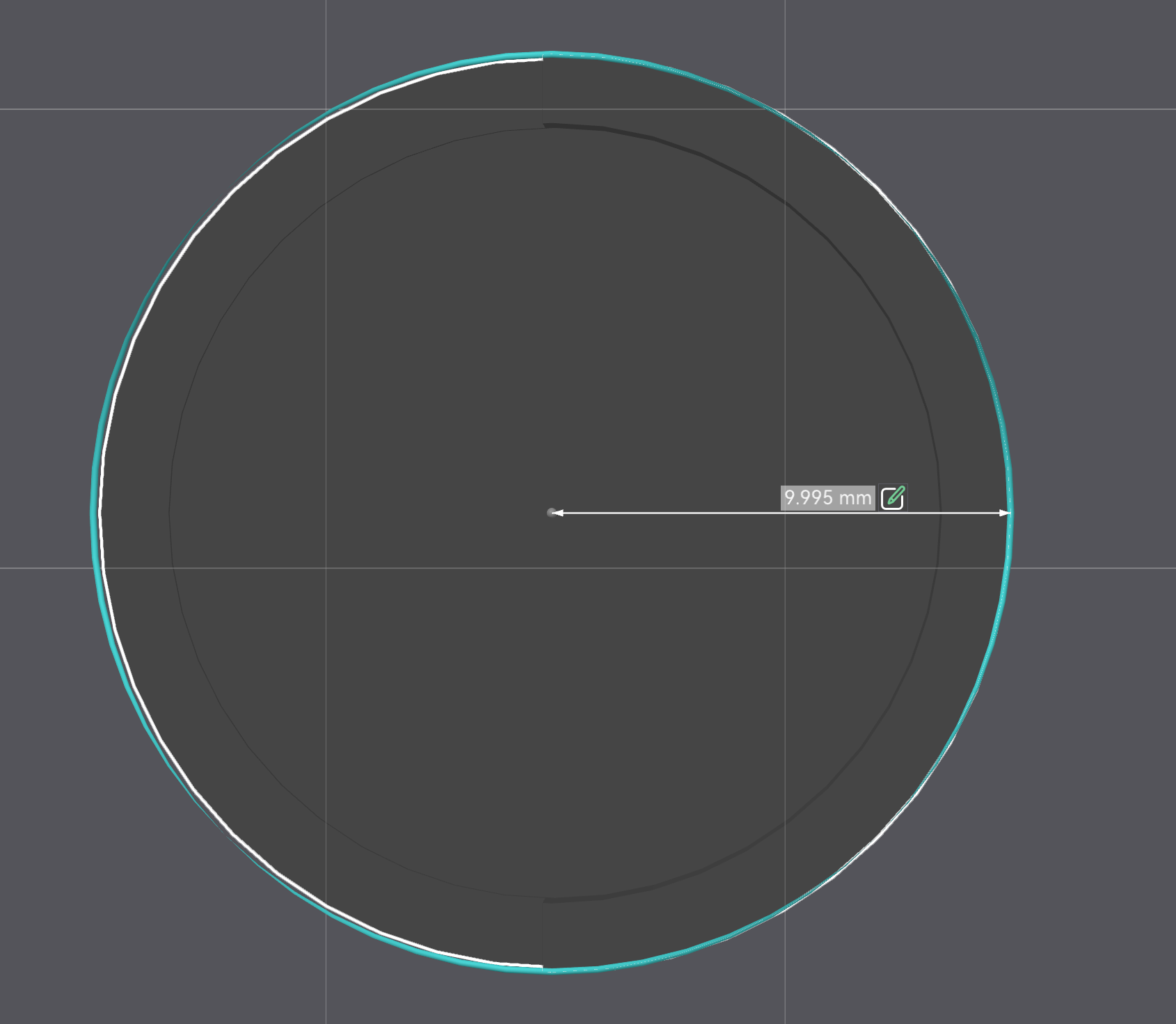

I’ve loaded a part I designed in Tinkercad. This item is 20mm across. When I load it into Bambu Studio, it shows exactly that, 20mm diameter. Then it prints out with a diameter of 25mm. I’ve tried re-saving the stl and reloading into a fresh instance of studio 3 times. It’s always wrong. Any ideas what’s going on? I have the correct printer selected (P2S).
I just tried another object with a 55mm diameter. It came out 60mm. Bambu Studio is adding 5mm to my prints and I can’t figure out why.

How are you measuring the print? If you using a caliper, double check that it is zero’d correctly as this has been the root cause for several others that had “part too big” issues.
The caliper is zeroed properly. The item is sized to fit into an object that is 17mm in diameter. The part that prints improperly is designed to slip over it. The problem is that when I print this part, it’s clearly too large. That’s the rubber meeting the road - the part is too big, fo’ sho’
The object in Slicer definitely shows the correct dimensions: 10 mm half-diameter - so 20 mm in total.

OK all, Jon was correct. I hereby admit I’m a dufus. The caliper was not zeroed out. It had a 5mm offset. THATS a mistake I will never make again. THANK YOU ALL for your help!!!
