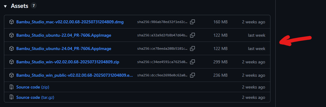

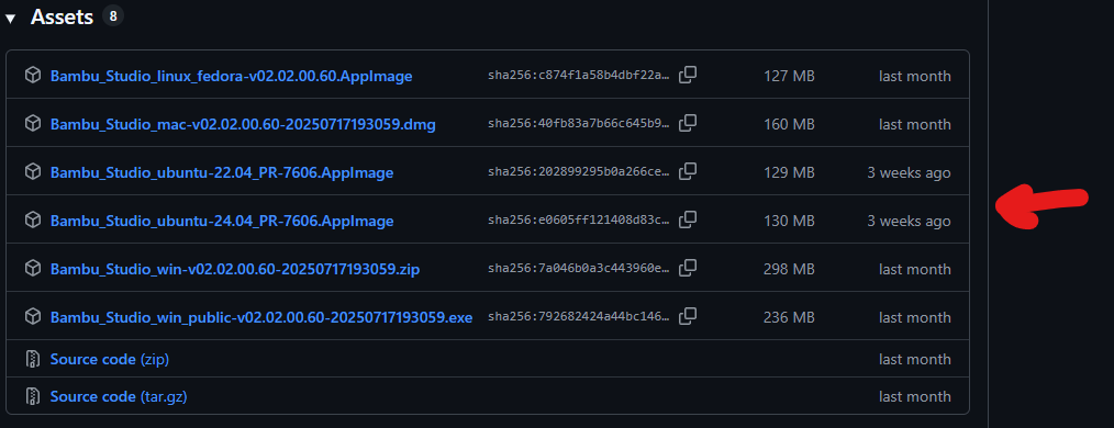

Where are Linux builds? These are missing from github release page.
Did you try here ?
On previous releases the Linux builds seem to release about a week later.
