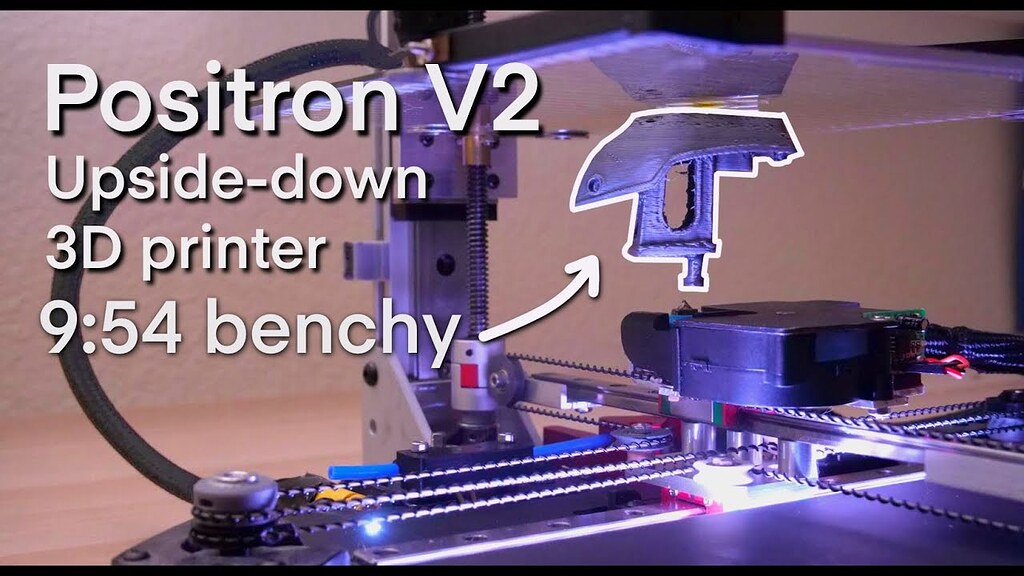

But were the belt printers extruding horizontally? Every print will extrude onto air instead of a bed. If that worked, we could quit worrying about overhangs and never need supports for our prints.
Sorry, I seriously doubt that this could work. (I actually thought you were joking.) If you must try it, just tip your printer over on a table and see what happens before you go to the trouble of mounting it on a wall.

And here an upside down conventional 3D printer :
