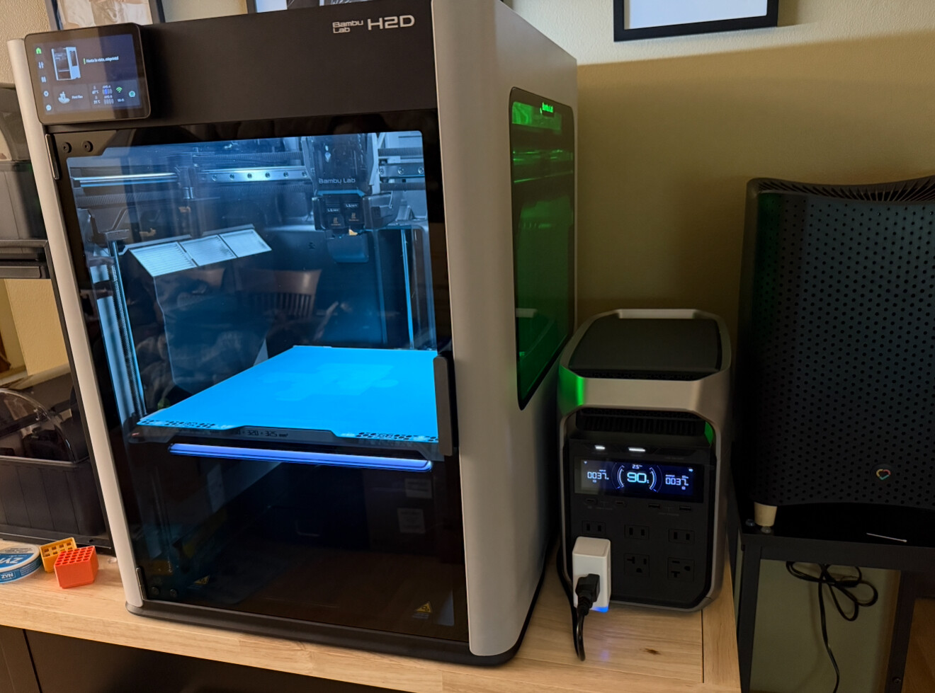

Just wanted to put some data out there. The EcoFlow delta 3 plus works perfectly as a UPS during printing operations of low temp filaments. I tested it during a PETG print. I have not yet tested it during high load operations like pre print warm up or during high temp filament printing when the chamber heater is on. I’ll try this out tomorrow night when I have some time.
The delta and the H2D didn’t even flinch when I unplugged the delta from grid power. After I plugged it back into grid power I then enabled grid bypass to test the power cut from grid that way. Same result, no issues.
First test, out of the 3 I can think of, passed. Fingers crossed the other 2 give the same results.
I ordered this Ecoflow the other day [delivers tomorrow] with the intention of using it as a UPS for my H2D. It can support constant 1800W and the H2D [here in the US at least] is limited to ~1500 watts or so IIRC due to 120v - so it should be able to handle the H2D no problem even at max power for ~45 minutes. Once fully warmed up and printing - it should be able to sustain it much longer.

I just picked up the EcoFlow Delta 3 Plus as well, seems to be working great! First low temp print is running now and tomorrow I’ll throw in some ASA and see how it does with the chamber heater and whatnot. Thanks for turning me on to this unit.

Nobody has verified it works with high heat filaments. I have read that Ecoflow can go into overload after 1500 watts.
I will verify it right now, it works just fine. The delta 3 plus is rated for 1800w continuous. My H2D pulls 1650w on occasion and usually 1550w during heat up. Not a single issue.
