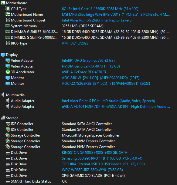

Sorry, I rarely use forums, I tried the latest 02.56 version and the previous 01.60, both had the same problem, here’s my PC config, lmk if anything else is needed
This isn’t exactly the same problem but give it a shot:
Yeah I don’t see anything that should give him issues. NVIDIA thing would be the only thing I could think of.

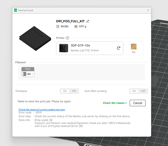

I’m using P1S, so I added a model in the currently working instance of BS, tried to print it but it came out with an error
after restarting I wasn’t been able to open BS again without it freezing and crashing yet, but I know if I keep trying it’ll open eventually.
Sending a print through handy works just fine tho.
Someone else with that same error (3010). I’m wondering if that outage from yesterday isn’t completely cleared up yet.

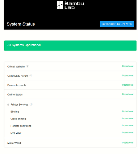

Based on this, the issue appears to be with your system’s connection to the Bambu Lab servers. We can be confident in this conclusion because you’ve verified that the printer’s connection to the cloud is working and that it can print successfully. This may seem like a small point, but it eliminates a major branch of unproductive troubleshooting.
Next, let’s confirm that your PC’s connection to the Internet is stable and that there are no service issues. Visit the status page at https://status.bambulab.com/ and make sure all indicators are green.
If everything looks normal, the next step is to temporarily disable your Windows Firewall and test again.
If the status page shows warnings, unfortunately you’ll need to wait until Bambu resolves the server-side issue on their end. There’s nothing you can do from your desktop to fix that. As a temporary workaround, you could connect your system through another network such as a VPN or your cell phone’s hotspot, but the goal should be to restore normal connectivity on your main network.
