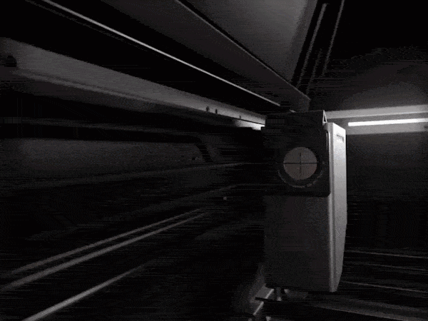

R1 aligns itself, no more tricky setups.
Aligning the optical path meant test shots, manual adjustments, trials and errors. R1’s Laser Alignment Sensor measures the beam, detects the misalignment, and automatically corrects the path in just 1 minute.

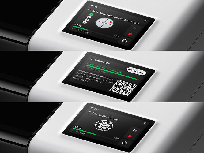

On the built-in touchscreen, you can follow the whole calibration process, check the remaining life of the laser tube and mirrors, and monitor every job in real time – the experience you know from our printers.

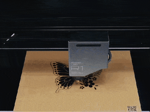

Every line, sharp and clean.
R1’s TriSense System work out three things before every cut: the positions of the material and design, the height of the surface, and how the toolhead moves across it. Cameras, lasers, and encoders work as one. What you mark is what you cut.

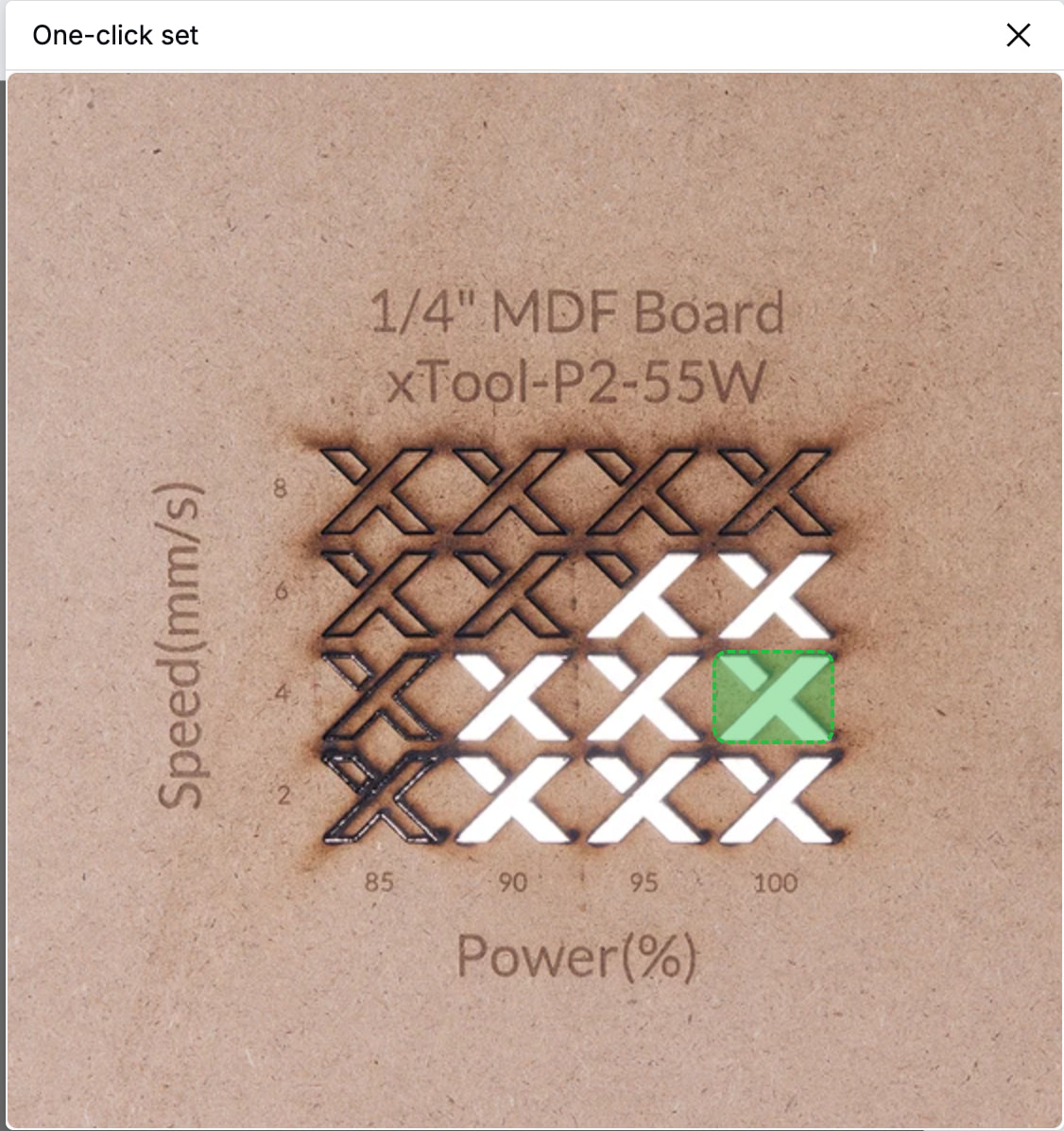

Just went over to Taobao and checked the Chinese language specs, same 30KPa. Either it’s an intern-moment or actually really just 30KPa. I don’t understand the decision, putting such a weak air pump in a 2026 laser. It’s not often talked about but the 200KPa air assist upgrade P2S got was pretty impactful in terms of cut quality and thickness capacity.
For example,
200KPa
150KPa
(note that where it applies is in even thicker sheets or harder to cut sheets, not that 6mm MDF is impossible to cut)

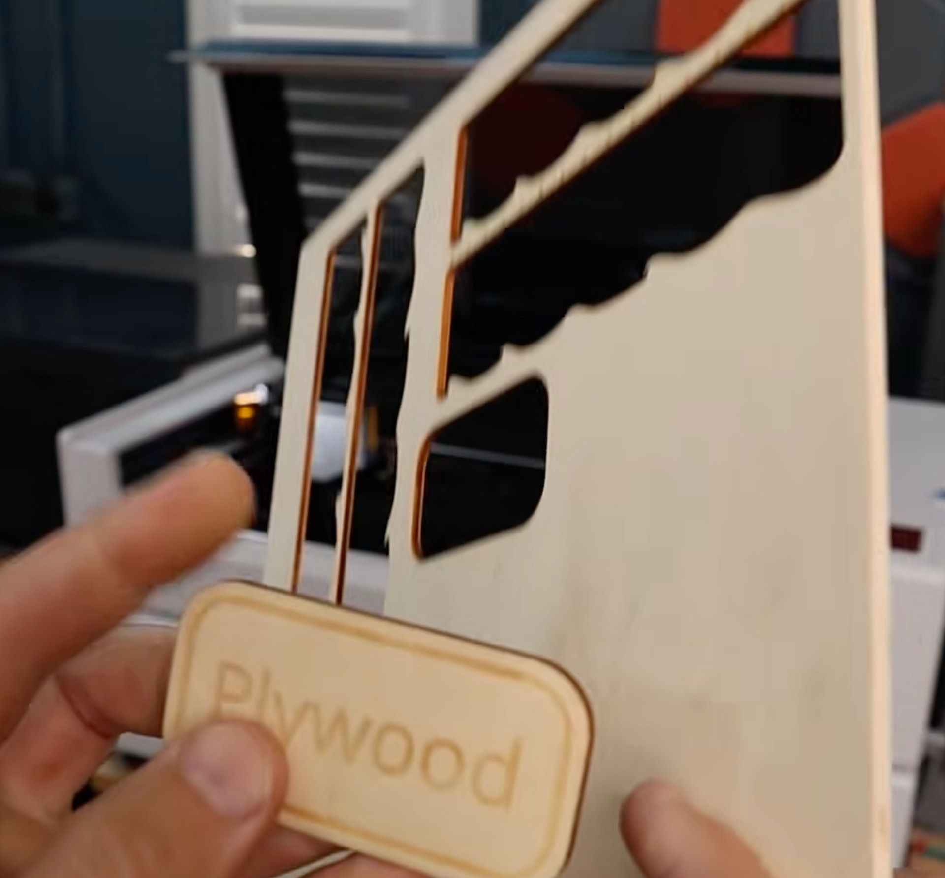

Realistically, what is the max wood thickness it can cut?
My main project uses 19.1mm poplar which I cut in a single (slow) pass and then sanded the edges. 12mm wood cuts much faster of course and 3mm plywood is super fast with noticeably less scorching. These are the ones I’ve tested so I can’t speak to other species/thicknesses.
