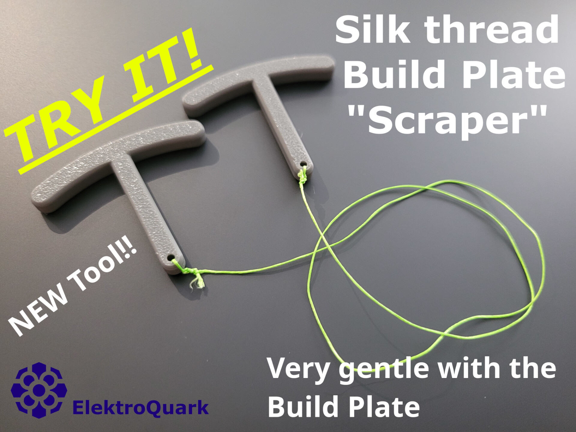

Try this (shameless self promotion, but it works very well):
