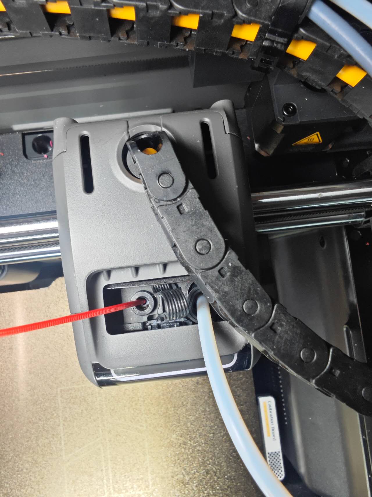

Broken PTFE connector part on main extruder
Hello everyone, I’m a new user.
a recent print broke my X2D.
seeking help and advice for how to fix. Any tips would be more than helpful:
(photos attached)

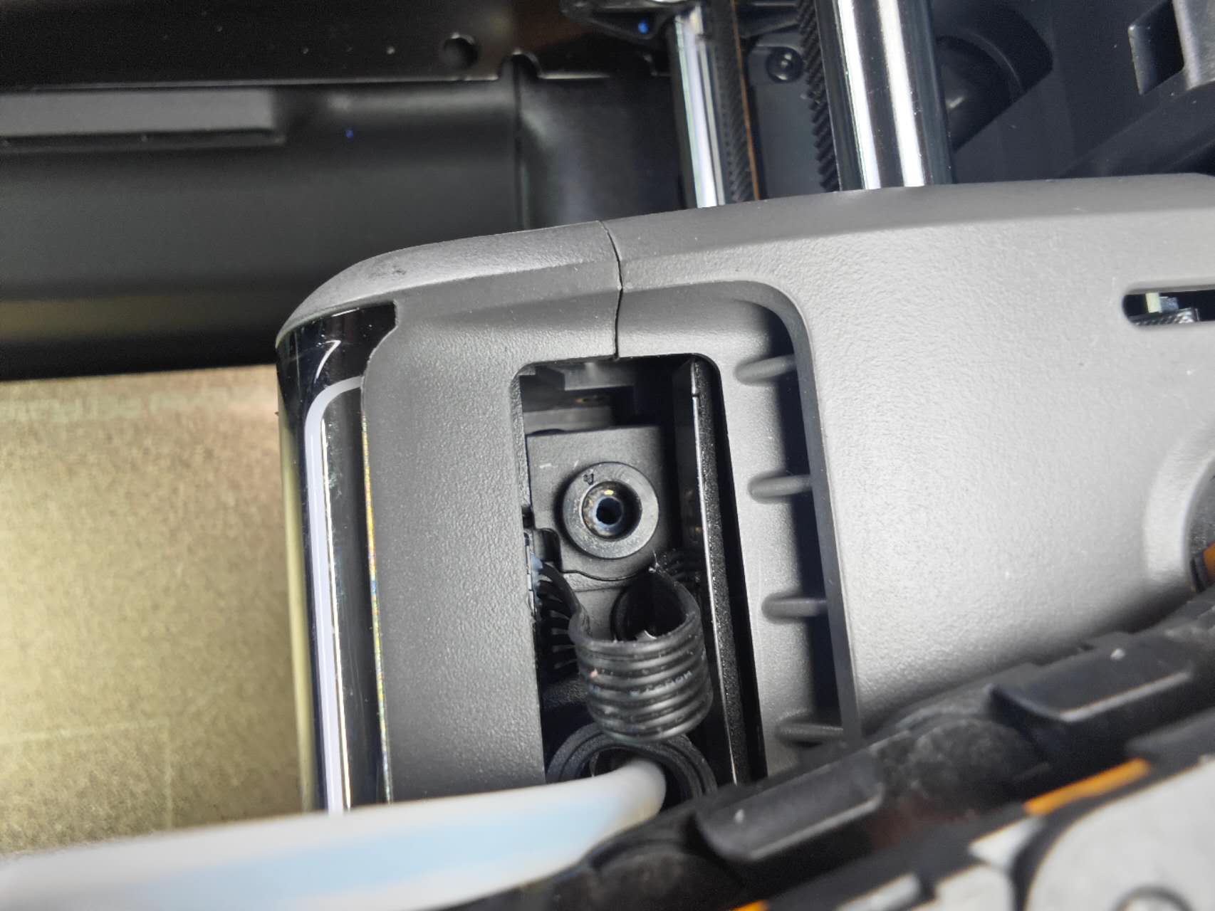

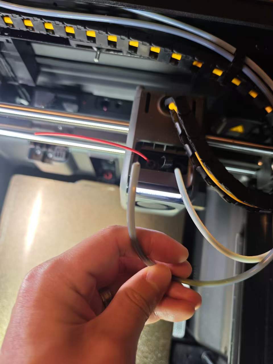

the PTFE tube snapped off, after unload the red fillament, looks like there is a small section of the PTFE tube still remaining in the hole on connection the exturder.
I could not take the remaining tube out.
Does anyone know how to fix it?
And how to avoid it in the future?

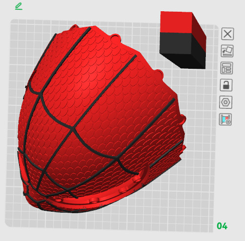

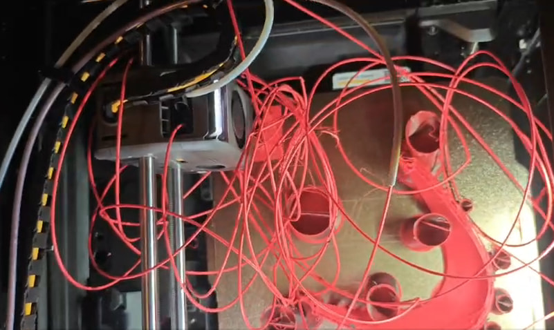

Is it because I pushed the prime tower onto the very corner of the build plate?
Thank you!
First, PTFE tubes don’t just snap off. It was either extraordinarily worn, or it has experienced severe bending.
Use a coarse threaded screw to grip the stub of the PTFE while pushing down on the black release ring, should be able to pull it out easily.

The teeth holding the ptfe tube seem to cut the tube and then a small bit gets left inside.
Contrary to what was said above, they do just snap off in the X2D and lots of us are experiencing it. My post on the other forum: Add reddit dot com at the beginning and go here: r/BambuLab/comments/1t5slvv/comment/pgmqdeh/?context=1&screen_view_count=2
It’s a bad design on the pneumatic collet. It bites all the way through the tube if you disconnect and reinsert the tube a few times (maintenance, clearing clogs, cold pulls), the internal teeth act like a pipe cutter, scoring and eventually breaking the PTFE. Unfortunately, Bambu’s sensor design doesn’t allow you to clear the chewed off PTFE easily, and they are treating the whole sensor as an consumable part when it’s not technically broken, just jammed.
In my opinion, they should use a better compression fitting like the one on the Aux side, and if they want to keep a quick disconnect feature, they should move if to a small sacrificial stub tube outside the toolhead, where if it breaks, we can easily clear it in 2 mins.
