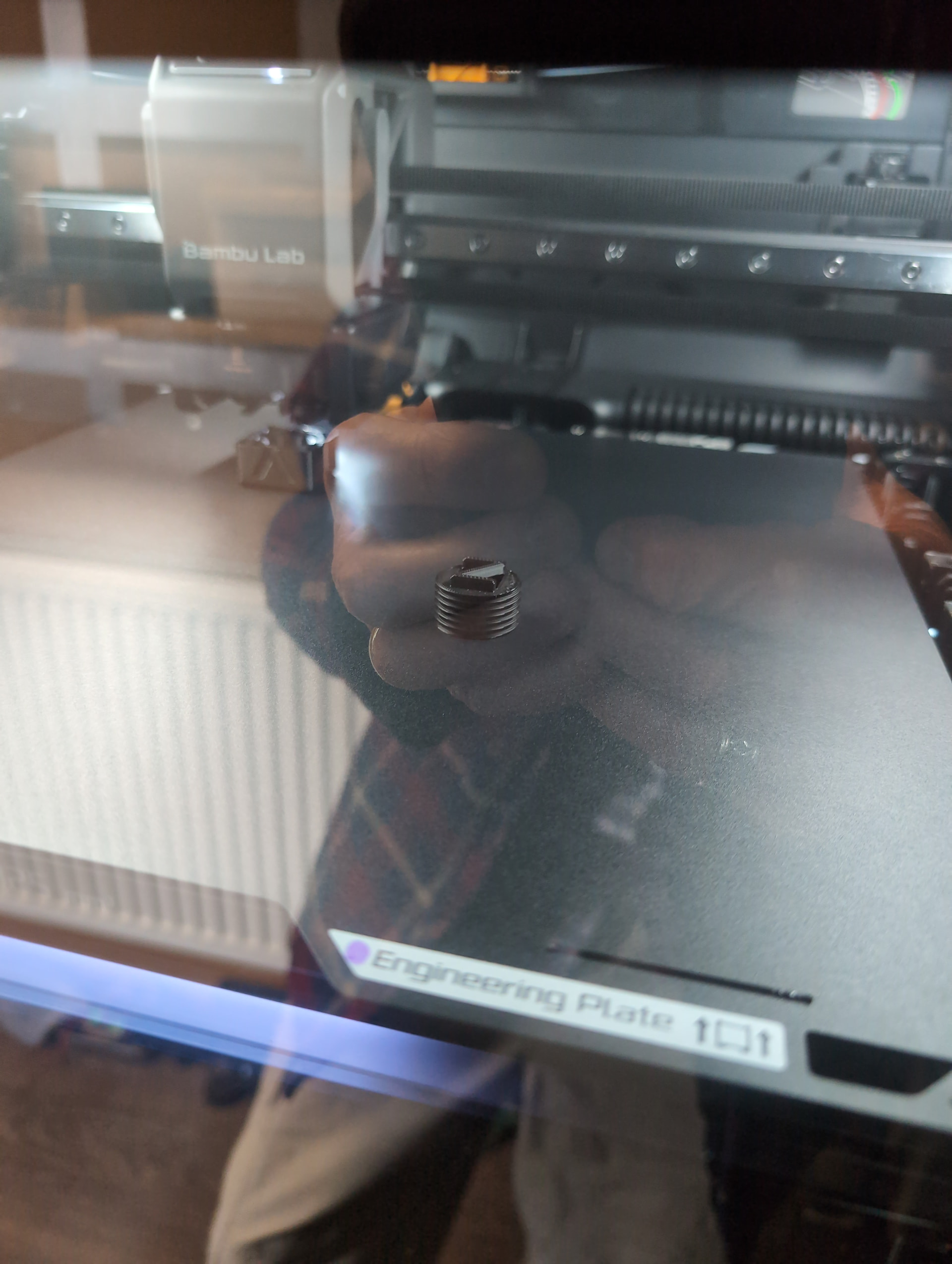

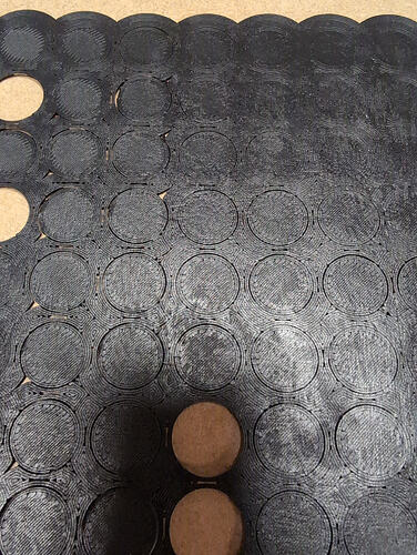

Cheap PLA No Glue, also used Tinmorry ASA without glue. Just let it cool and it slides off.
It’s not shiny smooth though! There is a very slight texture but it’s not really noticeable, unlike printing on glue.

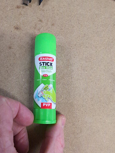

I did try glue (from Amazon) but I don’t seem to need it
Printing cheap PLA

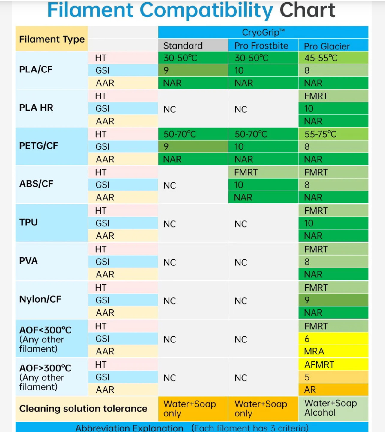

It’s not the same as the engineering plate. For example, it’s incompatible with filaments that print above 300° since they can bond with the surface. Also, unlike the Engineering plate, you do not need an adhesive separation layer for most filaments.
On my H2D and Core One I only use 2 plates now: CryoGrip for most materials and G10 for high temp materials. I own the engineering plate but find it just gets in the way. Especially since an adhesive layer is required and not an option.
You’re wrong, you can print on Glacier plate at temperatures over 300 degrees, see the table on the manufacturer’s website.
https://biqu.equipment/products/biqu-panda-buildplate-cryogrip-pro?variant=41446028935266
  • Broad Filament Compatibility — Works with PLA, PETG, ABS/CF, PA-CF, TPU, Nylon, PVA, and more (up to 300°C nozzle temp). Detailed grip strength index and brim recommendations included.
Also, will add that I printed PPS-CF on a Glacier at 330°, it bonded with the sheet and the sheet coating didn’t survive me removing the part. Fortunately I can get these sheets same day on Amazon. Contacted BIQU about this and they emailed me back that I should have paid attention to their specs (in a nice manner).
