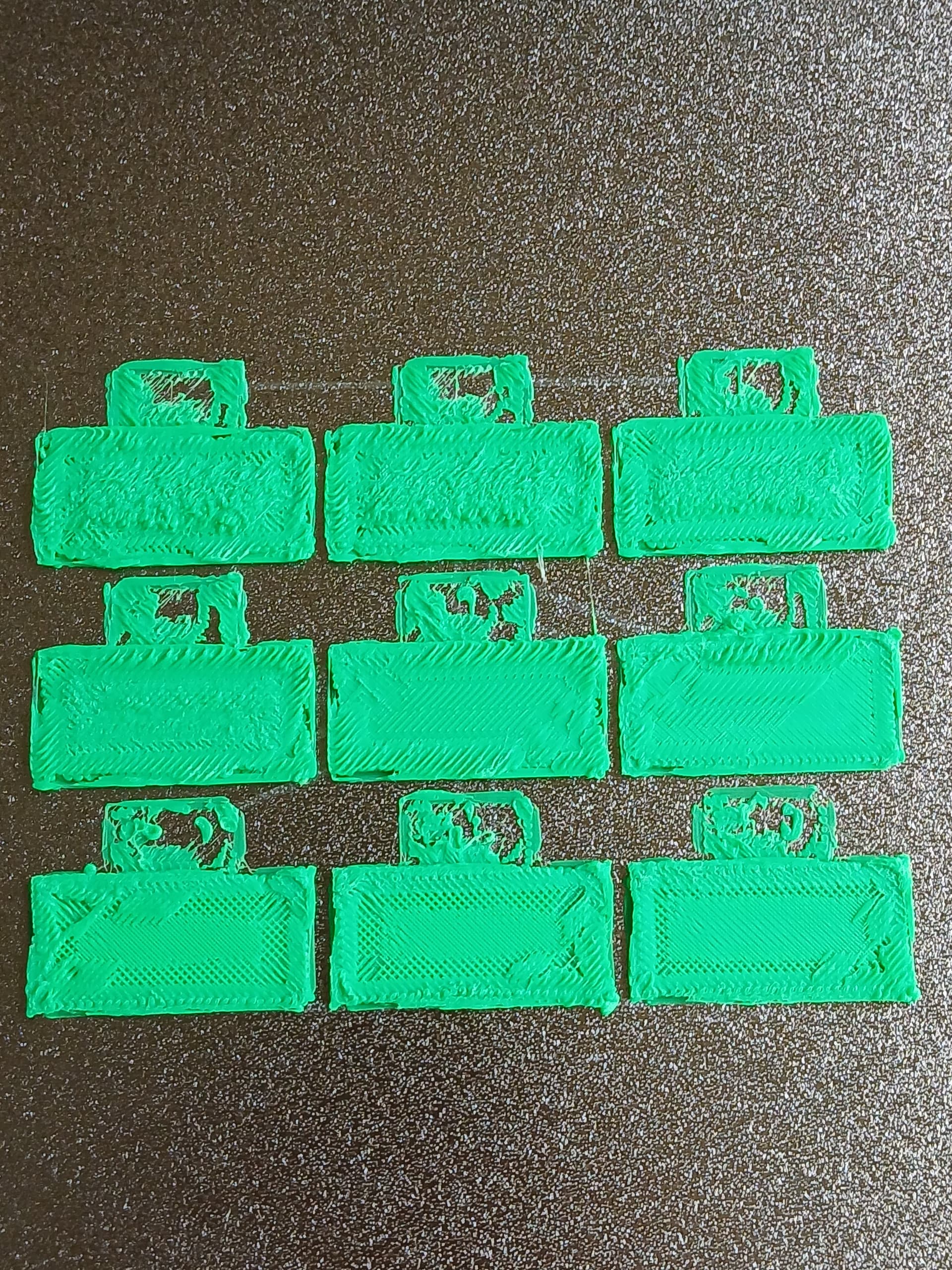

I’m not a complete noob to 3D printing, I had a Prusa Mk3 for years for work but I just got my P1S yesterday and set it up. I tried printing the benchy from built in memory twice and had to cancel both; complete fails. So I sliced one using more moderate settings and it was mostly successful. Today while trying to print some parts for a filament dryer everything looks like trash. The first layer looks very underextruded solid infill isn’t meeting outside and inside walls. This is all using the provided PLA Basic. I don’t have a dryer so it isn’t dried. It does not snap like spaghetti so it can’t be that wet.
I did the two built in calibrations and this is the results of the second.
I didn’t select any of them and abandoned this calibration since something is obviously badly wrong. I’d suspect a clog in the brand new nozzle but every calibration wipe at the front of the print plate is perfect with almost no line thickness change. Does anyone have any ideas on where I should begin?

I should add that this is printed with the top glass off and the front door open. My printer is in a cool basement with an ambient temp of about 68F (20C). Nozzle is set to 220C and bed is 65C for my failed benchy and dryer parts. Bed adhesion has been great so far despite the under extrusion.
I have never printed PLA with a bed temp of 65C. PLA Tg is 55-60C, you are well into the gooey phase. I print with the bed temp at 55C for PLA. Other things to verify:
  • the correct built plate is selected before slicing.
  • The correct filament is set in the printer extruder settings under Device tab of Bambu Studio.
  • correct nozzle selected for slicing
  • correct nozzle selected under Device settings
Thanks for the response. The correct filament was not selected in the printer extruder under the Devices tab. It is now and I’m reprinting. I had a peek in Bambu’s PLA settings and they’ve got it set up with 65C 1st layer and 65C all the rest on PEI. I can override it.
Selecting the correct filament on the external spool was the solution! Much appreciated! Here is the updated calibration print with just that change.
